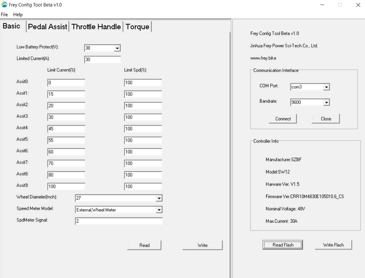

I've already done some customizations, the easiest was the "Limit Current %" on the "Basic" page. Here's a comparison:
Luna ApolloSmoothSmorg
Assit0:111
Assit1:301511
Assit2:352020
Assit3:403031
Assit4:454541
Assit5:555252
Assit6:606064
Assit7:707076
Assit8:808088
Assit9:100100100

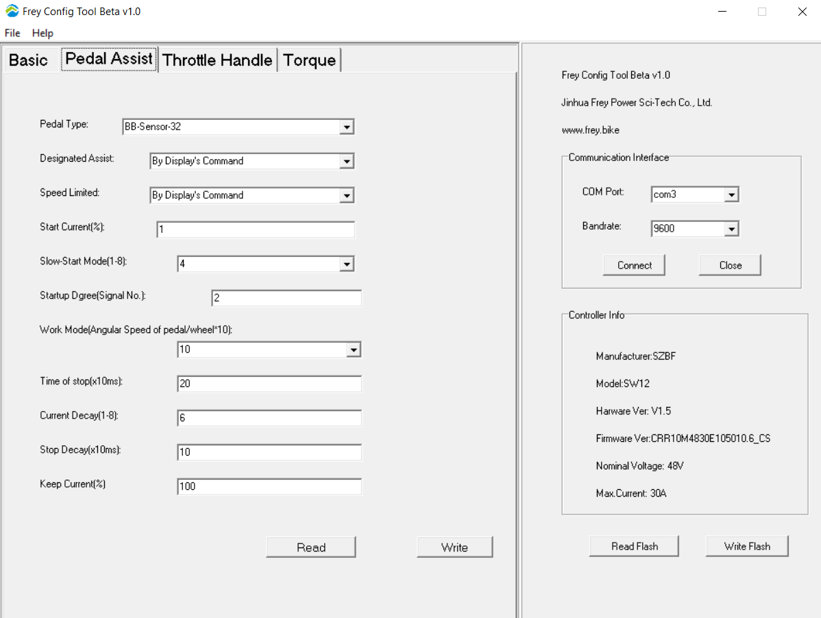

Also, I need to spend some time understanding the Smooth Torque page. Some differences from stock:
A) Start(Kg) is always 1 for all (wheel) speeds on Smooth, but is 20 at Spd0 for stock and decreases down to 6 at Spd100. I think this means you don't need to push as hard to get things going in Smooth, which could be a good thing.
B) Full(Kg) is pretty similar, with a larger range (60-15) on Smooth than Stock (50-25).
C) Return(Kg) is 0 across the board on Smooth and ranges 12-4 on Stock. I don't understand this.
D) Smooth drops MinCur% to 5 from 10 on Stock.
E) Smooth puts KeepCur% at 5 across the board, whereas Stock ranges from 4 to 2.
F) CurDecy is 4 across the board for Smooth, whereas Stock ranges from 3 to 2.
There are also major differences on Base Voltage and Delta Voltages, as well as getting rid of Stock's 120 setting for "0 Speed Boost Time" (it's 0).
Anyone know what differences I'd see on a non-Frey Ultra bike?

Here's the comparison of Frey to Luna:
DELTA VOLTAGE (MV)
SmoothLuna
0-5 Kg900200
5-10 Kg500200
10-15 Kg300200
15-20 Kg200200
20-30 Kg200400
30-40 Kg200400
40-50 Kg100400
50-60 Kg100400
So why do the "Smooth" setting start out high and go lower while the stock and other brand setting start low and go higher? I can understand why ramping might be smoother, but not why an opposite direction. And since the explanation for "Delta Voltage" is confusing I don't even know what the heck they're talking about.
