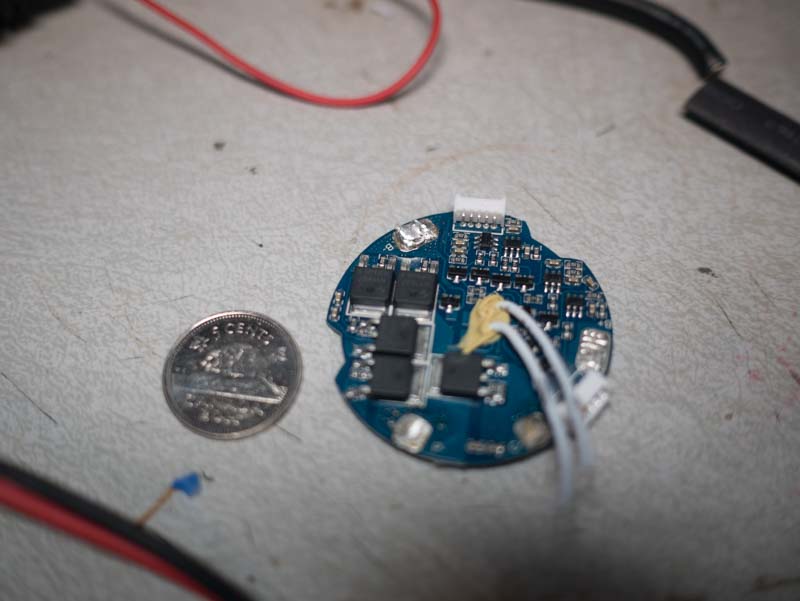

harryS
Most BMS work by shutting off charge as soon as any cell group hits a set point, usually 4.2 volts. A balance BMS will turn on a bleed circuit that burns off current with a resistor from this group. Then the other cells can catch up. You're wasting power by burning off the high groups, but you get it back from the charger.
Could someone design a system where the excess voltage is diverted to the lower cells? Sure, but without a charger, you're not gaining any extra energy. So you don't want self balancing at rest. It also would complicate the design. As long as you have "free" power with the charger, do it then,
By the way, many batteries don't have balance BMS. That isn't that bad, if you have good quality cells. I've been running a pack like that since 2017. Charged 83 times alone in 2020. No balance BMS, but it still gets to 41.8V (42.0 is ideal) fresh off the charger, which I believe indicate it's pretty much in balance.
How do you know if your battery will balance? If you use a current meter and see it pulling a trickle of current after charging, like .05A, that is about the balance current is. Of course, a leaky cell can do that too, In any case, I have put in balance BMS into batteries and that's what I see when charging.
Here's the original BMS in a UPP bottle battery, It's so tiny, there's no room for balance circuits.

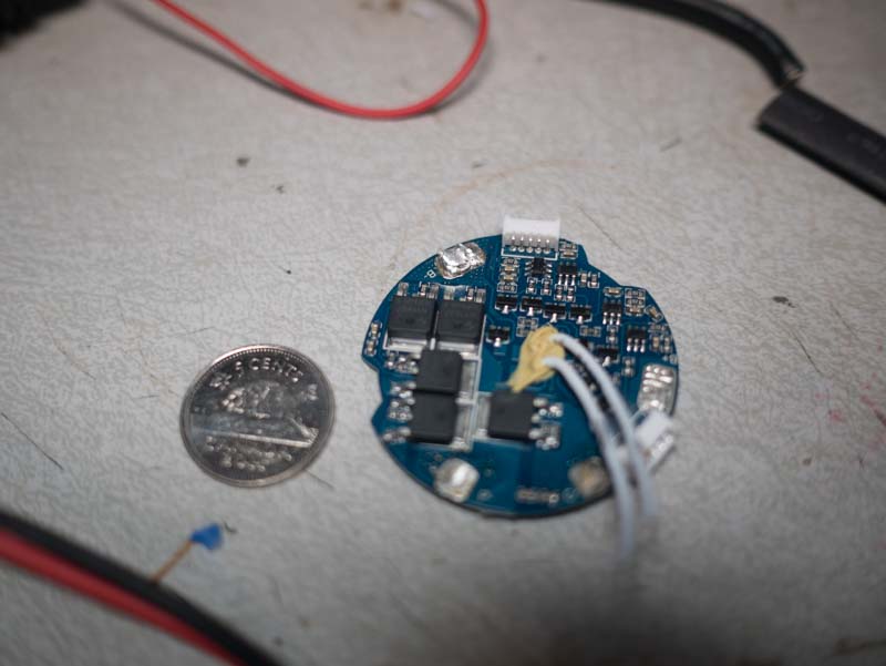

George S.
