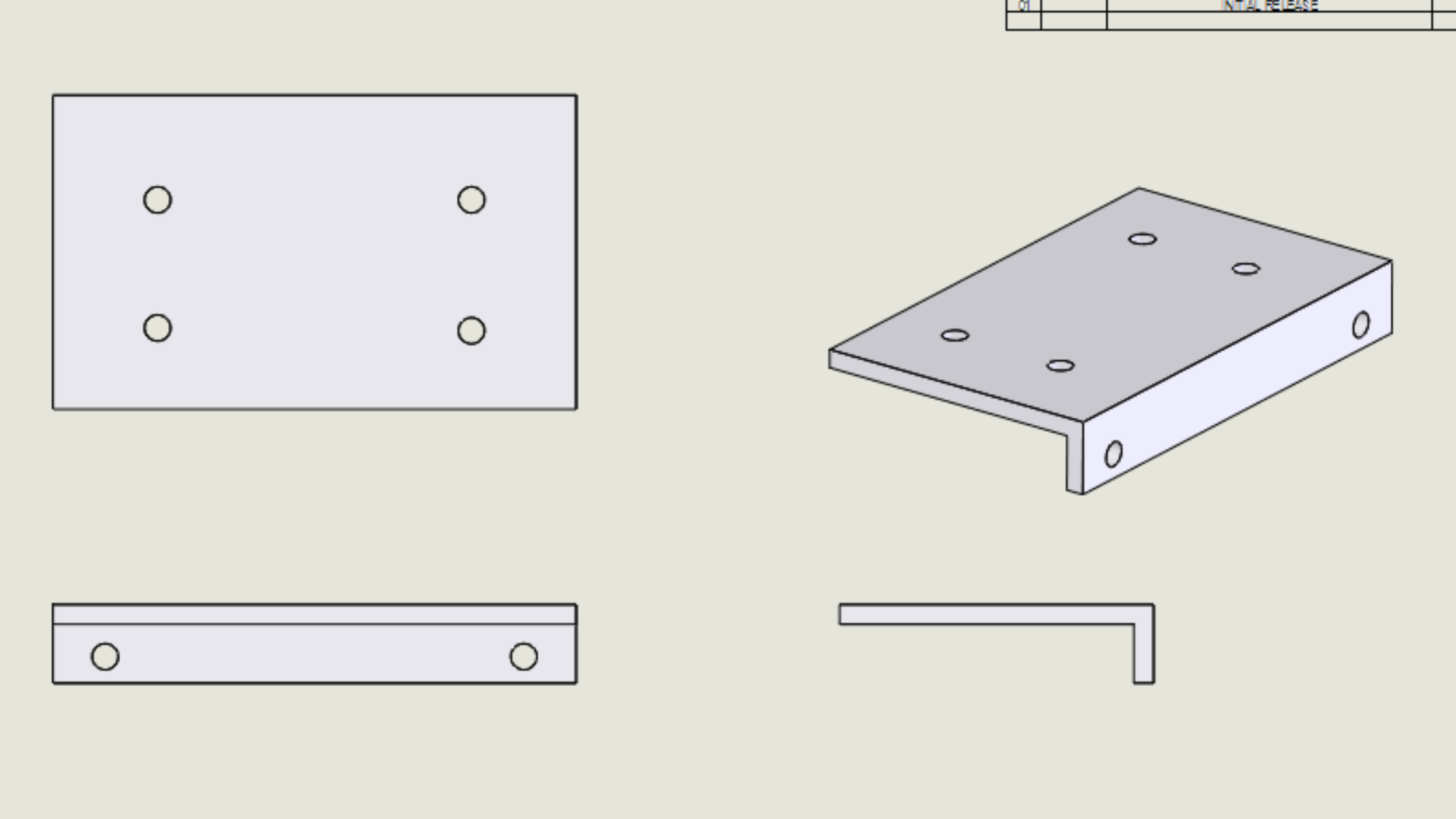

But I’m building a new bracket for the lights. This is the only thing (so far!) I have internally grumbled about. The bracket that comes with is a big spring board and the lights vibrate way too much. Here is a sketch to work with mechanical buddy that accepts wine as payment….🍷

Well the bouncy lights are fixed. Basically made a much thicker version of the sheet metal bracket that came with….
