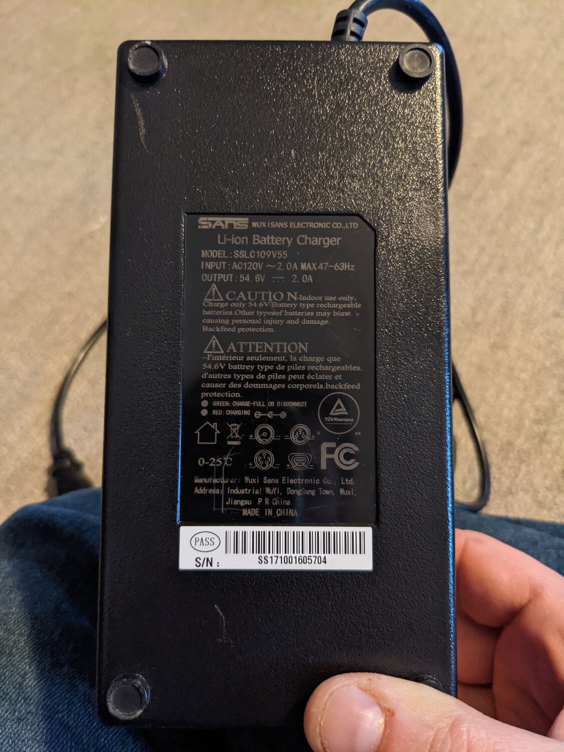

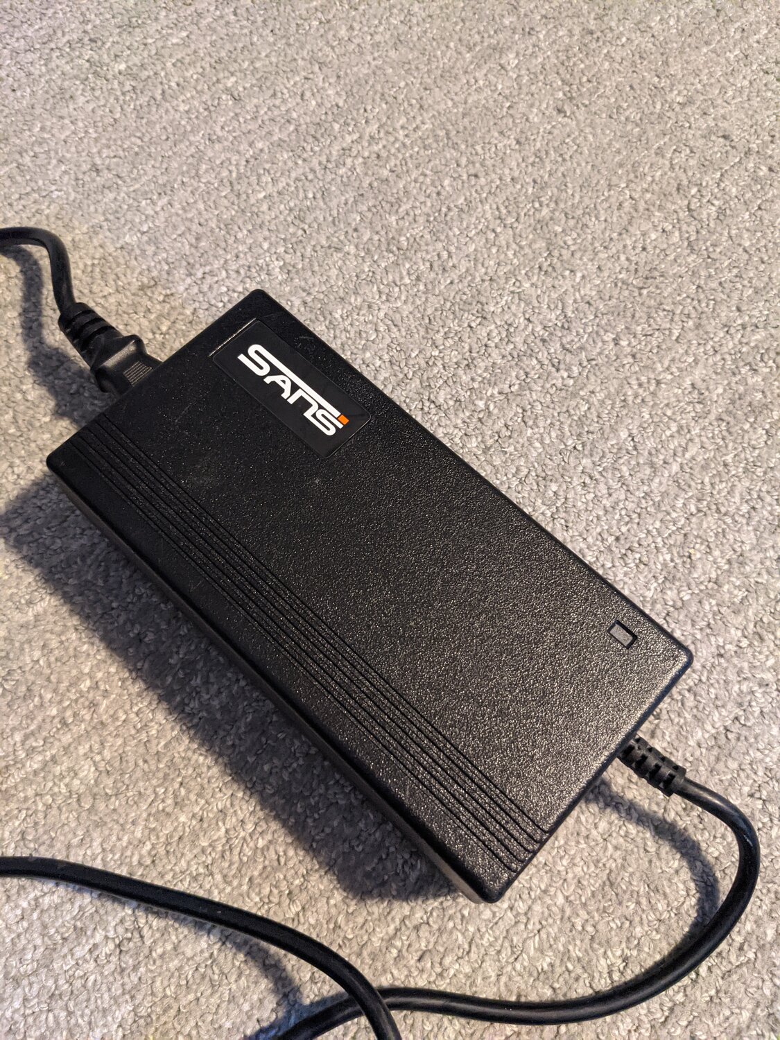

Have you tested the charger output when not connected to the battery? That should be 54.6v
stevet2233
hhmm so not getting a stable reading off the charger at all when it is plugged into the wall and never even approaching 54.6v, jumping between 5v-28v, so maybe my charger is junk?

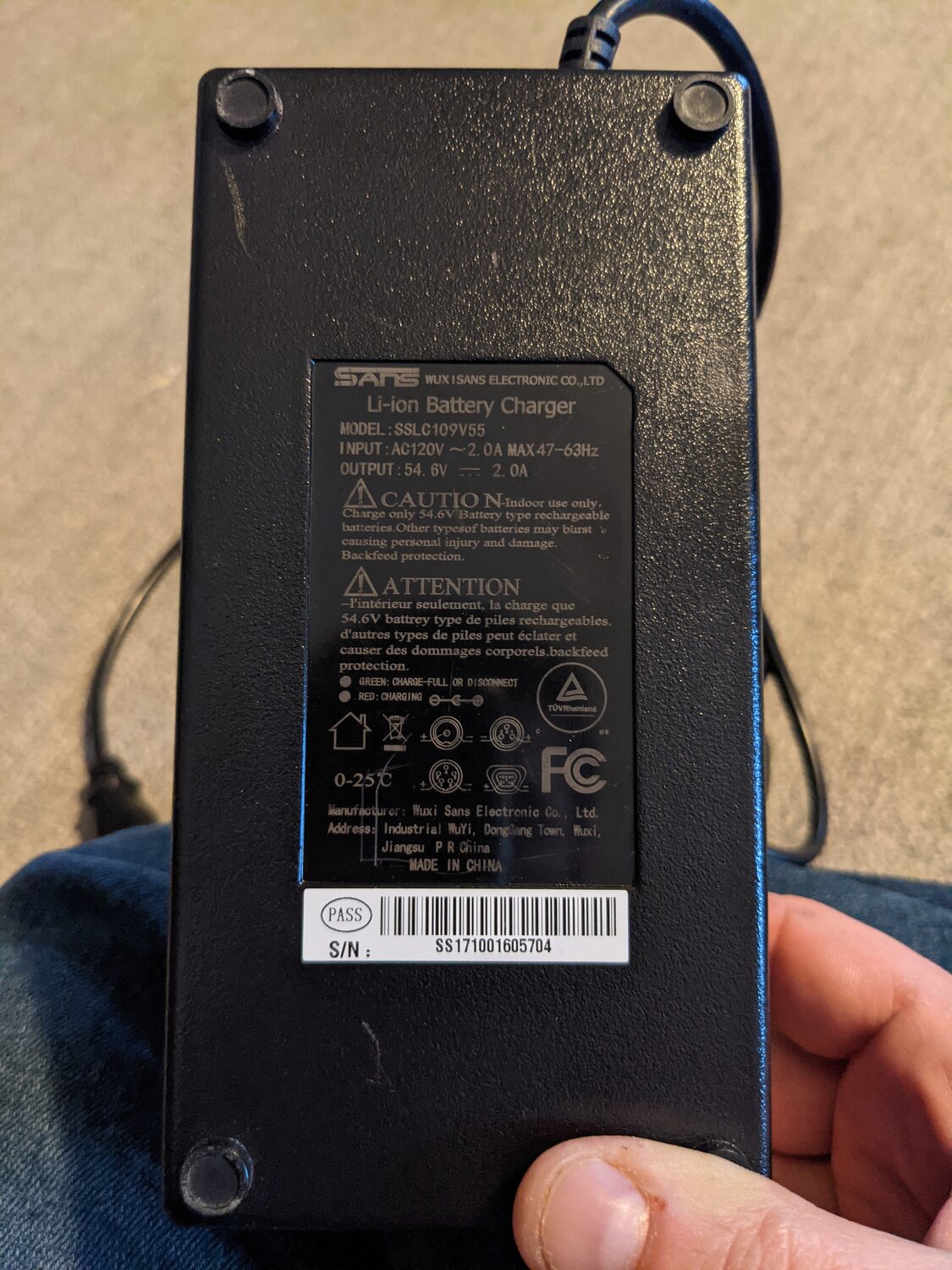

Not necessarily. Some chargers pulse a voltage as you say to wake up the bms... These are harder to measure the output voltage as they need to be connecter to a load. Full charge voltage of a nominal 48v battery is 54.6v.
Toms question can help with us having more info... Maybe a pic of the battery as well.
Have you tried leaving the battery attached to the charger for a few hours after the light turns green. If you do this, just keep an eye on it and make sure nothing is getting too warm.

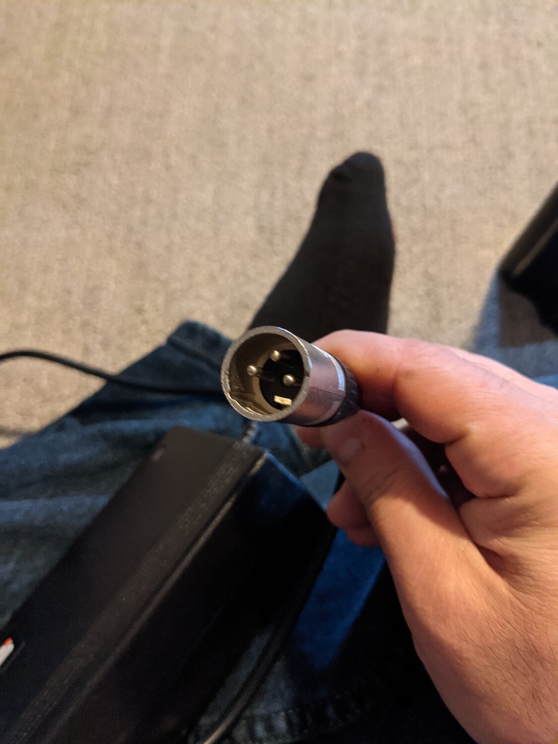

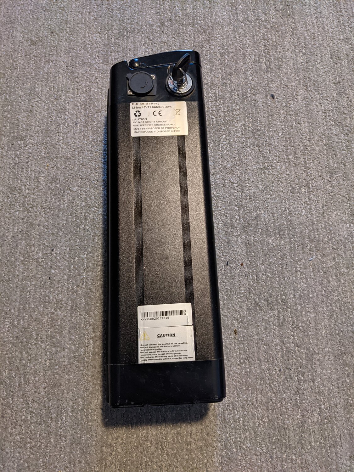

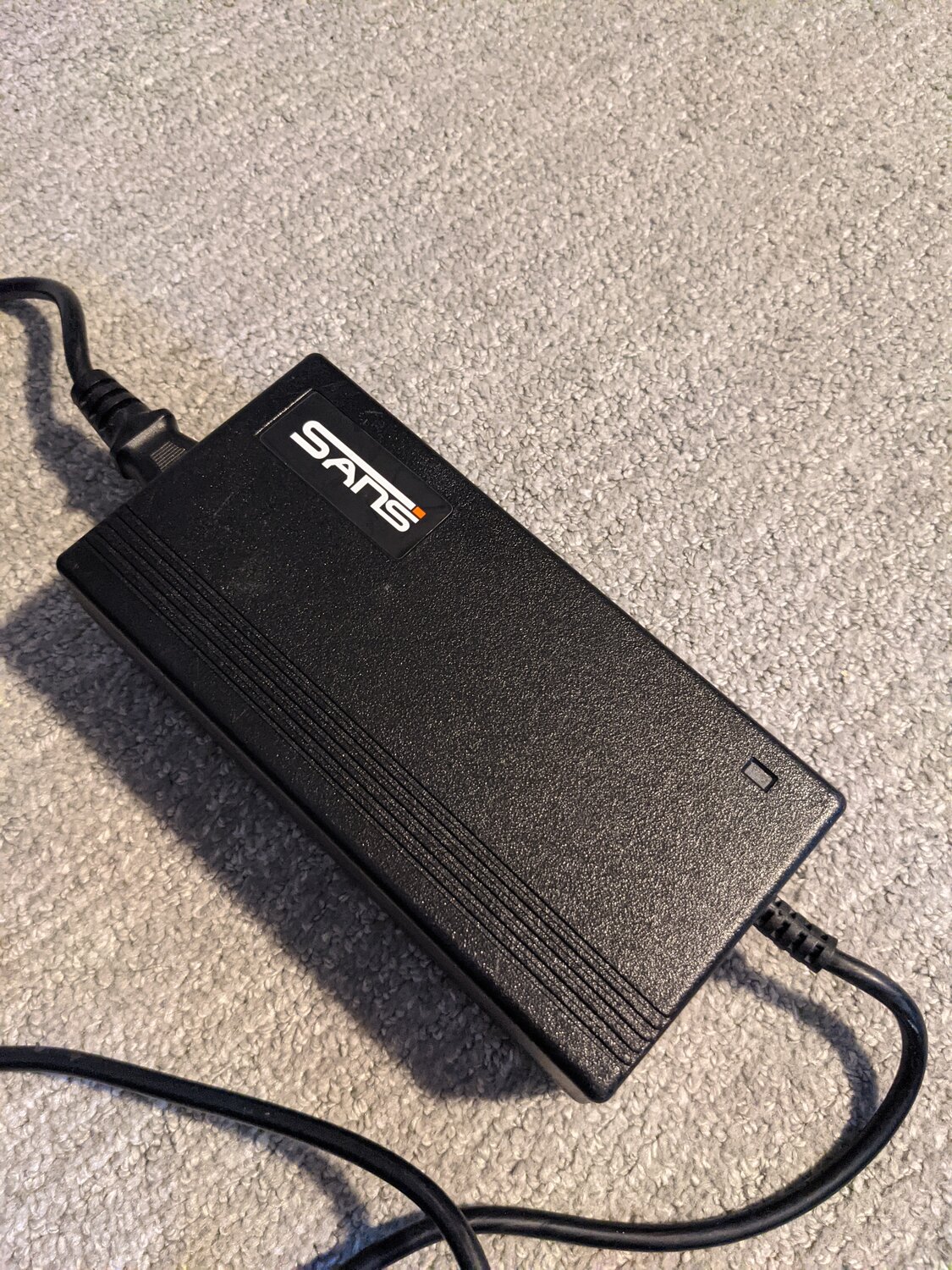

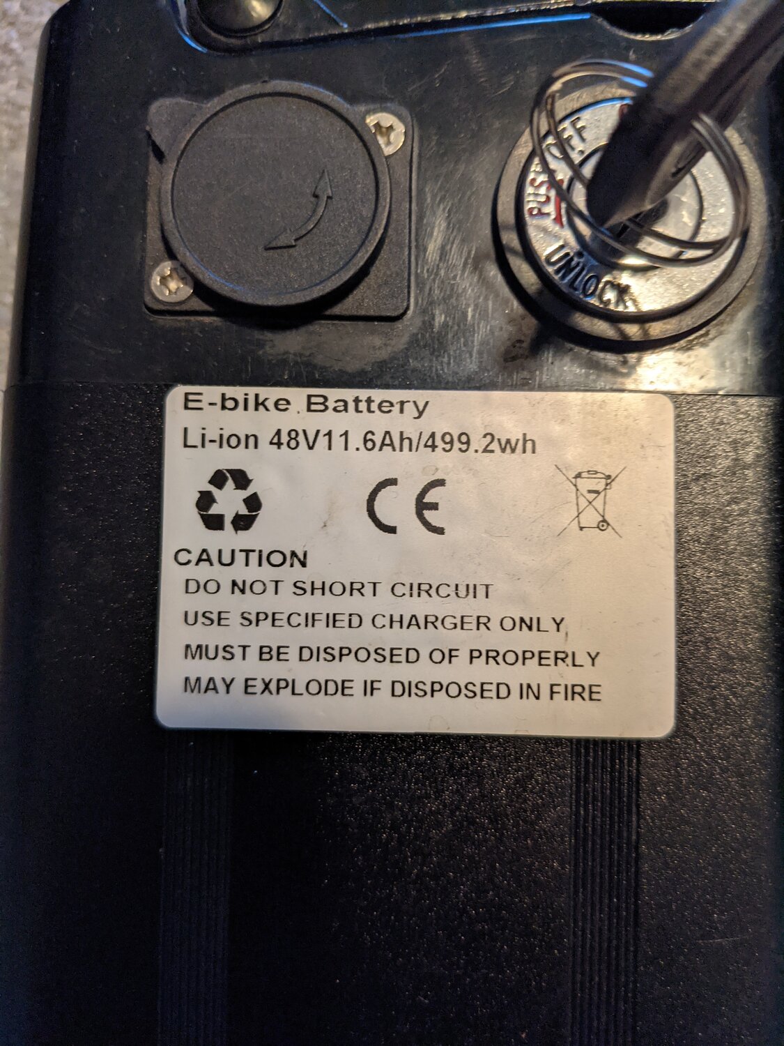

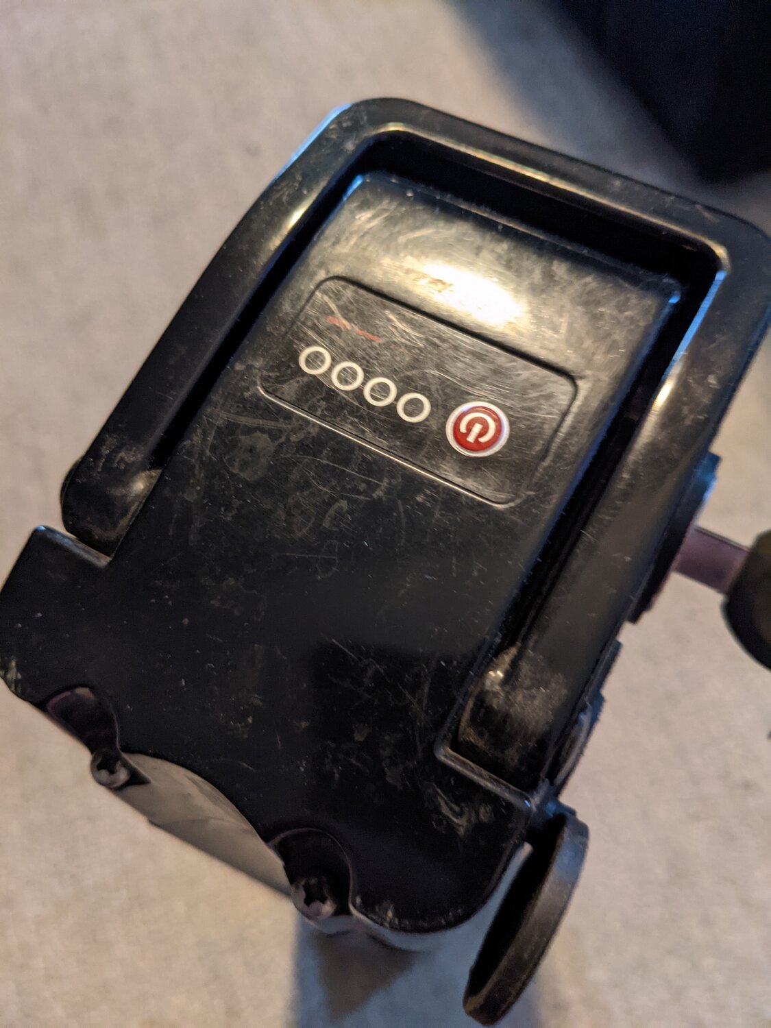

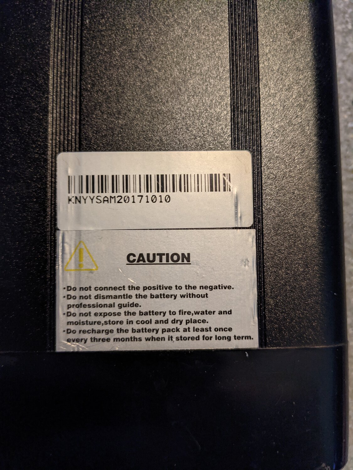

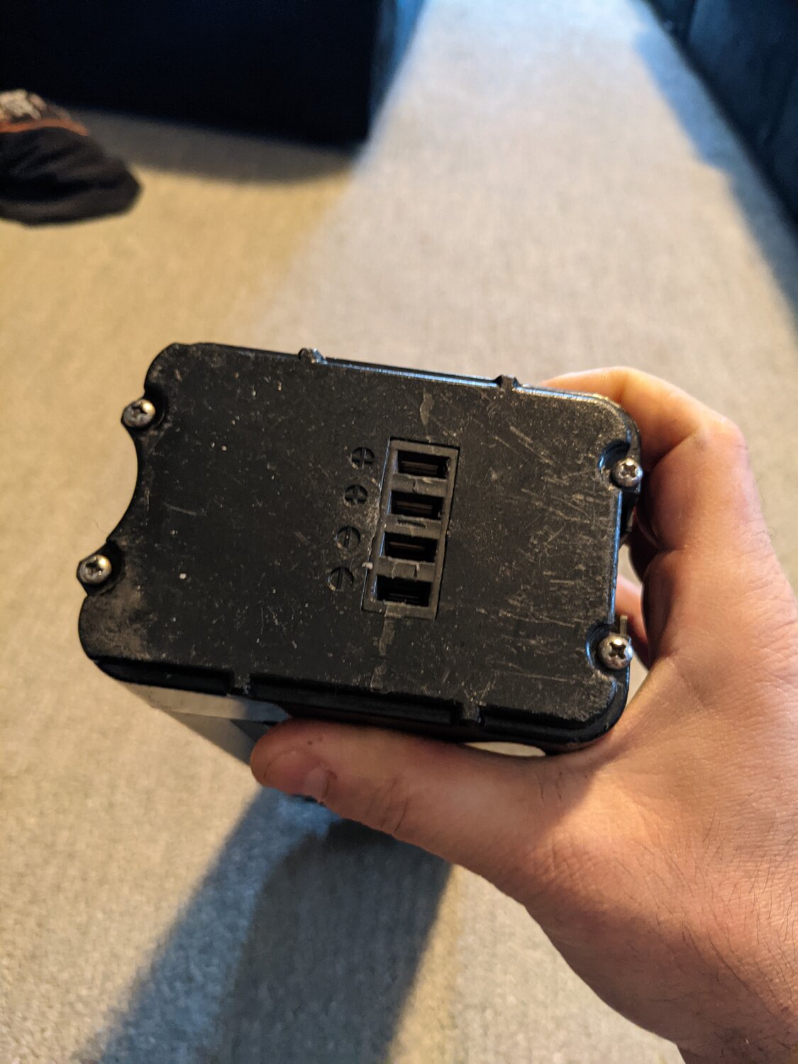

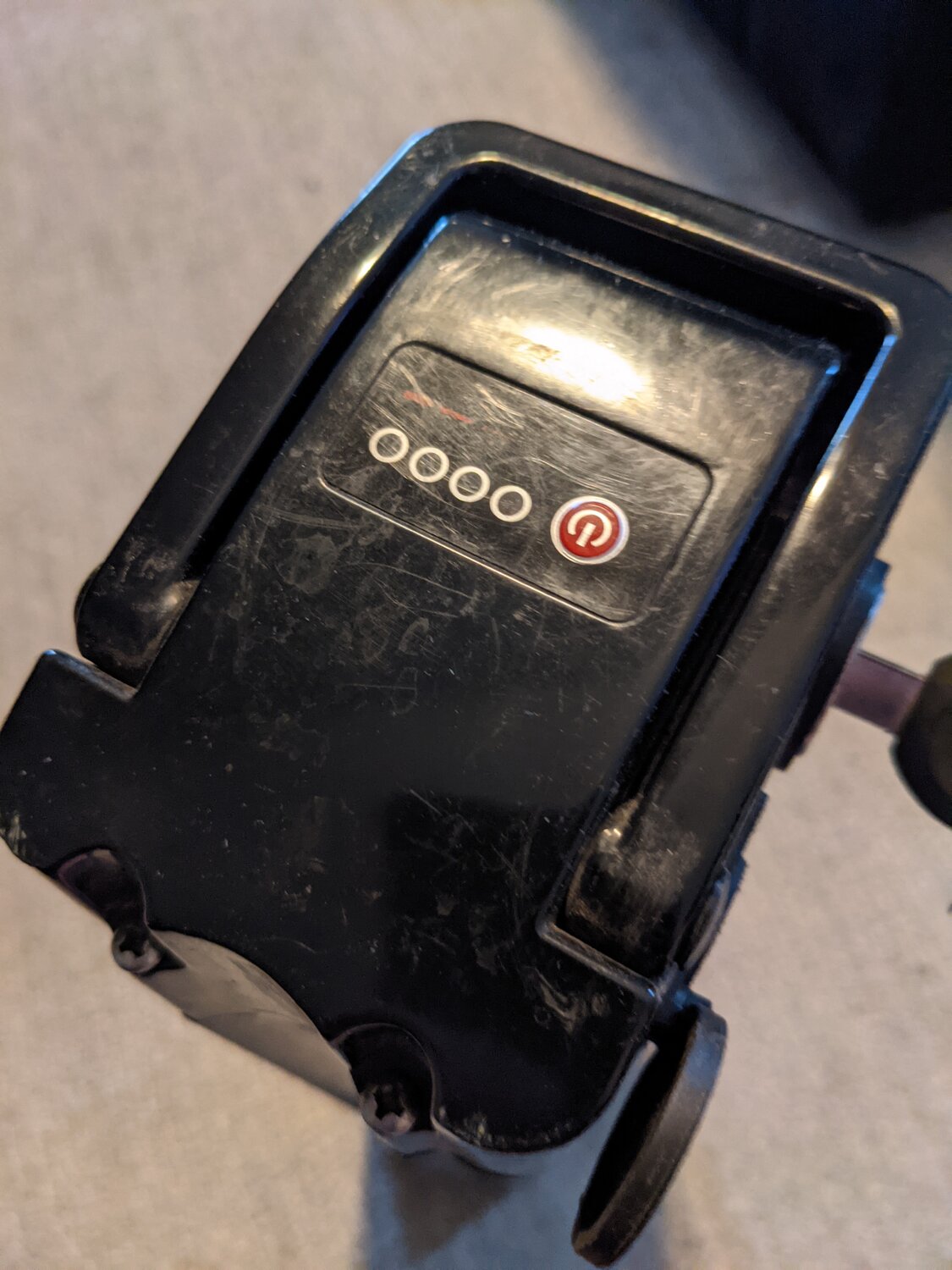

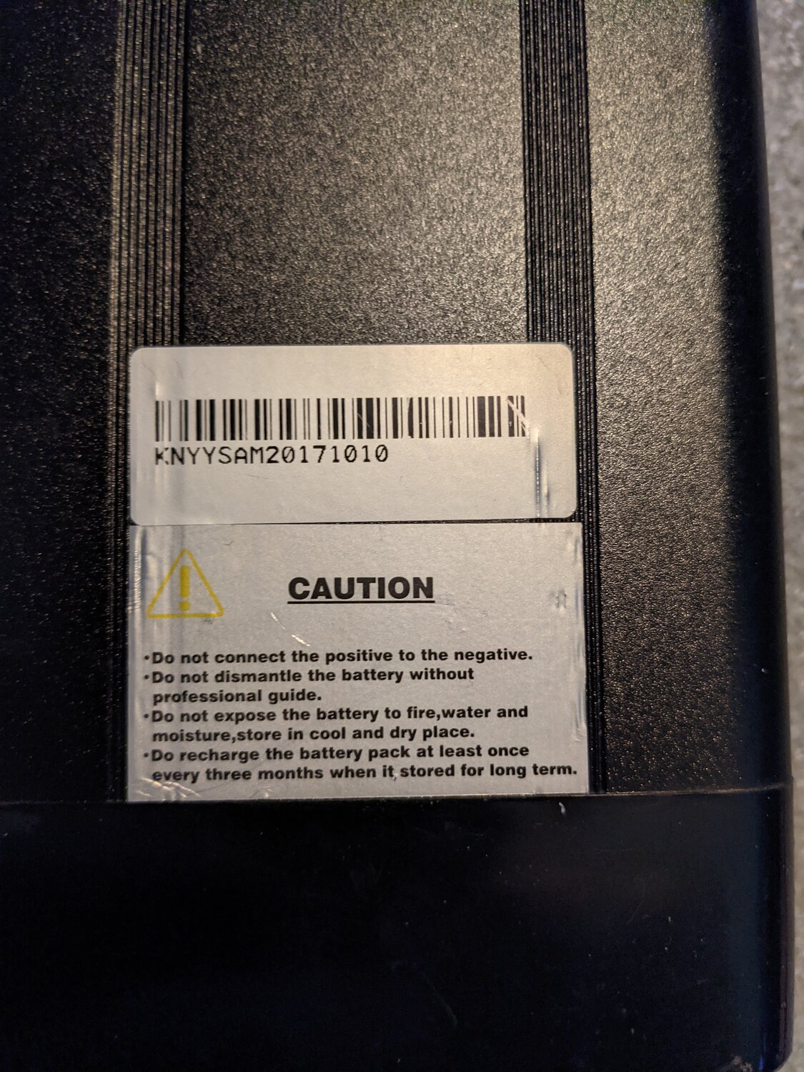

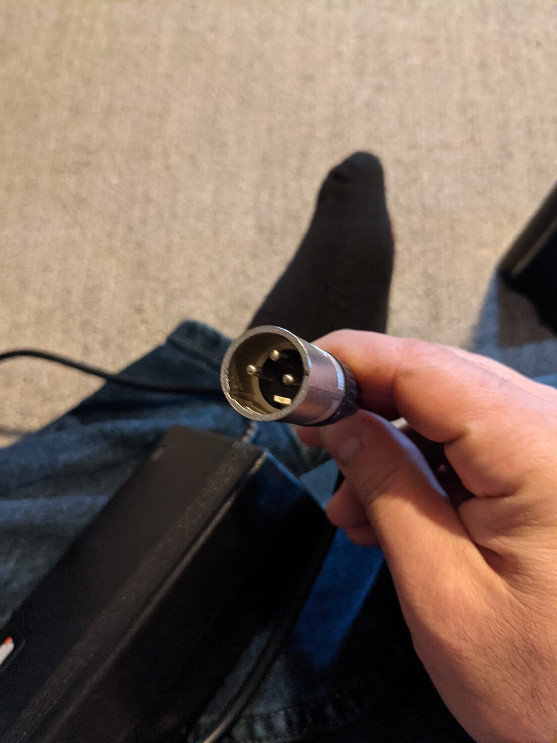

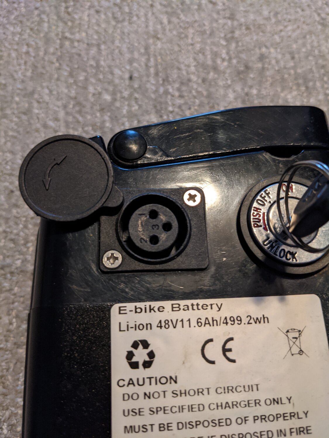

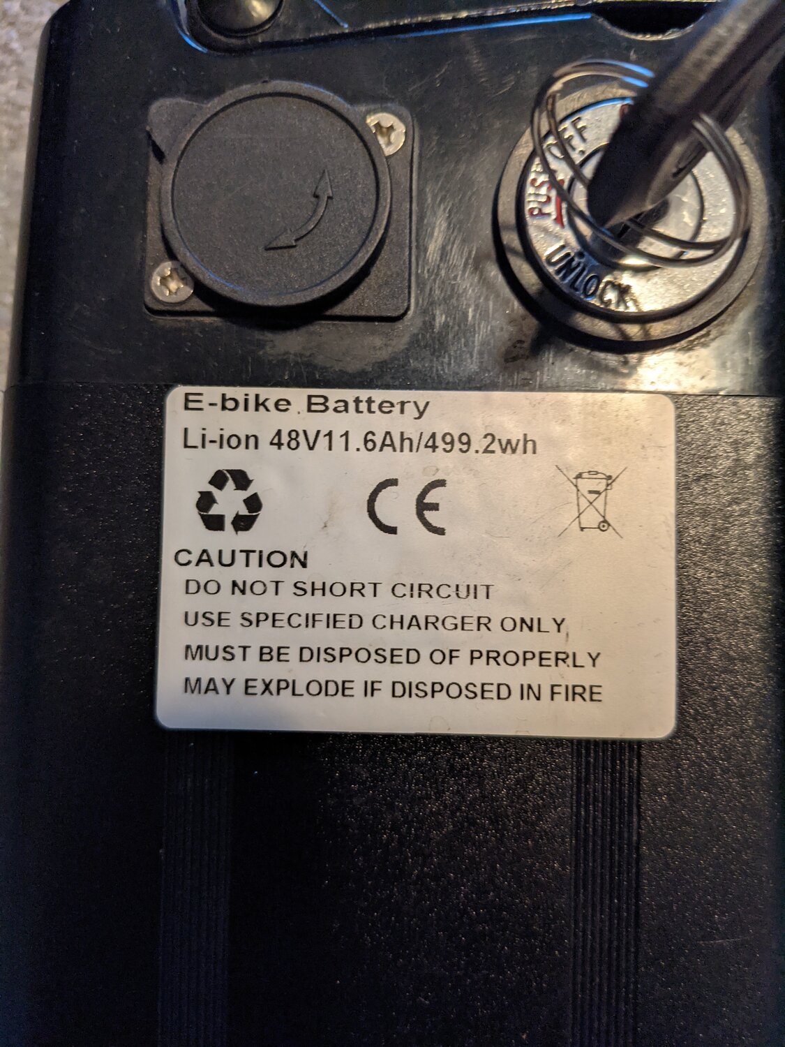

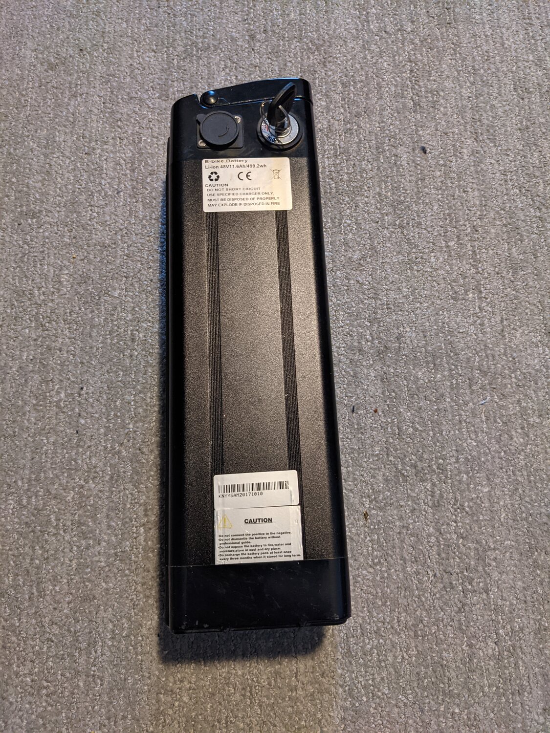

Alright, so here's the full backstory:
I bought a bike built by some enthusiasts who enjoyed building/selling e-bikes, the battery came with this, so I do not have much history on it beyond what i can see. First frost 2019 it didnt seem icy at my place, but on my commute to work there was some slick paint in the city and the bike slipped out from under me and landed directly where the cable came out of the hub motor and sliced right through it right where the cable came out of the motor, so no possible way to fix it. Before i got around to actually fixing it i broke my ankle and this was the furthest thing from my mind for a while.
This entire downtime the battery was stored in an open climate controlled room at room temperature, it really should have been ideal storage conditions, but it is at this point where i believe the battery was plugged in for an extended period, potentially a few months.
When i finally got back to this we were already in the pandemic and I couldn't for the life of me figure out what motor it was to replace it. The guys i bought it from weren't sure which specific one mine was to help replace it either, but helped point me to a new one that should have at least been compatible with the battery, and they thought the controller as well. I got that but it just didnt seem like the wiring of the new motor could be paired with the old controller, after many hours and much frustration i gave in and just bought a full ebike kit of bafang hardware that was all prematched. Hooked it all up, tested everything with the bike on the stand and all seemed great, but never tried it with load indoors for obvious reasons.
Today i took it outside, powered it up and it was dead by the end of my driveway :'(
So any ideas why there is the difference in readings between the charger port on the battery and where it connects to the bike? Getting 52.6 at the connecter and 47.2 at the charging port.
PXL_20210418_222056028.jpgPXL_20210418_222102491.jpgPXL_20210418_222106379.jpgPXL_20210418_222129776.jpgPXL_20210418_222139635.jpgPXL_20210418_222150839.MP.jpgPXL_20210418_222209037.jpgPXL_20210418_222254900.jpgPXL_20210418_222325000.jpg
View attachment 85127View attachment 85128View attachment 85129View attachment 85130View attachment 85131View attachment 85132View attachment 85133View attachment 85134View attachment 85135
The difference in voltage between the charger port and the discharge port both on the battery leads me to think it's the bms... If so, this might be preventing a proper charge.
If you feel that you are experienced enough to open up the battery and test each group of cells and then plug in the charger and see if the BMS is outputting to all groups. This will give you some insight on the cells, bms and charger.
You must be very careful not to short circuit anything and if you are unsure... Take it to a professional.
I can't think of another way to test that charger other than wiring in a voltage/watt meter between the charger lead and the battery.
You could buy another inexpensive charger as a test as well.
I'd also take a very close look at the Discharge port on both the battery and the bike that all the pins are equally shiny and clean as this is the most common battery problem.
I say wait a day or so and let's see if someone else chimes in with some ideas as well. Maybe there's some easier test that can be done.
