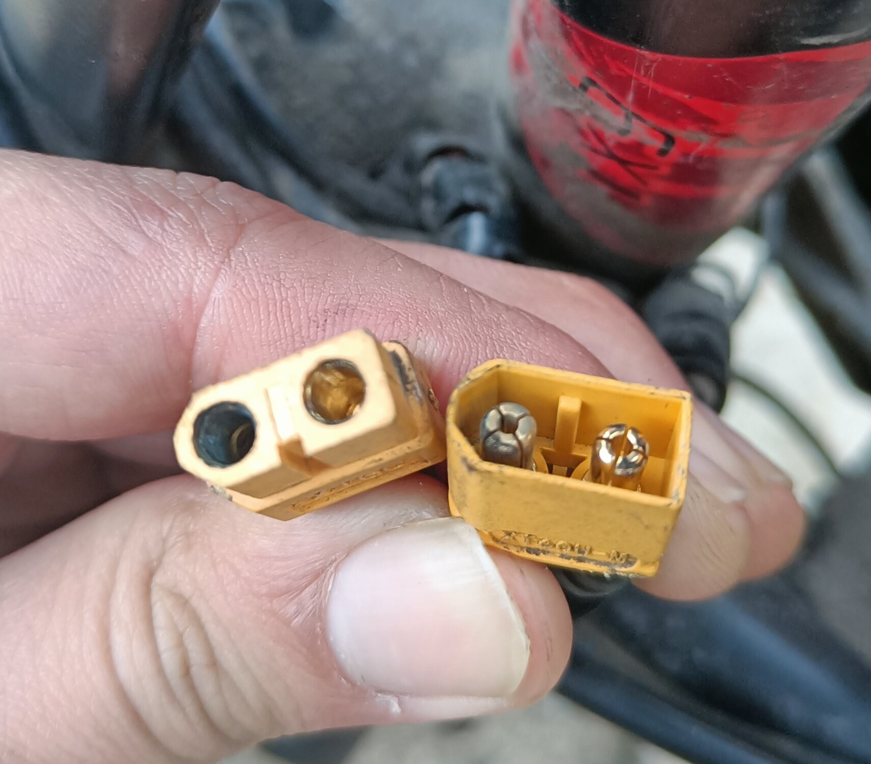

Here is a picture of the connector, one of the female socket is black.

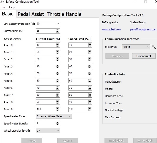

One more thing is that the "bafang configuration tool" doesn't recognize the controller anymore, cant read or write after connecting to the right port.

I have both a 48v and 52v battery I switch between with a Bafang Ultra that uses the same cable/template and only change the voltage via the display and it works just fine and voltage reads right with either. Not sure why you had to disconnect the battery a few times or what caused your problem but if your display lights up it is a controller issue, not the XT connector.

I say your controller is the issue with the display working but with an error and it not being able to talk to the pc software anymore.
If you have the original 48v firmware... Try to flash that back on to it... You may get lucky.

Just did a quick check... 30H is a Communication Error.
So there is some chance your firmware is corrupt. So again I'd try and flash the stock firmware back and pray 🙏

I'll add your xt60's are not in good shape and have carbon build up from arcing.
If they're not pitted... You can try a little contact cleaner. Otherwise plan on changing them before they get too bad and overheat and/or fail.
So i bought a new controller but im still worried about the xt60, do you recon cleaning it with a contact cleaner is good enough? I don't own any soldering equipment to be able to replace xt60's

Since the flashing procedure requires power off and on you'll either need to add a switch OR disconnect the XT60.
I'd also suggest if you're into kit conversions learning basic soldering is invaluable. There are great YouTube videos that you can learn from. IMO Multimeters and soldering tools are essential.
