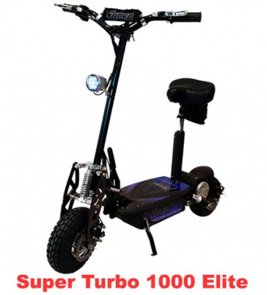

Which method of transport is faster for Dave W or someone like us.
An e-bike?
Or a 1000 Watt e-Scooter?
Depends on what you want! An ebike will give you exercise, scooter not. The scooter you note would be classified a motorcycle on any public roads I'm aware of in the U.S. That scooter is a 1.3 HP, 17 mph top speed (according to the review posted), sealed lead acid battery (deep cycle = heavy SLA) powered, 80 lb motorcycle, requiring a tag and insurance and whatever else your state requires for a motorcycle including motorcycle endorsement on your drivers license. And will your state register that scooter for road use? If you choose to ride a scooter like the Super Turbo on public roads and get caught, you could be cited with a moving violation against your drivers license.
Don't get me wrong I love motorcycles, I've ridden them my whole life, but in the long run this is not a bargain! It's neither fast or cheap. I'm not trying to burst your bubble, just offering my opinion on the choices you've offered. You may want to look at more of Court's reviews on lower cost ebikes.
Good luck!
