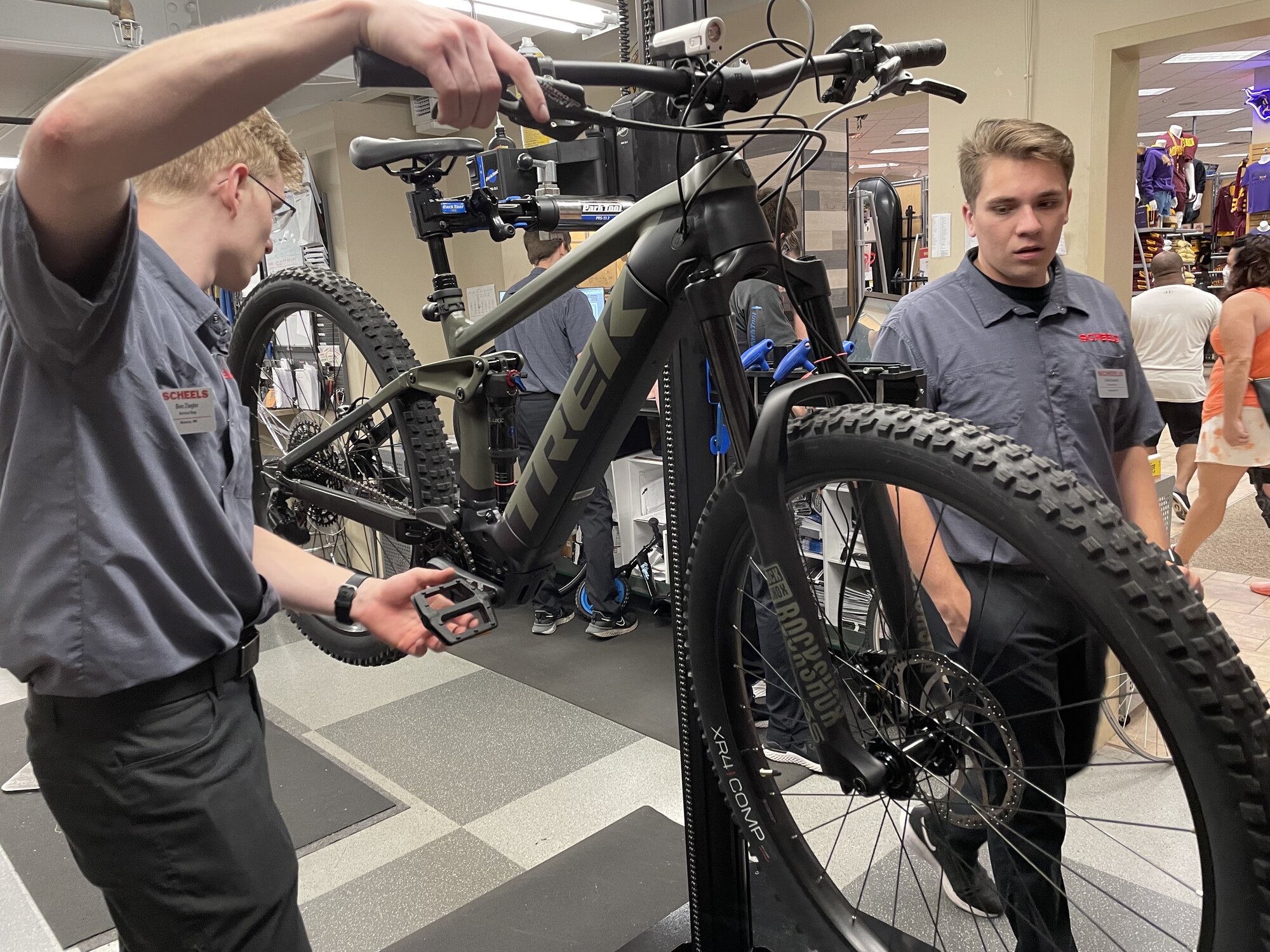

really seems like you could just make one out of wood, bolts and gas pipe and fittings. The actual clamp to hold the bike would be a tougher source. But just a sturdy base with a heavy (metal) sturdy pipe wouldn't be difficult to fabricate. I mean $2,000. + for a stand to hold a bike just seems sort of nuts.... to me. you could build a wide box with 2x4's (pressured treated for more weight), laid out flat on the floor. Then some 3x4 pressure treated plywood (again because it's heavier and stronger) laid and glued/screwed on top as the stage of the box. So basically a stage that's a couple inches off the ground. Use a pipe flange and bolt it to the plywood, reinforce the underside of the flange with more wood or even a flat piece of metal if you want so there's no chance of tear-out.
then you just need some heavy gas pipe, probably 1 1/4" as the Riser,..maybe going to a 'T',.. you could have pipe and a 90 and 'weight' on one side of the 'T' as a counterweight to the bike, then the other side of the 'T' you'd need a bit of pipe and some type of clamp.
I mean that's just a crude 'off the top of my head' idea, but for $2,000.+ bucks I'd probably catry really hard to just build one myself for a couple hundred bucks. You just need to account and build for sturdiness and weight distribution. So you'd want a somewhat wide base so it's hard to tip over, and some kind of counterweight to offset the weight of the bike. And I'd make sure the pipe is perfectly in the center of the base.
If you are going DIY you should pay better attention to properly designed units as your prototype. Your counterweight hanging from a T is a "crazy" and potentially dangerous idea (crazy was your choice of word for me for being willing to pay so much money for a pro level tool). The stabilizing weight should be as low as possible, emulating the pro stands. That means using a 135 lb. 3/4' Steel plate for a base, properly securing the vertical pipe to it with drilled out threaded holes and bolts to secure the pipe flange at the bottom of your stand pipe to the base Then you can find a proper clamping mechanism, figure out how to mount it, set up some sort of lift system so your are not stuck trying to hold a 70 lb. bike with one hand and tighten up the clamp with the other. The main point is to avoid that, which could very likely end in injury to you, damage to the bike or both at some point.

like I said it was off the top of my head. After I thought more about it I thought it would be better to put a couple free weights on the base. I've built lots of stuff from cars to houses to furniture. The first rough idea is never the final idea.
