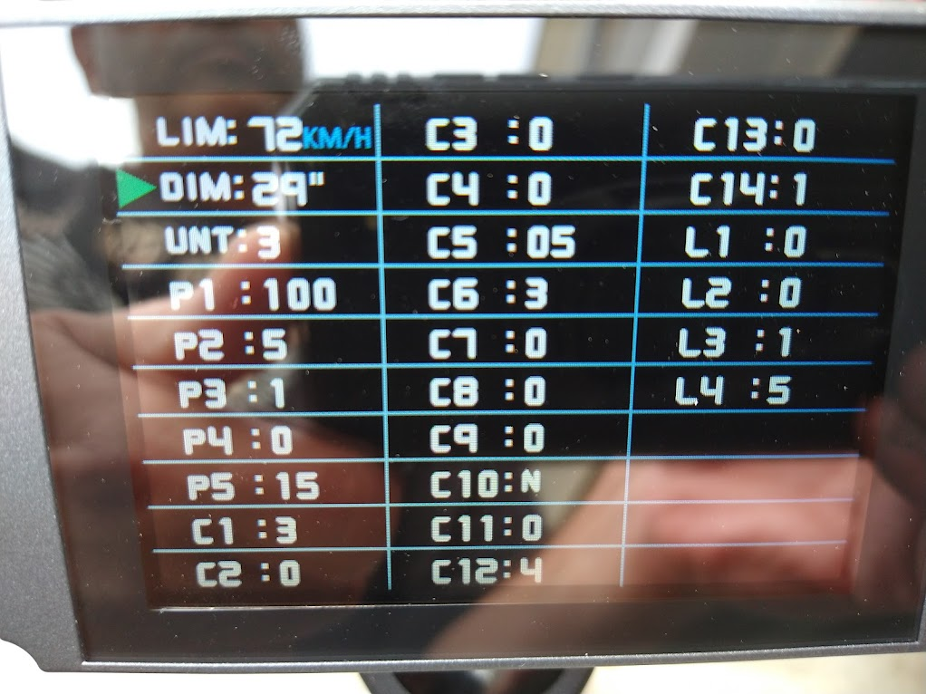

Bolton's video was actually quite good and very helpful. Current settings, but they will be changed a bit (apologies in advance for the crappy photo):

@AHicks sorry for the delay, but I've not been able to get out the past 2 days. I have found out I can mostly smooth things out and reduce the noise from the motor by setting my Bolton controller as follows. Note, I have not been able to get in an extended ride to see how this works overall, but may be on to a solution:
These are all variations on the generic Bolton-recommended settings:
P2: set to 5. This seems to affect the wheel speed sensor?
C5: set to 02. This is max current.
C14: set to 1. This is the "weakest" PAS setting.
I can post my full settings if needed.
It seems to me the motor noise is most impacted by C5, by lowering that I no longer have the incessant buzzing. And a very quick ride indicates I'm getting to close to my ideal settings. A longer ride this weekend will tell me more, and I'll follow up. BTW I was seeing +200 watts in PAS 1 while shifting through the gears, which seems kind of nuts to me.

You're making me wonder if you may not have an issue with this controller. To start with, there should be NO buzzing, and further, C5 settings should not affect buzzing vs. no buzzing. Suggest you get an email in to Bolton in this regard.
I wouldn't put too much weight in settings you get unless you're underway. The 200w is high for sure (for most of us I think). Something in the range of 75-150 is more normal, and to get there you would adjust C5 to get close, then trim using C14. That's what NORMAL would be like anyway. Not clear what you have going on at all.... That controller should be silent under ALL conditions. -Al

My controller stopped buzzing after my first round of adjustments; after yesterday's round, that's when the motor quieted down (granted it was only several hundred feet of riding). I'll fiddle more. Bolton did not respond to my last query.
The +200W was while riding as well. I'll continue fussing with C5 and C14.
I wish they had just a simple sheet for what each setting actually does. I watched another video where a guy described it better than Bolton, but it still feels - very nebulous?
