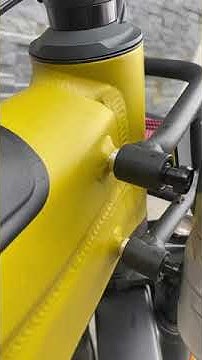

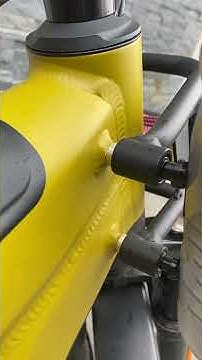

Sadly no. The replacement pegs that came with th e front rack are not the same material as the original ones. The longer new pegs are of a very hard shiny plastic and the originals were slightly squishy. I did try some replacement bottles and they very weakly click into place, the usual bottles just flop into place. I am beginning to wonder if the pegs for the front rack are slightly out of spec. The bottle instructions carefully state that one should ensure that the bottles click into place and there is zero clicking going on. I did try and torque up the pegs but it sounded like it was hitting the end of the screw thread in the frame and not putting more pressure on the peg. I lost another bottle last night and one the night before. I am tempted to take off the front rack and go back to the original pegs. I really would be interested in hearing from someone with the front rack and see if their bottles click into place. I certainly appreciate your help.

That was so kind of you and really helpful. First of all, what a gorgeous bike, love the colour. That grips like mine originally did, with a firm clunk. No it just drops in under its own weight all the way to the bottom. The only explanation I can think of is that I have faulty pegs. Even with my new bottles there is only the slightest click.

Yes, mine too. The trouble is when I fitted the front rack that kit comes with the longer pegs and they are a hard plastic and a little smaller than the original ones.
