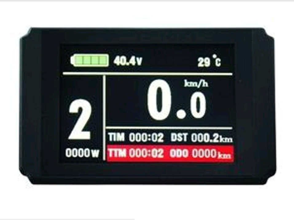

I'm in the process of installing a 25 amp KT controller with a KT-LCD8H display on my ebike.
It shows Voltage and Watts but I don't think it calculates total Watt hours used in a given time?
That would be difficult to calculate.

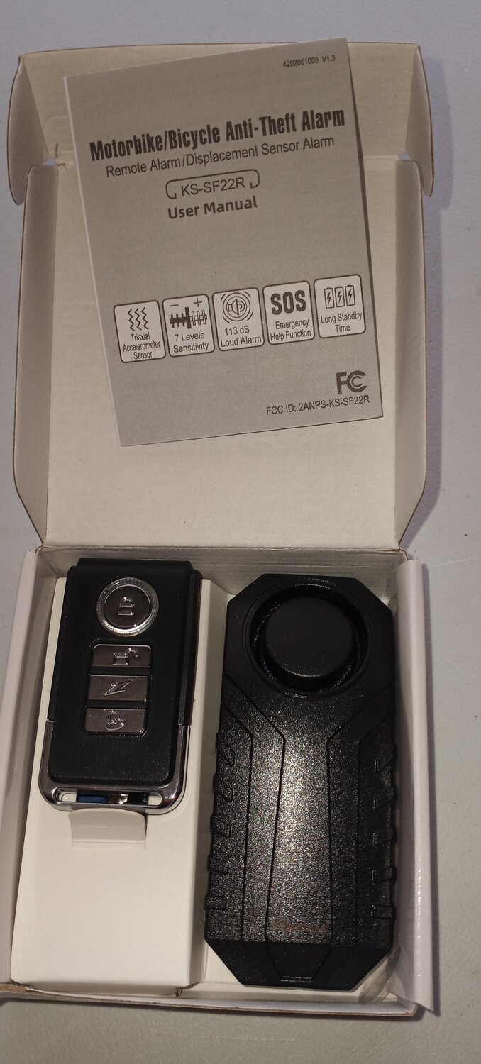

Right now my theft protection is to simply never let the e-bike out of my sight.
I don't even carry a lock.
I will probably invest in a quality lock eventually and that key lock would be a great addition.
I do have an alarm for it but haven't installed it yet.

I have the same LCD8H. It does not calculate watt hours. I have found that that voltage displayed is same as my volt meter with the key. Kind of redundant, for me, but I added the display more recently.

I'm replacing my Das-Kit Controller and C7 Display with KT.
Apparently the volt meter on the C7 Display isn't accurate, and that's a big deal as far as I'm concerned. (I never did check the readings with my voltmeter)
The KT voltage reading is accurate.
