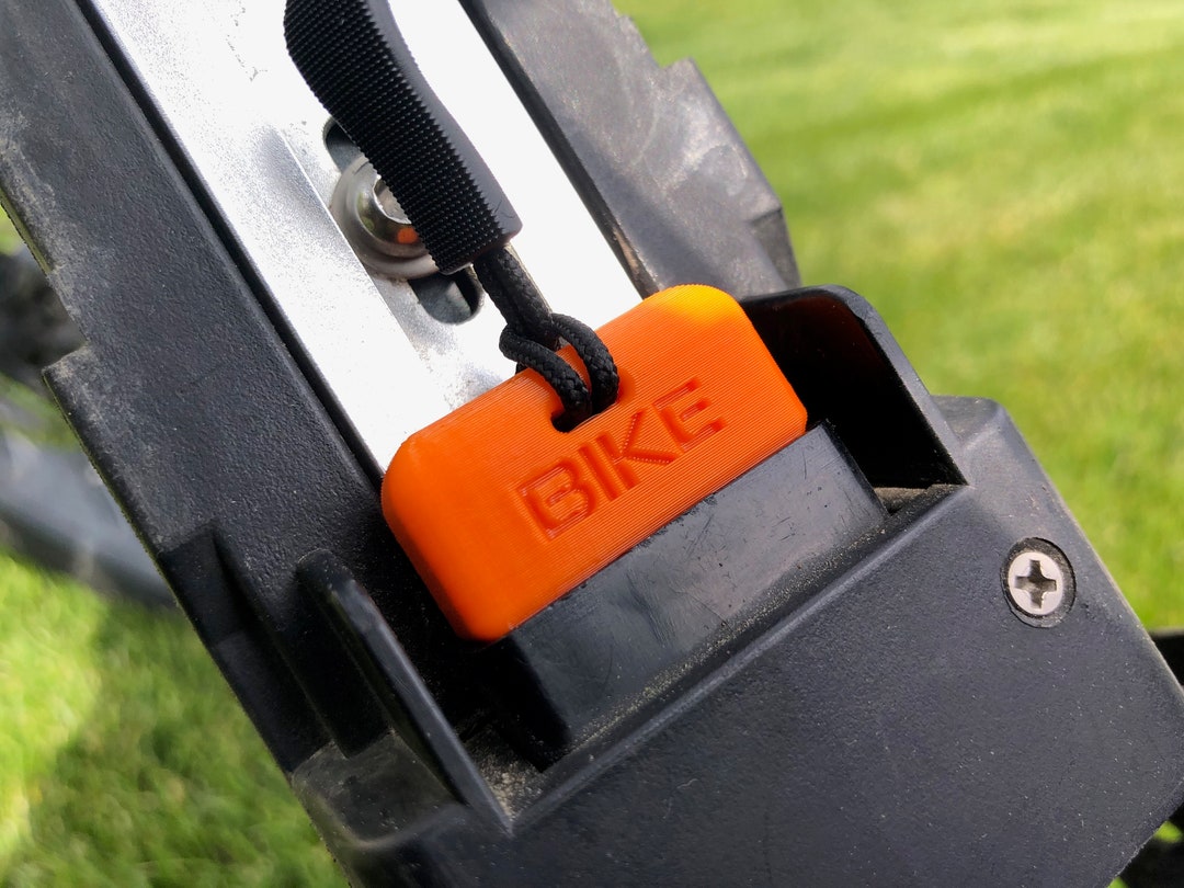

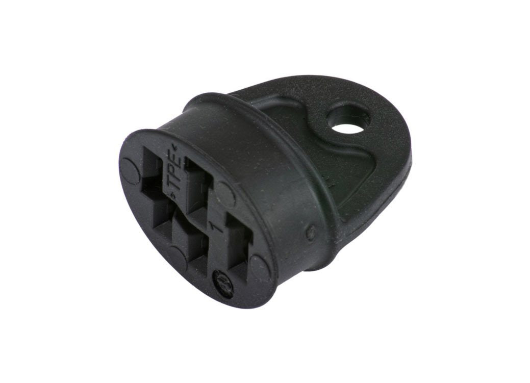

Alaskan
But what about the now exposed contacts? On my Rad Rover they would literally fill up with water.
If you have an internal battery with the cover attached and removing it opens up the down tube cavity to water ingress, either get a velcro neoprene down tube cover and put that over the cavity to keep water out. Otherwise use some Saran Press N Seal sticky plastic wrap with some electrical tape above and below the cavity to keep it from blowing away.
or get one of these:
For those with Bosch motors, Bosch makes a rubber contact cover that is supposed to come with your bike but can be purchased quite inexpensively.

All Bosch displays, with the exception of the Purion are easily and quickly removed from their mounts with a push of a button. If there is any possibility of rain, I cover the mount with its contacts with a plastic bag with some electrical tape to secure it from blowing off. I know others are had wired and not easily removed. I'm not familiar with the Rad setup. If I had a hard wired, bolted on display, I would cover it with a plastic bag and tape it if there was any chance of rain.
If I had a rad, I would get a set of those terminal covers on Etsy that I just showed in post 13. Shy of that Boshield and other sprays leaves a waxy film when it dries and would protect the terminals from corrosion. However that film can also impair conductivity, as can dielectric grease, so the contacts should be cleaned off before reconnecting the battery, which makes it a far less than ideal way to protect from corrosion. best to physically protect them from any water contact at all.

Gordon71
Thanks. I found a seller on ebay that was selling two sets along with a rad key chain and a thumb throttle adapter. Already had an adapter on my rover but will need another one for the Rad Mini when it arrives.
