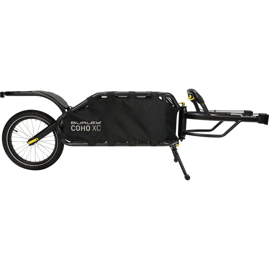

The Coho XC trailer is a great product. I researched it for an unsupported ebike tour we were going to do before COVID hit. Hopefully next year. It's rear fender and front handle are intended to secure long items. It's two point kickstand allows you to easily ride away from the loaded trailer, etc.
With that said, a rear hub motor makes trailer attachment problematic. A Juiced rep on this thread recommends not attaching anything to the motor axle;
Thread 'Bike trailer and CrossCurrent' https://electricbikereview.com/forums/threads/bike-trailer-and-crosscurrent.28869/
Others have posted videos with customized adapters that work for them. YRMV.

I looked at some of the different bike trailers and it seems like they all connect at the axle which is problematic for e-bikes with rear hub motors like my CCX. The QuietCat trailer (found in one of the forums) looks promising even though it's meant for their branded bikes. It looks like they designed it to bolt into the stays and fit over the axle nut. When my shoulder gets better, I'll have to take a look at the rear axle assembly to see if that would work for my CCX.

It looks like the ebikes recommended as compatible with the QuietCat Trailer are all mid-drive ebikes equipped with thru axles. They're actually referring you to the Robert Axle Project for the necessary 12mm thru axle. Seems that it uses the same set up as BOB trailers.

Look for a bike kayak trailer. They're quite lightweight for their bulk capacity, and the long arm connecting to the bike is usually adjustable length. Buddy of mine did this for a few months; I can find out the brand if you like.

I have a similar problem. My bike has a hub motor (something I really should of thought of before getting it), so through axles are a no go for me. I am really concerned about the quality of the stays on my bike so I’d be a little worried about putting any kind of load on them. I had to have the rack replaced after it was delivered. When Juiced sent me a new one, it was a real PITA fitting the new one on the bike. I don’t think they did a particularly good job designing the bike to fit their own proprietary racks let alone a universal rack! The front portion of the rack is pretty useless for any kind of storage or cargo. I don’t think much of their proprietary panniers either.
The point is that I am a little leary of adding any kind of appreciable weight to the stays. I don’t think a seat connected trailer would work either because there is so little room between the bottom of the seat and the rack. Honestly, the issues I’ve had recently make me want to sell it back to Juiced or someone. They’re not even major issues. Just a bunch of little things that end up being a big deal if you plan to use it for anything other than just riding a bike.
