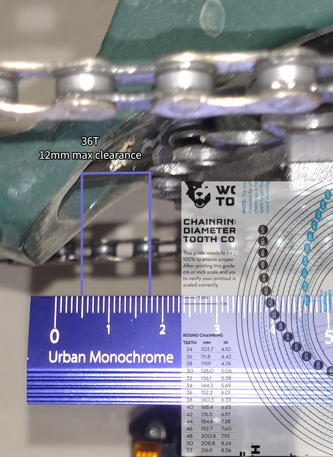

So I am thinking if it is possible to change gears from the original 36T chainring to a 38T or a 40T and increase the top speed. I have a TB-1069 Ebike lockring tool to get off the chainring.

I have changed a few chainrings to a higher gear ratio and it's an easy swap.
If your guide drawing is to scale, it appears that you have 12mm of clearance.
Going from 36T to 40T will increase the chainring Radius by 8mm, allowing 4mm of frame clearance.
You don't need to remove the cranks and can adjust your chain guide to accommodate the larger 40T front chainring.
Make sure that you purchase a 104 BCD, Bolt Circle Diameter front chainring that is the Narrow-Wide type... specs below from EBR.
I have two bikes with the Yamaha PW motors and they have been bulletproof reliable. Good luck and let us know how the swap goes!
OEM Stock: 104 Bolt Circle Diameter, SRAM X-Sync Eagle 36 Tooth Aluminum Alloy Narrow-Wide Chainring

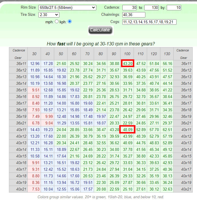

Since you have switched to high gears, may I ask how much the increased top speed is after going from 36T to 40T?
My bike's gears are from Shimano XT m6000 series except the front chainring. I don't know where the chainring comes from, it's a no-brand OEM but seems very durable. Also, the chain is KMC e10s for ebike.
