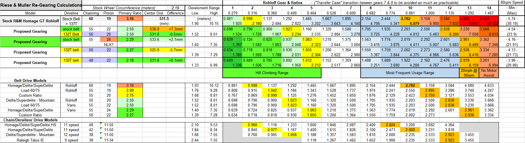

Below is the spreadsheet that I cooked up to help with the decision making.
The upper block shows the current stock Homage/Rohloff/Gates gearing and the resulting gear rations and development for each gear of the Rohloff hub.
Just below the stock bicycle setup numbers are the alternate gearing ratios I am looking at.
The upper left number in the resulting gearing cells is the overall gear ratio for the belt & hub gearing, and the lower right number is the development per pedal revolution in meters.
The column at the far right in the upper block shows the speed that each gearing combination would deliver in both 1st & 14th gear when pedaling at 80rpm.
For each alternate gearing I have shown the difference in the theoretical center-line distance between the pulleys according to the Gates online calculators, and the difference from the stock setup.
I have measured that the rear dropouts have approximately +5mm to -8mm of adjustment space available.
The lower blocks in the spreadsheet show various gearing combinations for other R&M Full-Suspension models, including all three of the primary drive options (Rohloff, Nuvinci, & chain), a few custom ratios using cogs R&M uses across the modesls, as well as my previous E-bike's drivetrain thrown in for me to be able to compare them against another bike that I am familiar with.
The color-coding of the developed gearing cells to the right side is as follows:
- Green = Granny gears (less than 1 wheel revolution for each turn at the cranks)
- Yellow = Direct-Drive (approx.) 1:1 wheel to crank revolution
- Blue = most frequently used gears in level or slightly rolling terrain
- Orange = 20mph motor assist cut-off when pedaling at 80-90rpm
- Red & Pink = No motor assist at normal pedal cadence.
One thing that becomes very obvious when looking at the chain drive versions is that R&M DOES change the gearing on those models between the HS and standard Class-1 bikes, and goes even lower for the "Mountain" versions by changing the size of the chainrings for each.
So, with all the other belt drive gear ratios that R&M is currently using across the various Full-Suspension models, why do they not offer different gear ratios for the HS vs. Class-1 versions???
My aim is to fix that oversight.
And it is clear that there are several options for doing so with parts that R&M is already using on other models.

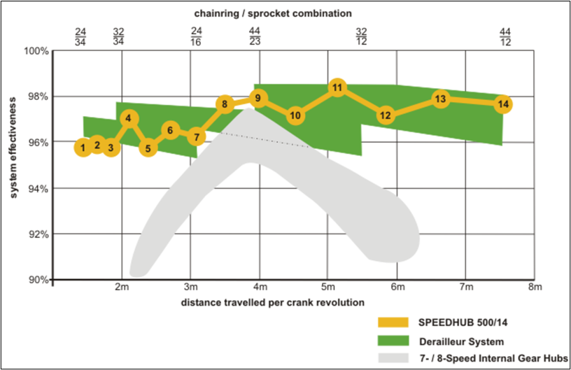

Another factor to take into account when using the Rohloff hub is that it is more efficient in the upper 7 gears,
AND, that the shift between 7th & 8th gear is a bit more clunky and takes longer than other transitions because the Rohloff is basically a 7-speed hub with a 2-speed transfer case.
The transfer case under-drives the seven gears for the low-range 1-thru-7 gears, which causes them to spin faster.
That is what causes the additional losses in the hub in the lower range gears.
To change between 7th-to-8th (or 8th-to-7th) the hub does two separate shift operations in sequence, going from low-to-high on the transfer gears, as well as 7th-to-1st in the main geartrain.
You can see the definitive change of the internal hub efficiency in this graph from the Rohloff website.
SO, ideally, I want to also pick a primary gear reduction which lets me stay in the upper range of the hub as much as possible.
Since I have already proven to myself that pretty much any final gearing above 2.80-2.90 is not usable for my physical condition,
Adding in the hub considerations puts me looking most intently at the 2.29 or 2.27 primary belt drive ratios most closely,

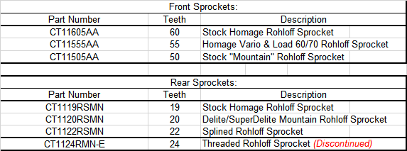

My preferred solution is to go with the 55/24 combination which will allow me to use the stock belt length, since I already bought a spare to get me home if disaster strikes.
And if I do decide that is too low, I can swap the 24T rear cog for a 22T while still using the same belts.
(and keeping the sprockets as large as possible reduces hysteresis losses from less belt bending)
Yes, I know that the 24T Gates sprocket for Rohloff was only made for the older threaded fitting and is technically discontinued, but I do have a source for one and the required threaded adapter ring.

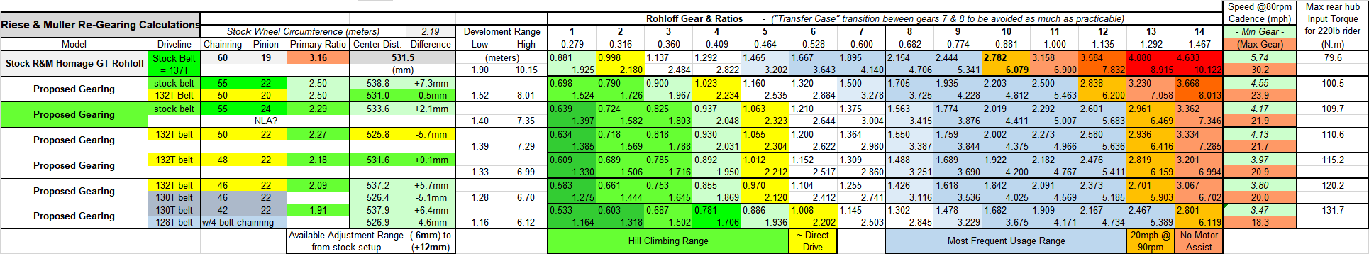

Just for fun {and because I LOVE playing with spreadsheets and gathering data!} I updated my spreadsheet to include some lower primary gear ratio options.
Here is the result:
You can now compare several more options for your Delight Mountain Rohloff!!!
Notes:
- The differences from stock center distance shown above is in comparison to the Homage 60/19 stock gearing, which is 0.5mm more than the theoretical center distance for the stock Delight Mountain Rohloff 50/20 gearing. The distances are similar to the Delite because the two models use the same rear swingarm assembly.
- Available adjustment range refers to actual measurements taken on the rear adjustable dropouts on my personal 2021 R&M Homage with stock gearing and belt.
- All measurements are in metric except for the speeds developed at 80rpm cadence in the second from last column which are in miles-per-hour.)
Gates does offer a 48T front chainring in 4-bolt and 5-bolt versions as well.
With a 48/22 gearing combination you will get a primary reduction of 2.27 compared to the stock 2.50 gearing.
Nice thing about that setup is that you are going up the same number of teeth in the rear as you are going down at the front, which nets virtually the same center distance according to the Gates gearing calculator.
531.0mm (50/20) vs 531.6mm (48/22)
You can find the Gates center distance calculator tool near the bottom of this page:
https://www.gatessanitycheck.com/
There is a small check box under the button for the drivetrain sanity check calculator for the Center Distance Calculator.
You can use that to look at the differences in distances between the sprockets for a 46T front sprocket.
46/22 (2.09) gearing with a 132T belt = 537.5mm center distance
46/22 (2.09) gearing with a 130T belt = 526.4mm center distance
If you have or switch to a 4-bolt chainring spider, you can also go down to a 42T front sprocket and get the lowest primary gear reduction that the Rohloff hub allows of 1.90 you can also consider these combinations:
42/22 (1.91) gearing with a 130T belt = 537.9mm center distance
42/22 (1.91) gearing with a 128T belt = 526.9mm center distance
As always, YMMV.

Rohloff threaded sprocket adapter ring arrived in the mail last night and the bike was put back together with the new 55/24 gearing installed.
As expected, a quick test ride showed that the Bosch control system along with the Rohloff E14 integrated shifting is not happy with the new gearing and cuts motor assist within a few feet of beginning to pedal.
The bike is now at my LBS awaiting word from the R&M Service Center whether they will support the change and download appropriate changes to the programming.
Film at 11...

Ah, whoops, missed that. That’s… strange, to me, but ok, hopefully they will provide the support then!
Jay Kay
Latest News:
Heard today that R&M is authorizing the change to the primary gearing change.
Currently working with my LBS to schedule a time for R&M to connect to my bike remotely to download the changes needed.
I am STOKED!!!
That is a pretty awesome outcome. Enjoy!
I am STOKED!!!
So did this happen yet? I feel like the gearing on the Rohloff Load is already low enough for me given that it starts with the 55, in 1st I’m going slow enough to be borderline balance constrained with the dog up front, and my cadence is lower than yours, but very curious to hear the results!
BMWzenRider
Not yet.
With the holiday hours for both R&M and my shop, they could not coordinate a date till January 6th.
