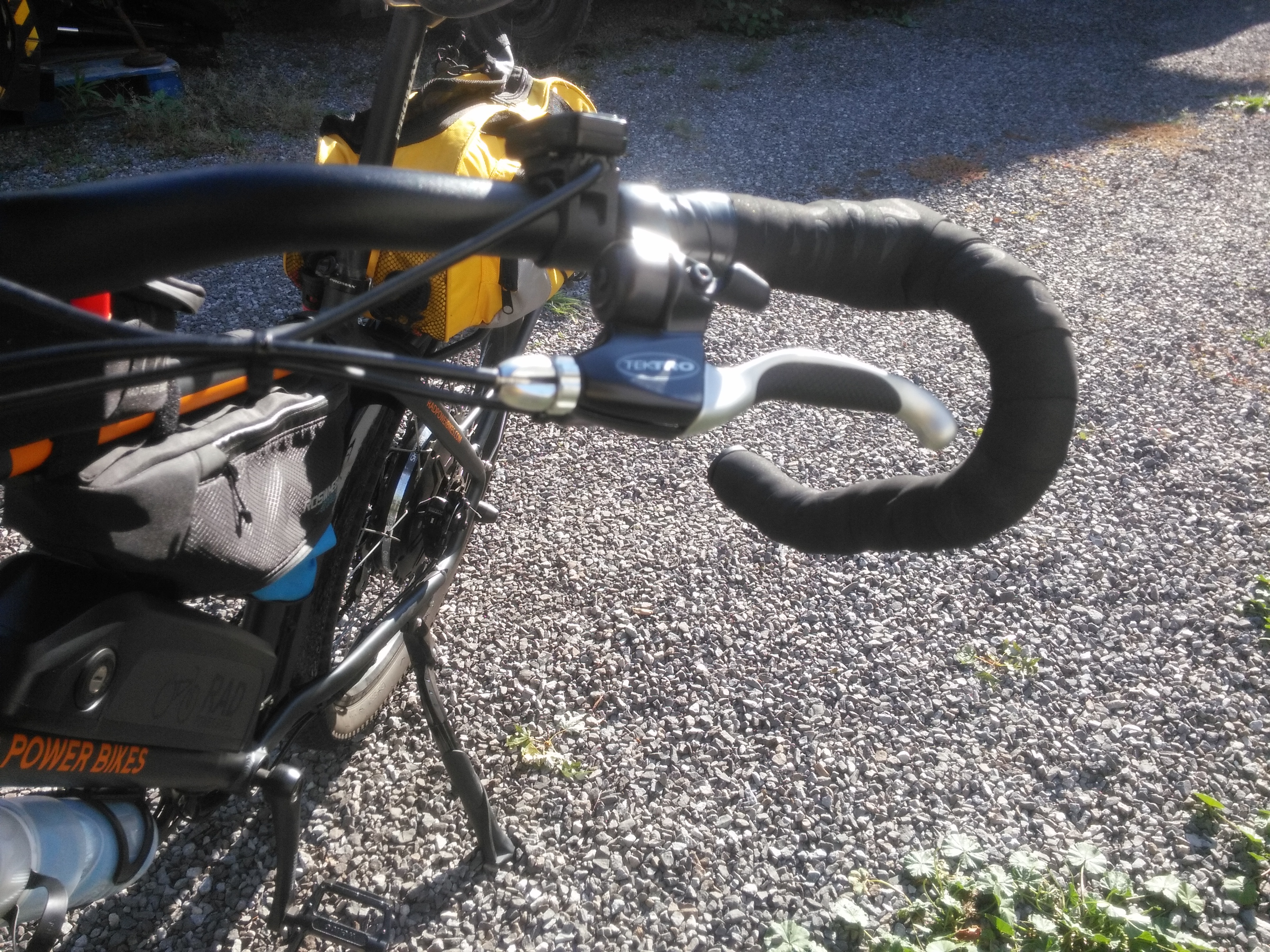

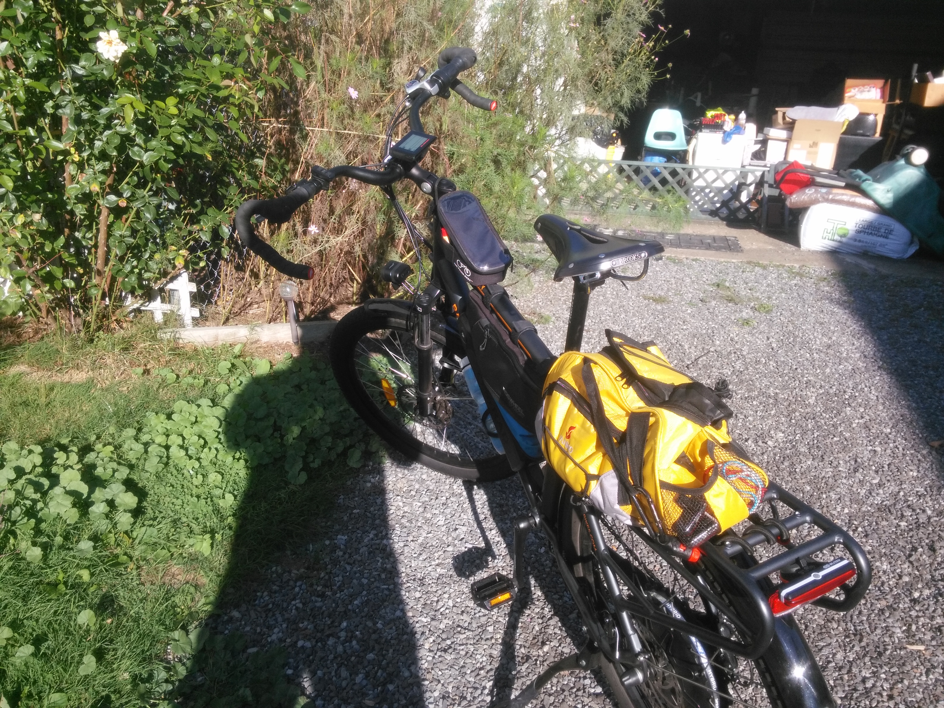

Today installed drop ends. https://www.amazon.com/gp/product/B0013G6PB8/ref=oh_aui_detailpage_o02_s00?ie=UTF8&psc=1
View attachment 25932View attachment 25933

If you could have someone shoot a couple of pictures from different angles with your hands on the drops I would appreciate it. I'm having trouble understanding the comfort with them so far out from center!
larry-new
Here's a couple:
You know, alternatively, I could take out the 20mm extenders and use them to extend the drops. I'd just have to move everything inboard a bit, which is easy. It does seem pretty wide.
Taking your advice and moving everything inward 3" total, 1.5" per side.
rich c
Thanks. Still not sure I like the idea of being that far from the controls. For my road bike, I added the short vertical horns. I like them because I can lean my open hands against them and not have to squeeze with my hands to keep them on the grips. So that lets me ride with open or closed hands. Evens out the sun tan that way (if I'm not wearing fingerless gloves)! LOL
larry-new
I'm rarely in the drops, and country roads don't have many times when the brakes need to be covered, but I can ride the tops, and reach the brakes with a finger or two. The discs are so much better than the rim brakes I had before, that even a two thumbs squeeze can be used. The main benefit is the added hand positions...including flat over the brakes, or asymmetric for quartering winds, etc, etc.
