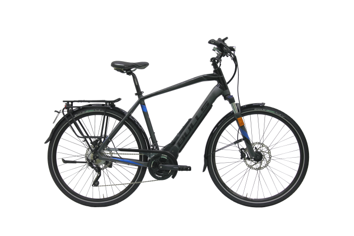

Rick53,
I’m 66, so my joints are older than yours. If you’re looking for a bike like mine with flat handlebars, check out this model:
Bulls has a few other similar Class 3 models as well.
