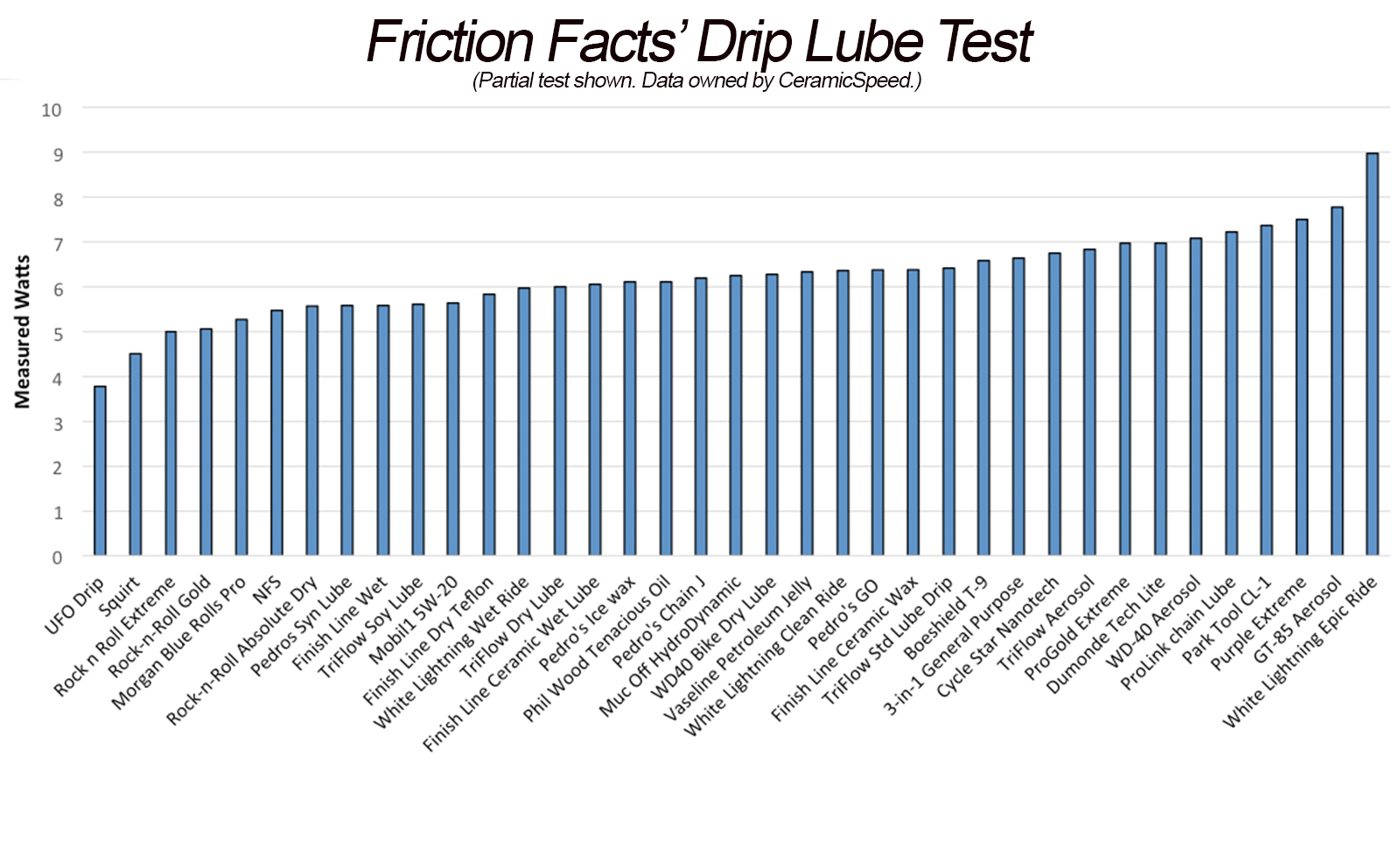

Chain maintenance and lube become almost a religion supporting very long threads. To add to this one, there have been a number of tests trying to identify the best lube.
This data was published by cyclingtips.com in 2018. Posts on other threads support their findings re Squirt and Rock-n-Roll lubes.
Haven't seen any data that includes 5W oil, ATF, etc, but others swear by these 'alternative' lubes. I'm using Finish Line Dry now but will probably change to whatever is on sale when this runs out...
Ride On!
I love that this test included
Mobil-1, Vaseline, and good old 3-in-1 Oil... gotta give em credit for trying everything. 😉
I use Squirt wax and Muc Off Ceramic dry lube depending on conditions... YMMV.

If we rode in a laboratory I could say that these test have some validity... but since we don't I say they are boooolshit perpetuated by the guberment.
IMO the devil is contamination... so the best solution is cheap, easy and often and not how long it last or how few watts burned in a lab.
Wipe it down, Flush it with new oil, Repeat.
