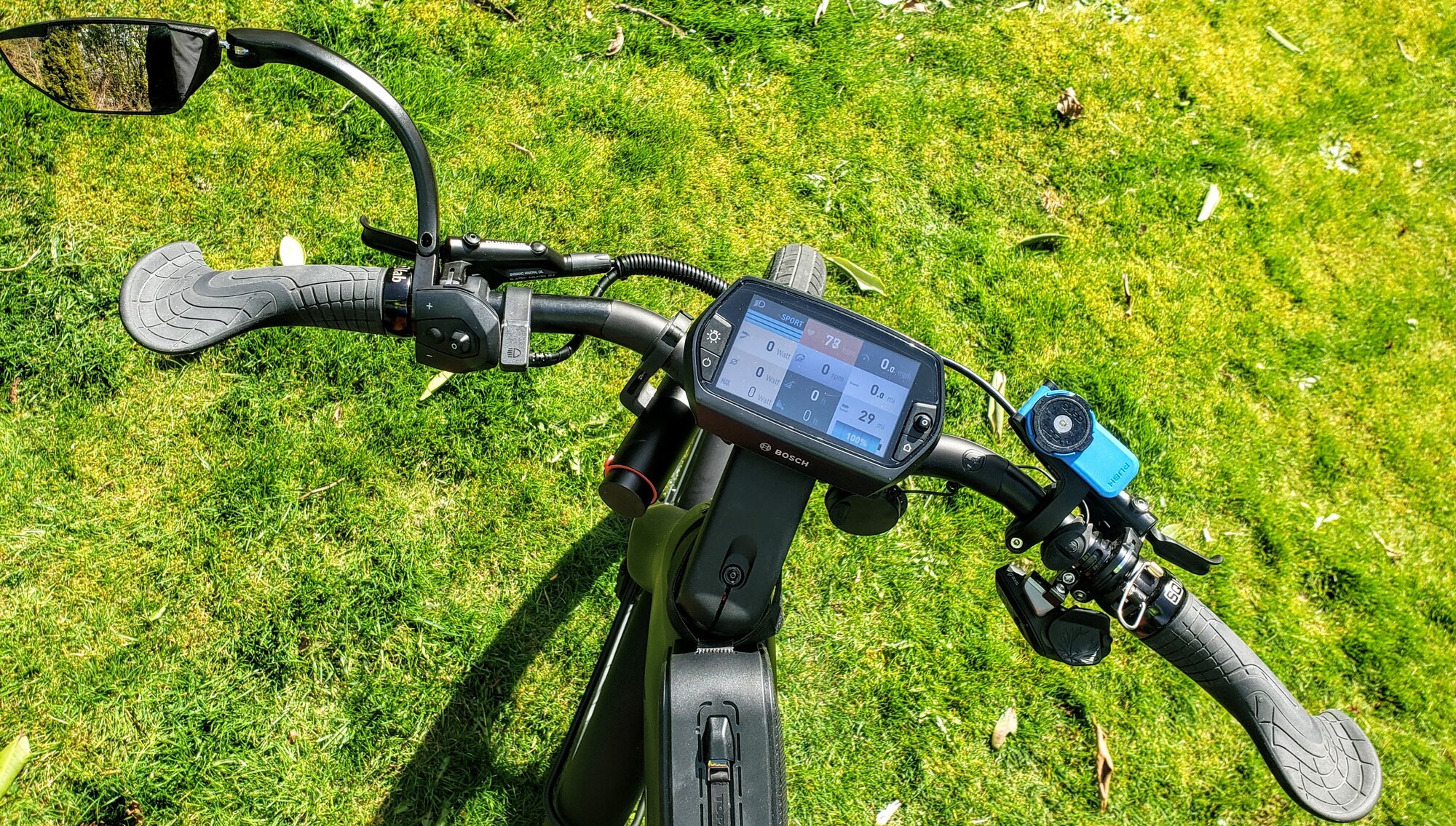

As to displays, I am totally underwhelmed by the smartphone hub. Given people's addictions to their phones, I get why Bosch makes this option. Frankly too many stories of screws coming loose and phone flying off bikes. Also, as a retired professional mariner, I prefer dedicated devices for navigation rather than adapting computers for the purpose. The Nyon is top of the list for me. I have the Gen 1 Nyon on all my bikes. It is head and shoulders the best bike display, navigator, integrated info device available.

As to displays, I am totally underwhelmed by the smartphone hub. Given people's addictions to their phones, I get why Bosch make this option. Frankly too many stories of screws coming loose and phone flying off bikes. Also, as a retired professional mariner, I prefer dedicated devices for navigation rather than adapting computers for the purpose. The Nyon is top of the list for me. I have the Gen 1 Nyon on all my bikes. It is head and shoulders the best bike display, navigator, integrate info device available.
