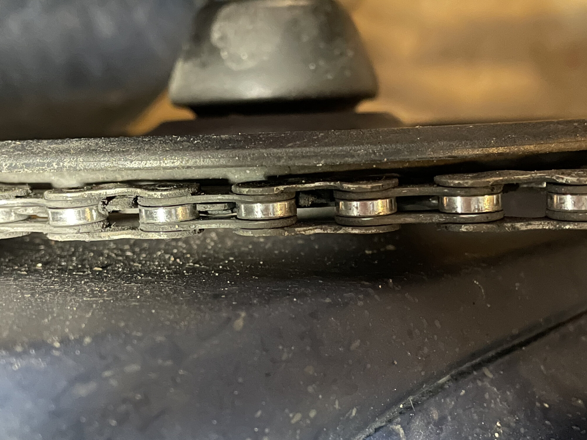

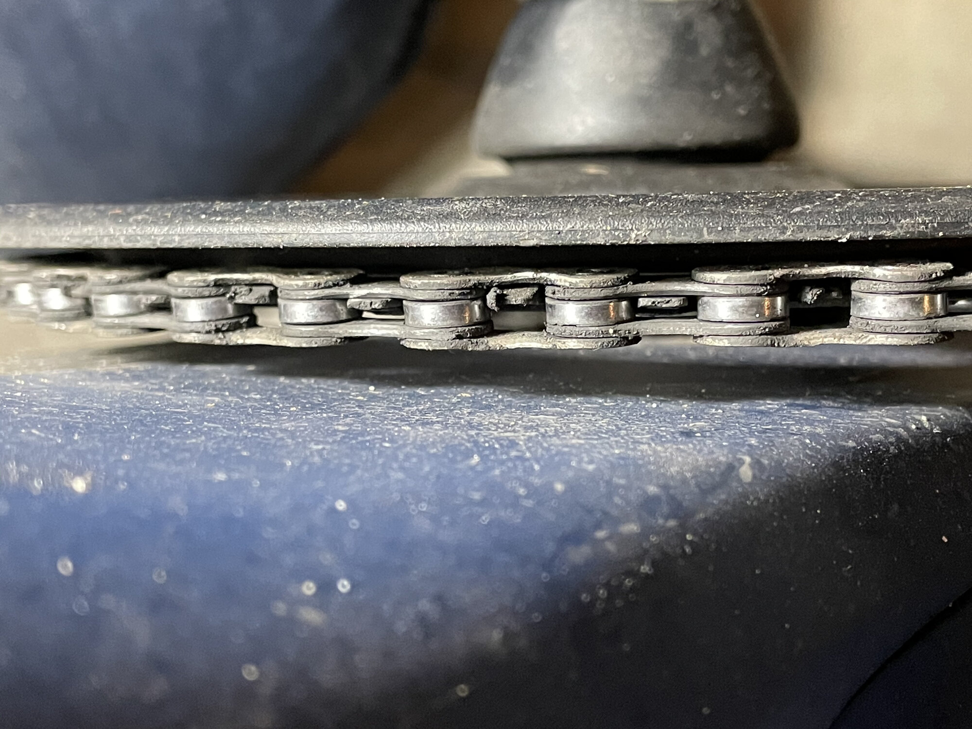

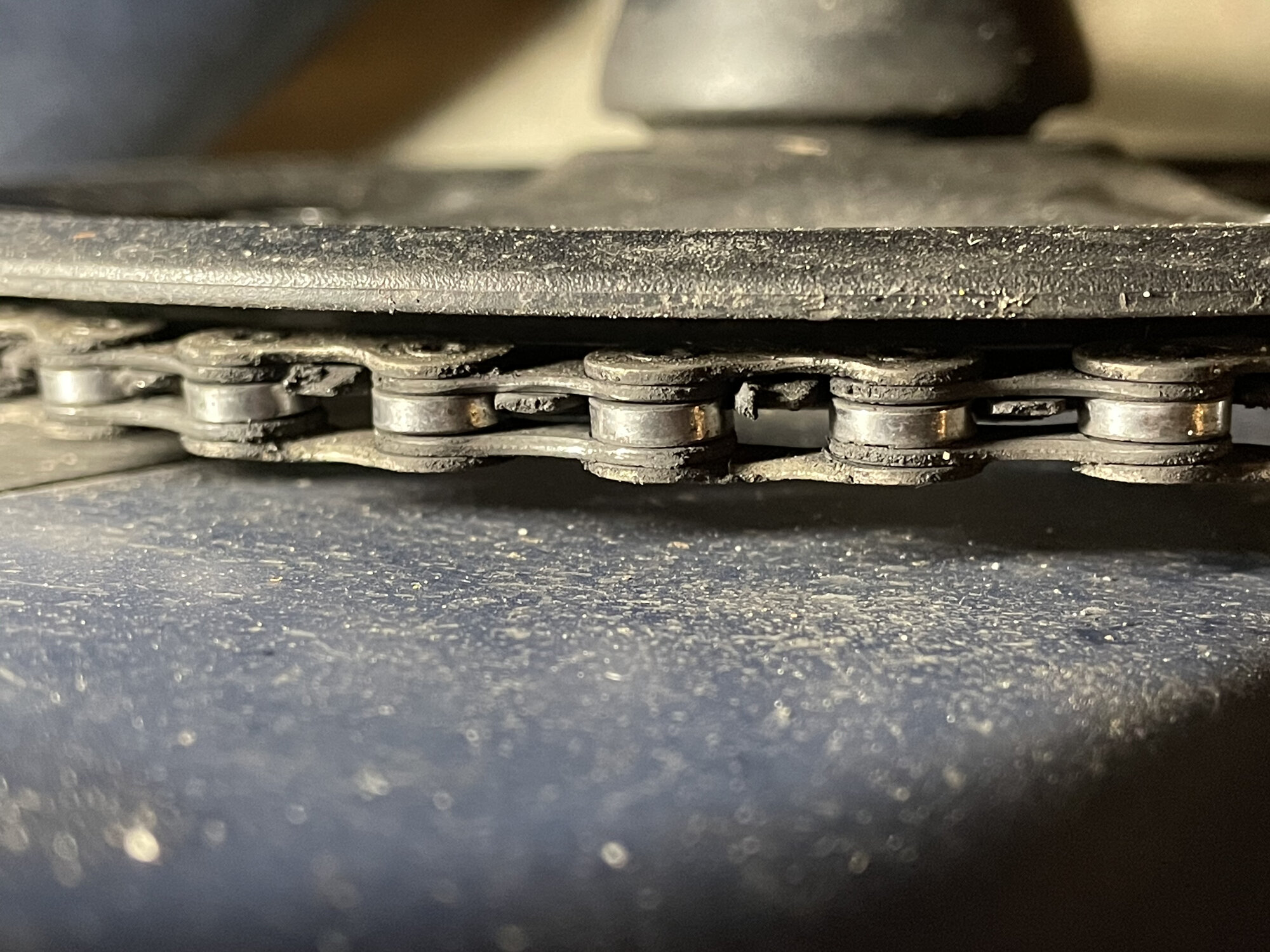

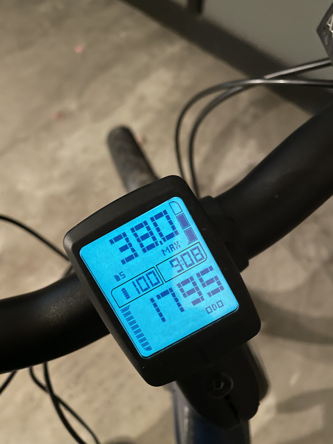

The ODO shows 1795. Not sure if the chain is mounted correctly, or if the entire setup is excessively dirty.

Hmmm... Perhaps you could clean the chain first? :) The rule is: WIDE tooth in NARROW (inner) chain-link. NARROW tooth in the WIDE (outer) chain-link. It is hard for me to see anything in these pictures. The chain should be often degreased and oiled... and that's the rule #1. You cannot expect smooth operation of the drive-train without having it maintained.

Can you provide a picture of the chain from the side?
Do you know brand and model of the new chain (is it Shimano xxx or KMC or ?)

The chain ring has a graphic on the side towards the bike that shows the proper chain installation on the wide/narrow tooth pattern;
What maintenance had you been doing to the original chain? I clean and lube my Vado 5 chain every 250-300 miles. I assume the ODO reading is in miles since you're from WA state? If you'd been doing similar chain maintenance your chain ring is probably OK at ~1,800 miles. If not, as @STSKIDMORE mentioned, you may need a new chain ring along with the new chain. If your issues started after the new chain install this would be further indicative of chain ring wear.

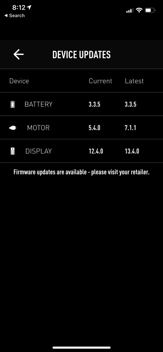

BTW - A firmware update would be a good idea. A Specialized dealer needs to do this.
