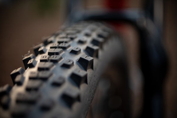

Last year, Schwalbe released an E-bike-specific tire, Johnny Watts designed to handle varied conditions and they were released in high volume sizes.
Continuing the trend, Continental is releasing eRuban Plus tire.
