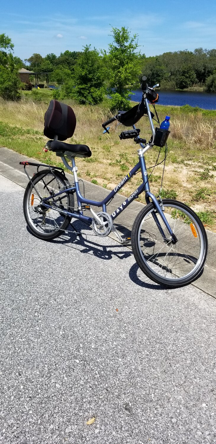

This Dream 7 is a heavy bike, I'd love to convert it to a front wheel drive with a Rad Rover power system. I can't "push" it past 8mph, and my knees give out by about 6 miles. The RRST I bought a year ago has been what I needed to get out on a bike again. But I miss the comfort of this ride

I agree with Tom. The kits from Grin at ebikes.ca are great. However, I would consider a rear hub or mid-drive kit for that bike. It looks like all the weight is over the rear wheel and the front wheel may not have much traction. That bike is difficult to pedal because you are so far back and don't have any weight over the pedals. You can't leverage your body weight and have to use all muscle. It is not just the weight of the bike.

I'm familiar with Rad, totally trust the components of Rad Power Bikes. I like the cadance system and PAS levels avaliable. Would like a direct drive that would add weight to the front of the bike and to help get the bike rolling. The trail is great for higher speeds but wonders at lower speeds. I think that is because the rake is causing an exaggeratedly long trail.
I love the semi-recumbant. It's not difficult to pedal at all. I have no cartilage on one patella and can't put the "muscle" stress through the left knee. My wife rides hers using legs, I have to slide forward to get weight on my rt leg to "muscle" up an incline. No bike works for me without an assist. One of the grand effects of getting old!
I looked at the ebikes.ca . Looks good, just don't see the specs for clearance needed to mount on the existing frame/front fork set-up.

By clearance, do you mean the hub spacing or O.L.D.? Most bikes use 100mm spacing on the front hub and your bike doesn't look like an exception. You can measure it to be sure. The rear O.L.D. can vary a lot with the age of the bike. Be sure to get a torque arm with whatever kit you buy. Grin includes one, but not all kits do. The Grin kits with the CA3 are completely customizable for PAS levels, cadence sensors, and they even offer torque sensors.

Tom, Run, and Harry - Thanks for the thoughts and input. The bike is lighter on the front end, so too much power is a concern. It's a steel front fork, alloy frame. The bike is about 34 pounds like it sits. A little assistance would make it more "knee frendly".
