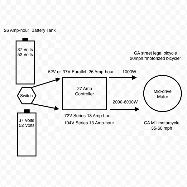

Which motor best suits your riding style? Is it possible that a simple switch can convert the same bike from a legal 20mph "bicycle" to a 40+ mph motorcycle? Yes. Four Crystalyte rear hub motors are compared to illustrate the relationship between power(W), speed(mph), torque(Nm), volts(V) and amps(A). Three 8Fun BBS02 center-mounted motor are also compared in the same manner.
The conclusion is the most flexible solution is a 27Amp, 72Volt, 1944Watt controller, compatible with two 13 Amp-hour, 37V battery packs. Certainly, a 72V, 27A, 1944W system is fun for off-road use. Switching the 72V series connection between two 37V volt battery packs to a parallel connection would convert the battery packs from a 72V, 13 Amp-hour into a 37V, 26 Amp-hour power supply. A flexible switch allows a fun, powerful off-road to be instantly converted to a CA legal bicycle. The 37V, 1000W controller switch permits access in CA to bicycle paths as "motorized bicycle".

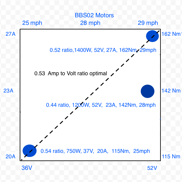

The following graph illustrates the conceptual relationships. Torque, an indication of hill-climbing power, is presented in Newton-meters(Nm), rather than foot-pounds. The solid color dots chart torque against speed. The dotted circles illustrate the amp to volt ratios.
The dotted line in previous graph represents my idealized watt ratio. Each watt has three parts amps and four parts volts. Amps are correlated with hill-climbing power. Volts loosely relates to speed and acceleration. Think of the ratio as a cup of coffee. How much cream and sugar suits your taste?
In other words, a 36 volt, 9 amp, 350 watt EuroMotor just ain't my cup of tea -- about half my desired amp ratio. My favorite motor in the following graph is the 4200 watt 5403, but unfortunately is too heavy. My ideal choice is a 27 amp, 36 volt BBS02, which is three times EuroMotor amperage.
The 8Fun BBS02 center-mounted motor is contrasted with hub motors in the following picture. The optimal amp-to-volt ratio for the BBS02 is 0.53.

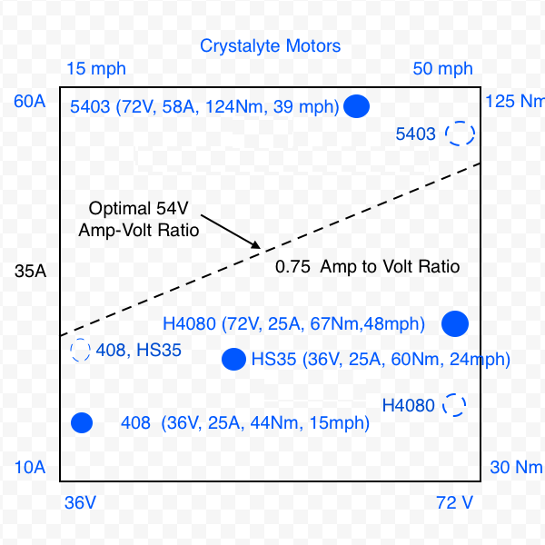

The 5403 also uses the more expensive 72V battery pack to achieve higher power, which costs $1200 more for the 26 amp-hour pack.
In California, 1000 watts is the legal limit for "motorized bicycles". Since the motor is restricted to 1000 watts of electrical power, my goal is to find the motor that generates the greatest torque for 1000 watts. In CA, 1001 to 1500 (2 HP) is a M2 scooter, which is prohibited from bicycle paths.
The constraints I choose to accept are a maximum 54 volts and 27 amps. Therefore, optimizing the bike gearing is crucial for a satisfactory outcome. Configure the highest gear ratio possible with Rohloff Integrated Gear Hub (IGH) to pedal the largest chainring my legs can tolerate.

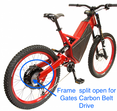

Some of the reasons I chose the following frame are:
  1. Split frame for belt and chain compatibility. Frame weighs only weighs 19 pounds.

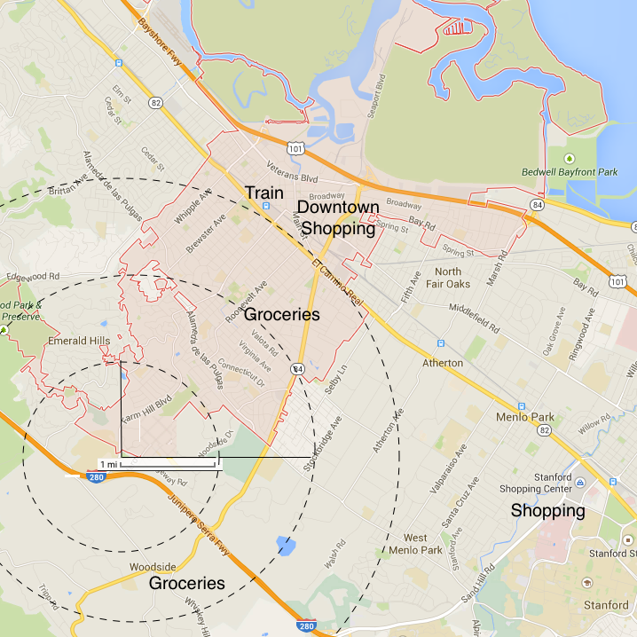

The bike share lane in the rolling hills has a 25mph speed limit. The hills are about a 5% grade. The extra torque might be a substantial help to maintain 25mph pedal speeds. If the additional seven amps maintains a 20mph minimum speed, keeping up with traffic would be much easier and safer.

The most flexible solution is a 27A, 72V, 1944W controller, compatible with a 36V battery pack. Certainly a 72V would be fun for off-road use. Switching the 36 volt battery pack connection from series to parallel would allow legal bicycle path access. Neither I, nor HPC knows of such a system for BBS02, as 60V is the highest controller available.
Since I will by the 52V system, I have the option to double the voltage for a rear 104V hub motor. With a 40A or 55A controller, that would result in a 45-60mph, 4500- 6000W motorcycle .

I weigh 182 pounds and am six feet tall. My total weight with groceries is about 220 pounds. I estimate 5Nm of torque for each percent grade. My hills are very steep 10% to 18%. I travel about one mile on 12% grade. I only consider bikes with at least 90Nm torque, which rules out the Kahlkoff . I hold no illusion that 1000W is an absolute minimum for my situation.
Every week I carry at least 30 pounds of food from the store -- your best solution! The trick is to use a high quality fanny pack and a backpack. I use an expensive MountainSmith fanny pack for dense groceries. I use a cheap backpack for light, bulky paper goods. REI carries MountainSmith. I stuff the backpack into the fanny pack on the way to the store.
