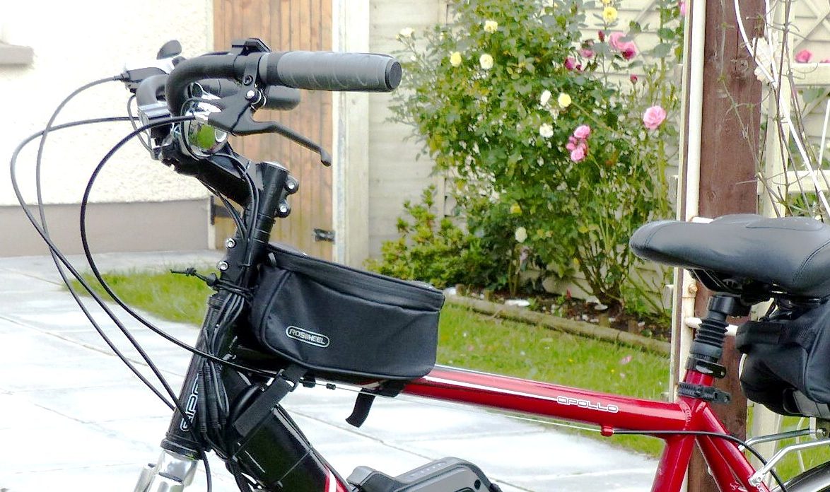

RoyL
Mike, i had to do all three to get a more upright and comfortable position.
Seat post down,
4" Riser on the stem
North Rounder Comfort Handlebars - from Amazon http://www.amazon.co.uk/dp/B002OBKRGU/ref=pe_385721_37038051_TE_3p_dp_1

Thanks, JR, I will submit a picture after I make the adjustments. I will go as far as possible without altering the cables.
