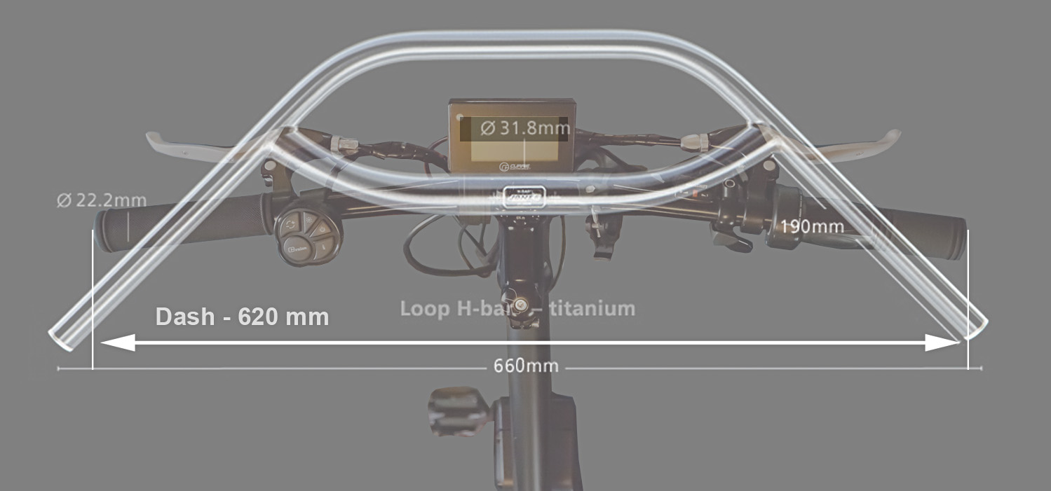

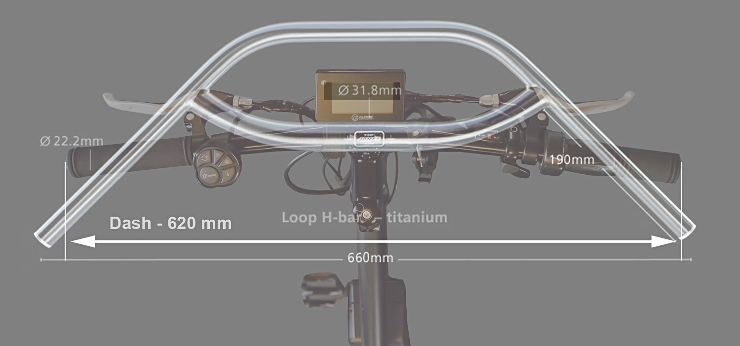

I'm also looking at the Jones H bar, aluminum per Pace's suggestion. Here is a scale layover of the H bar & Dash. The H bar photo is a little asymmetrical so this is probably a close approximation. Width in mm X 2 = pixel space. I was not sure about the swept back handles, may just try a hoop aero bar, however ridiculous. Cheers, -S
After spending some time with my ebike, I find the handle bar to be good for control but not for comfort esp on long bumpy roads. Putting load to the upper limbs caused aches and pains to my wrist, elbow, shoulder joints. I figured if I can put all the weight to the butt on body float seat post (alternate with feet loading by standing) I would solve the problem. I got the jones cut H bar
http://www.jonesbikes.com/h-bar-jones-cut-710-aluminum/
and put aero extension for high speed cruise.
Adding a very short stem
https://www.amazon.com/Bicycle-Cycling-Handlebar-Degree-31-8mm/dp/B00QK0N36W
made the whole steup into an all-position-handle bar where you can sit full upright or assume full aero and anywhere in between.
