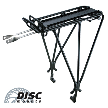

@Bud Its pretty cool when the head of the company contacts you! My experience as a dealer was that Currie Tech always gone the extra mile to help their customers. If you want to add a rear rack, choose one that is designed to accommodate a disc brake; not all do. We found the Topeak Explorer (for disc brake) a nice, easy to install rack that had a higher carrying capacity than your average rack. Most bike shops carry this or can get it for you. In addition it has their 'quick track' system on the top of the rack which lets you snap in a rack top trunk--nice on those days when you don't need full on saddlebags, but want to carry the all important lock & battery charger!

@Bud If you want to add a rear rack, choose one that is designed to accommodate a disc brake; not all do. View attachment 3425
This isn't really a big issue on the dash since the caliper is mounted on the chain stay vs the seat stay. I swapped out a number of old racks I had when figuring out what I wanted to use and they all fit ok
