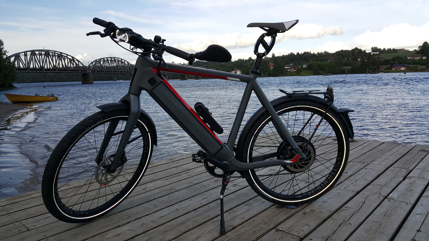

There is no luggage rack on the ST2-S.
I added a seatpost clamp and Topeak MTX EXP saddle bag.
Thats a cool picture with Mount Rushmore in the background :)
What do you mean by "There is no luggage rack on the ST2-S."?
Ravi Kempaiah
This is my bike. Its the ST2-S.
I was under the impression that the racks on the ST2 and the ST2-S were similar. But this is not hte case then :-(

Is this photo taken in Norway? The background landscape and buildings looks a lot like Norway. :)
Yes. The river is "Glomma"; the longest river in Norway, being aprox 604 km/ 375 miles long. The location is Fetsund, a community aprox 25 kilometers from Oslo/ capitol. Good call Roger ;-)
