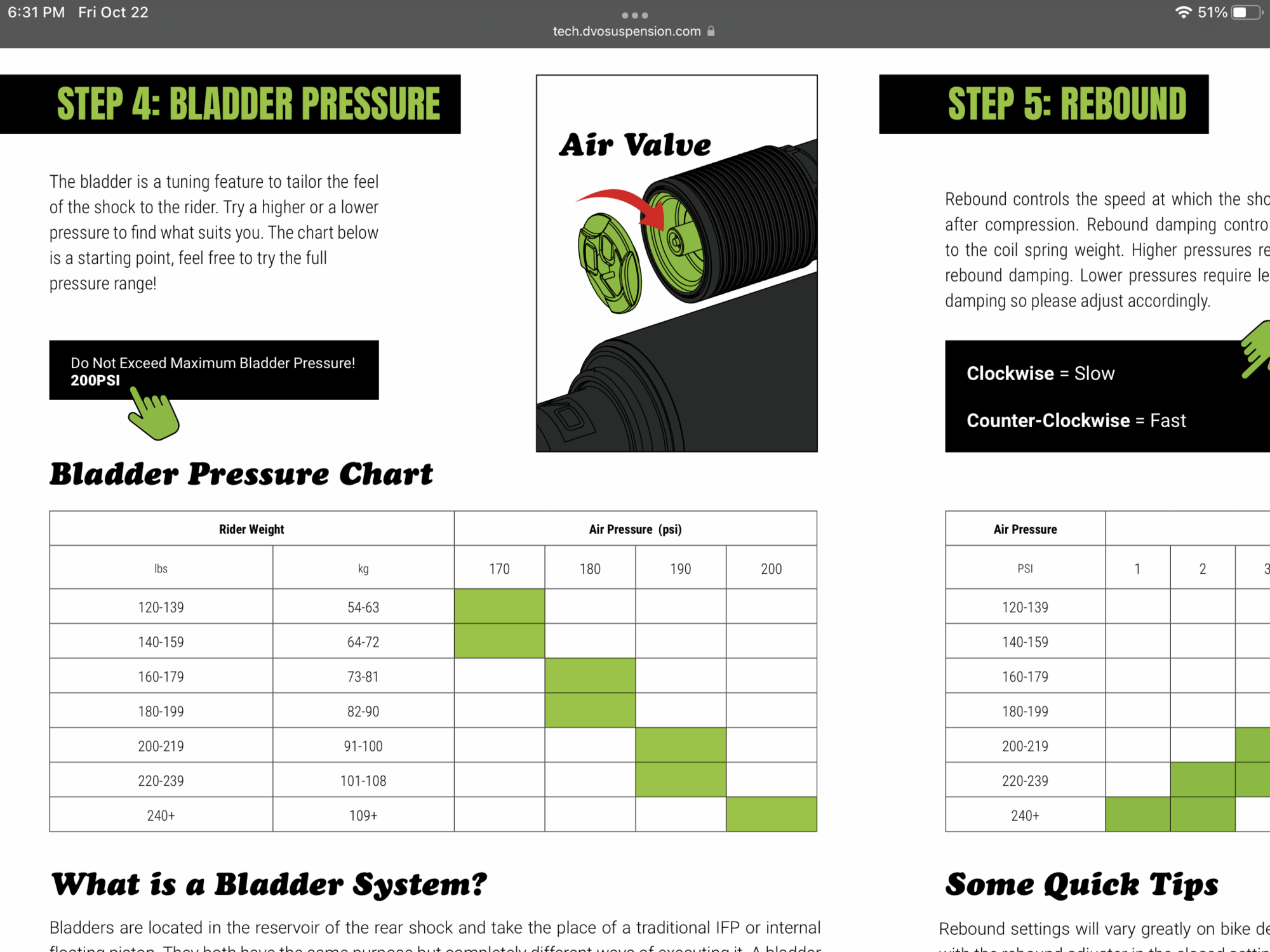

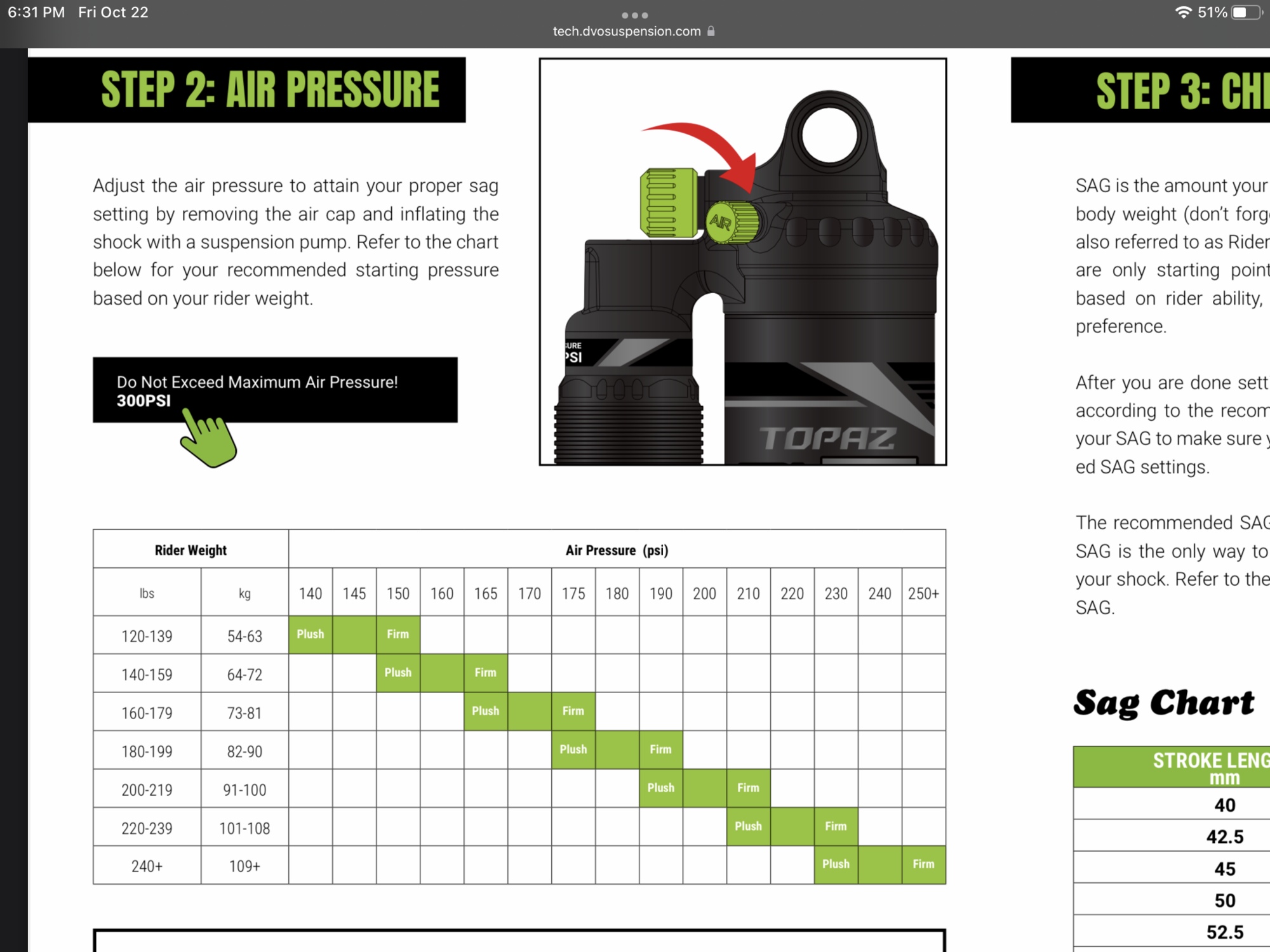

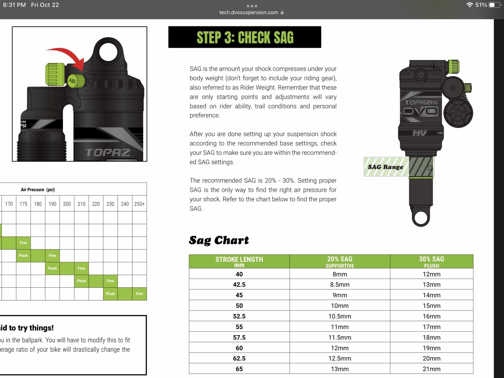

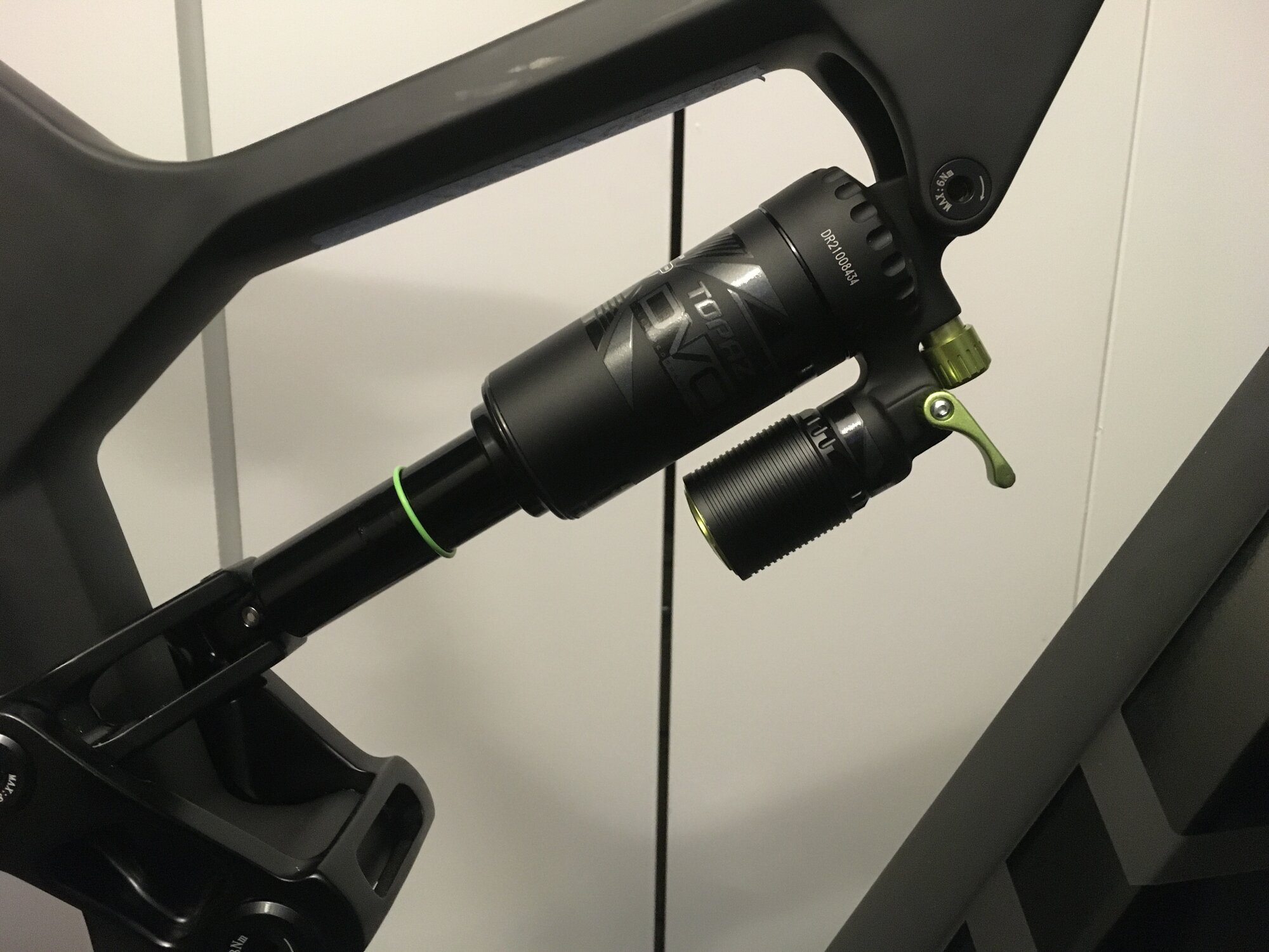

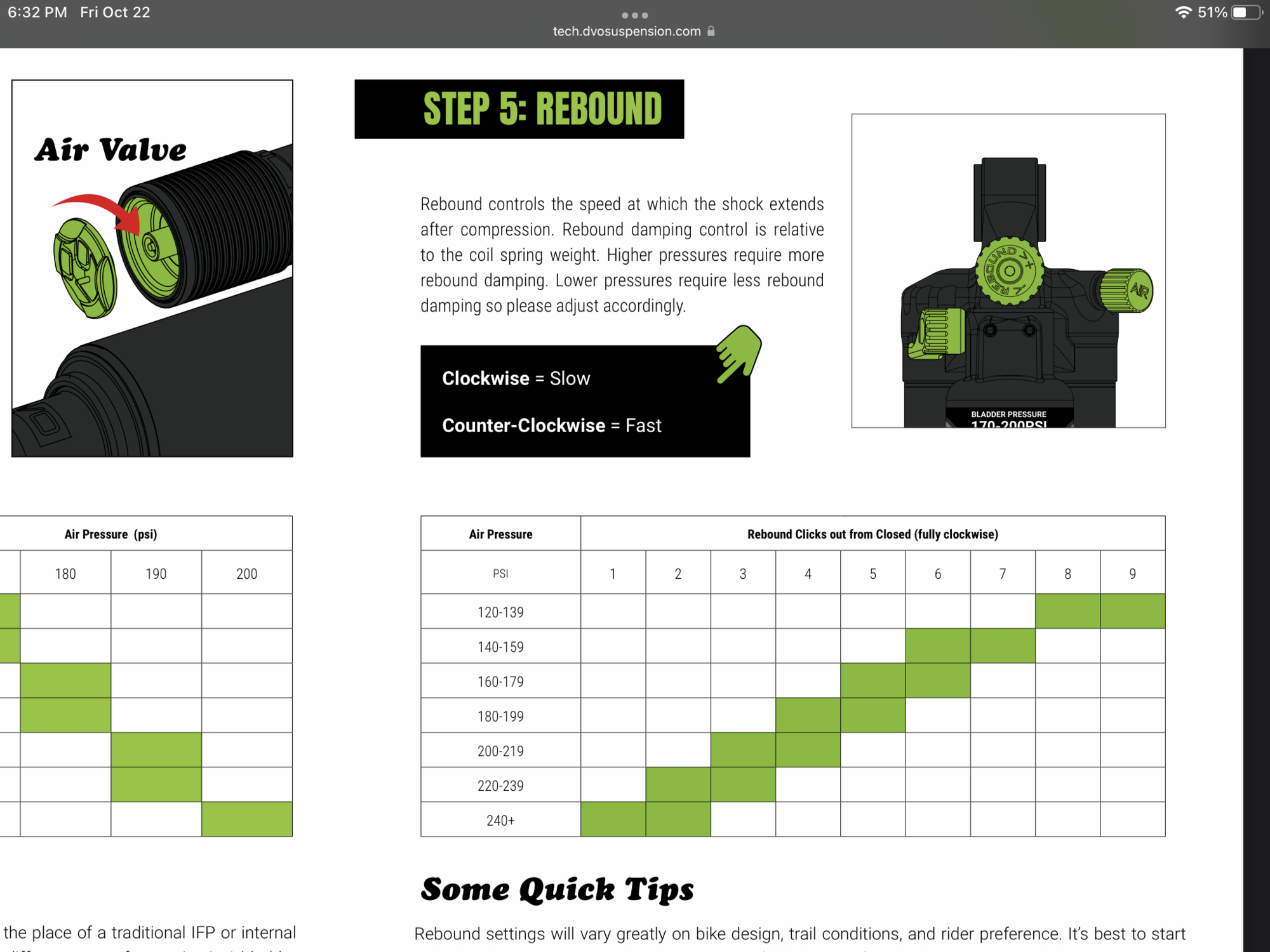

Set up my DVO Topaz T3 rear shock on my Fat Hydra today. For step two I’m using 215 psi as I weigh about 220 lbs. I may bump this up to 225 psi depending on how the bike performs. I’m judging the sag by eye and it appears to be within range. For the bladder I’m using 180 psi. Again this may be adjusted according to performance. Rebound I have set at 3 clicks for now. These are the initial settings I’ll use for now. After a few rides I may make some fine tuning adjustments. Love how easy this shock is to set up and tune.

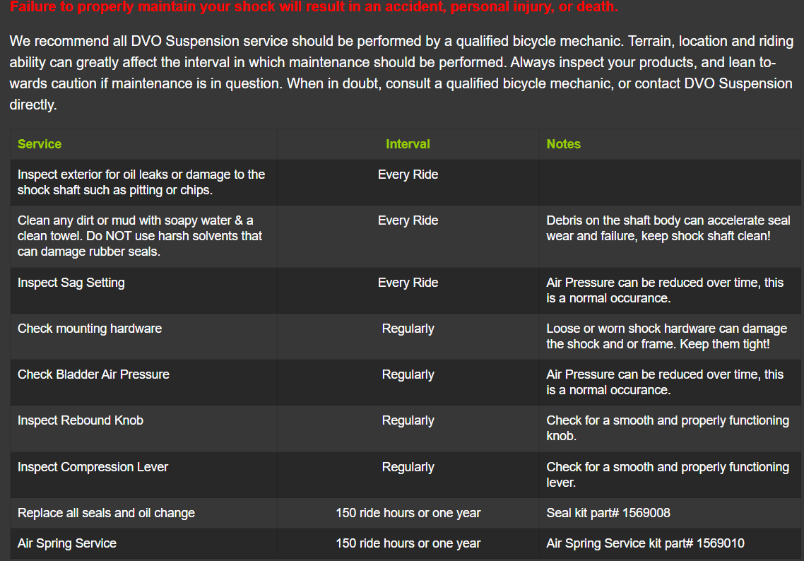

The service manual should have intervals for the air spring, bath seals, & damper cartridge - usually the damper is the longest and the other two are a little more frequent.

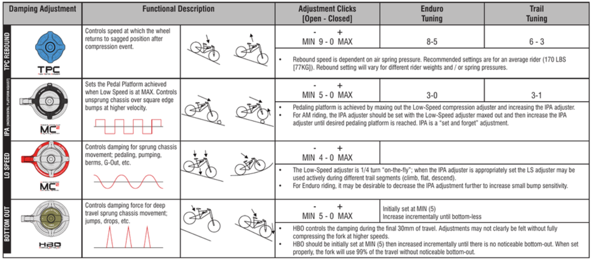

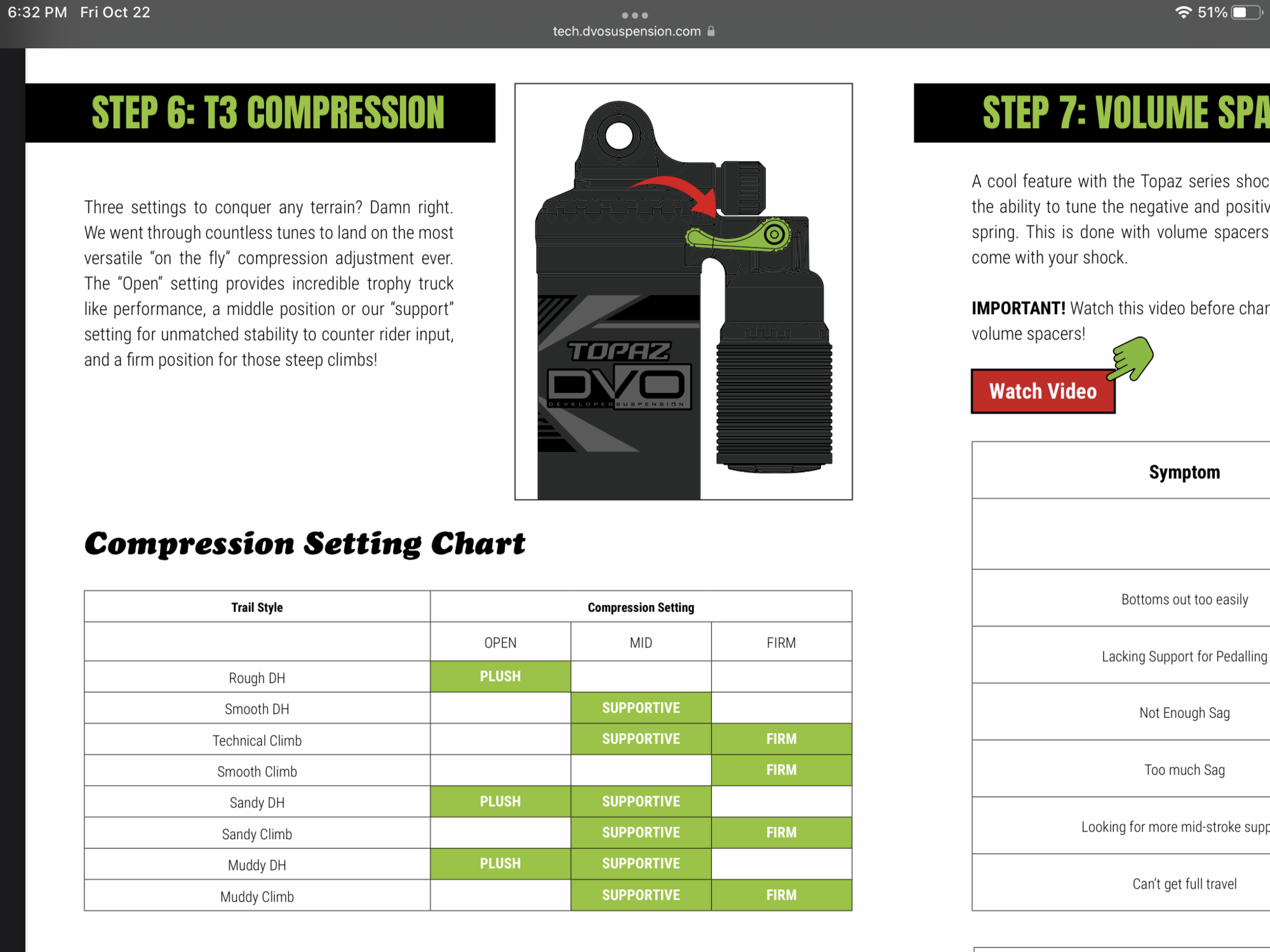

Tuning is just the settings you dial in for your weight, trail conditions, riding style, and comfort - and DVO forks are known for their trail-side tunability with easy to adjust knobs that have clear click indicators on them - I'd love if DVO made a fatbike fork, but they're a much smaller company than Rockshox (SRAM) or Manitou (Hayes). You'll always want to check your pressure each ride & adjust the low-speed compression as needed (on the Topaz this is the 3-position switch, the Diamond has a 6-position dial) for pedaling/climbing/descending & trail conditions.
I don't think the Diamond relies on volume spacers or a second air chamber, but has their 'OTT' setting which along with the air pressure sets the initial plushness, with the idea being it's super soft in the intial stroke (small bump compliance), with strong mid-stroke support & a very progressive spring rate. When setting the rebound, you want it to be as fast as possible to keep the tire pushed down onto the ground without bouncing you up (part of this is the right air pressure). This youtube video shows a pretty good demonstration of dialing in these settings and how they affect your ride
This little illustration from Manitou describes the settings best - they refer to the hi-speed compression as IPA & is the 'set & forget' setting

All the brands usually have a checklist like this for each part - this one is for the Topaz - note the red text at the top that's pretty much on every single bike part :D
This is the landing page for their service guides, including service intervals
I think average price for all the seals for the air spring service is like $20-40 depending on brand/model, the damper service may be a little less for the seals but the cost there is more in fluid (really not a lot) & labor. Idk what an LBS would charge but I know the Cane Creek service is $160-195 for a rear shock and people complain that's a little on the high end. I'm not sure how wholesale customers like WW would receive their parts but buying retail you'd get all the service docs. I'm all for going digital though - less waste and 'functional' clutter that I feel guilty for getting rid of lol. Thankfully DVO & Manitou have great online docs & tech support, when I emailed both of them with questions one answered me outright and the other one said "depends, send me a picture of..." then gave me an answer.

And - another DVO Topaz T3 Air owner now. Not a WW/Hydra but on my X2. Only got ~15-20 miles in on it since install, but it was a noticeable improvement on small bump/chatter compliance vs the RS Deluxe+ it replaced. Two positive volume spacers, 1 negative, 220# main can, 190PSI in piggyback/bladder, rebound 3 clicks from closed - pretty much same as @Cuz Vinny / close to the posted DVO #s for now.
