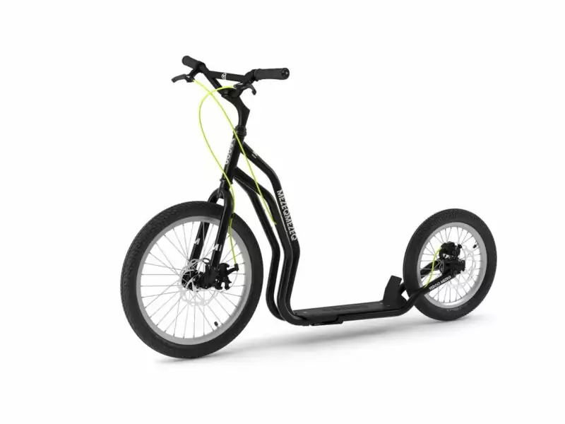

So then I came across this: https://8-elephants.com/collections/off-road/products/yedoo-runrun-mezeq-disc
Mechanical disc brakes, and a 20" up front with a 16" out back on a 100mm axle: perfect for a little 500w geared hub kit, no? I was thinking I'd forego the PAS (obviously), and even the display if possible, and just run the ebrake cutoffs and a throttle, and let him carry the battery and motor controller in a backpack for stealth and security (all the expensive bits aside from the rear wheel go where he goes, and sit in a locker during school, leaving an apparently nice but acoustic scooter behind).

FML... That Yedoo is a Czech product, and the website I found it on for $455 was Singapore Dollars... They do have one US dealer, out in San Diego, which lists none of their products on their website. Le sigh... Guess I'll be shelling out $600 for the 26"x20" instead of the 20"x16". At least that increases our options for motors...

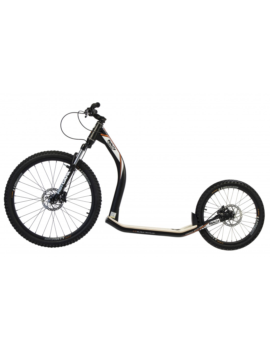

What about one of these Spanish brand Gravity’s downhill scooters https://www.gravity-scooters.com/ they’re imported by a few US dealers but our nearest is in Connecticut, they do a couple of electric conversions but I don’t know if those are imported here

Thanks guys. I did send an email to the US shop, and we'll see what's what. The Gravity M-10 looks awesome, but IIRC their US dealer representation didn't look a lot better than Yedoo's.

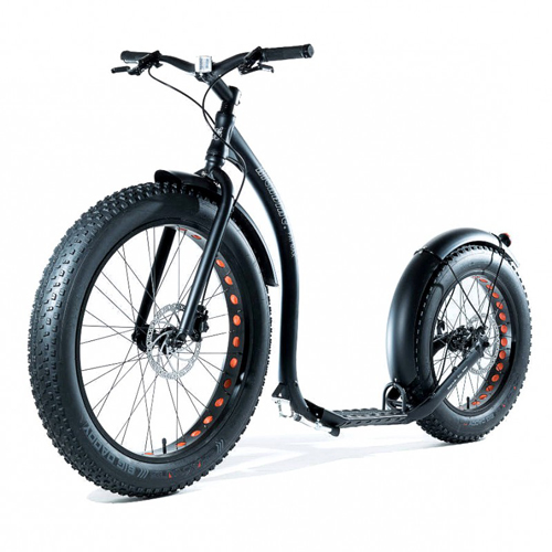

The dream is not dead! Kickbike.com will ship me a Fat Max frame with a wider rear dropout! (https://www.kickbikeus.com/product/fat-max/) I think a standard 26" MTB suspension fork and wheel out front, and a 20" fat tire in the back will slap. Or maybe even go down to a front 24" if I can maintain the geometry with a longer fork like a 27.5...

My favorite is the Gravity M10, which looks obscenely overbuilt and very cool. I could order a frame shipped direct from Spain for ~ $500 and build it out from there. Means buying a front fork and wheel, stem and bars, and brakes. The most expensive and time-consuming option, but the result will be a bike he can ride until he's old and gray like his Dad.
I also got a kind offer from Kickbike to ship me a Fat Max frame. A more expensive option even than the Gravity, and the largest frame of the bunch, but I could run a 20" fat tire at the back, a 29er fork, and a 24"x2.3" up front for that Mad Max / Daryl Dixon vibe. And the Bafang fat rear hub kit goes 750w rather than the 500 of the standard front and rear hubs (although with the right controller they're capable of much more than 500w).

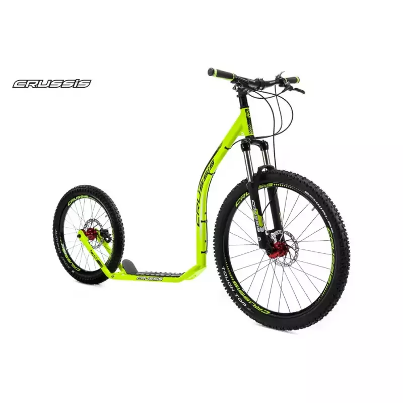

The next contender, and the one I wouldn't have to look abroad for (as someone's imported it for me, already), is the Cruissis Cross. Very similar to a Kickbikes Max 20+, but has the wide rear dropout spacing. ~$700 shipped from Cali., and probably the quickest and easiest to put together.
And, finally, the Yedoo RunRun Mezeq, which is the smallest and least expensive of the bunch. The downsides are that the 16" rear wheel isn't available as a 500w kit from Bafang, and I have to wonder if I'd be able to find short enough spokes to lace one up if 250w wasn't enough. I've set my son the task of deciding how and where he's most likely to be riding, and if he decides he's going to be strictly paths, sidewalks, and maybe a little gravel this could still be an option. He could always get a taller headset if he ends up tall. Still, seems like a toy compared to the other bikes. Maybe I could grind it down just a little, put a 20" wheel out back, and fit a 24" up front...

Very interesting options... my vote is for the Fat Max! ;)
Clyde
IKR? But he'll be riding it, not me, and he's not impressed at all by fat little wheels. Where did I go wrong...?
