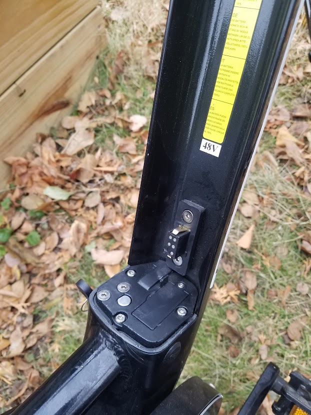

- connect the charger to the ebike frame port (with bat. installed) and power it on ; If LCD turns on, use the throttle (make sure you lift the rear wheel while doing it) a few times ( this is while the charger is still plugged) ;
- try also to unplug/plug back motor cable ;
From what i know the bat., goes into a deep sleep mode after some time( i can look it up online to refresh my internal hard drive...) and u already did the "long press" .
If it is still not powering on, i would open the cover where the controller is, unplug all the wires, plug back.

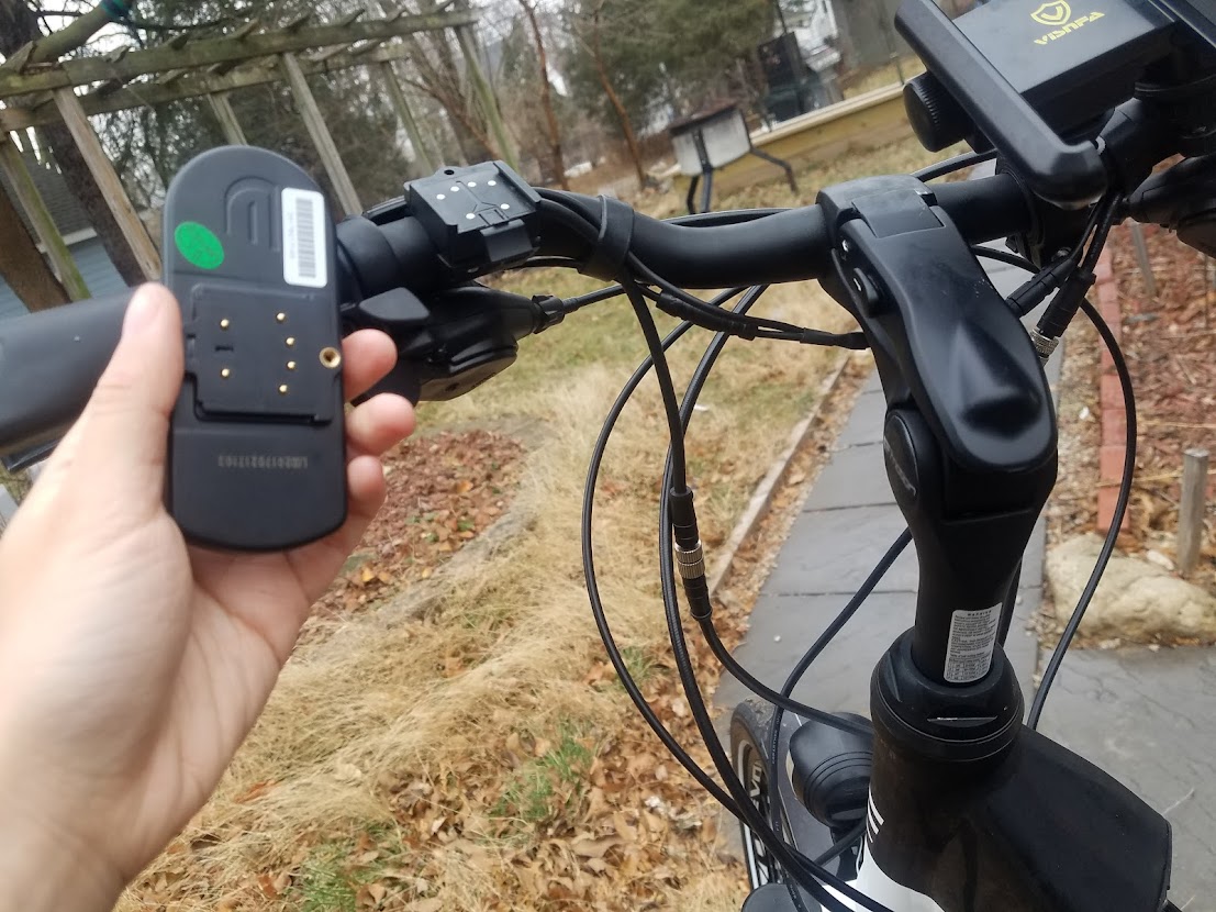

Not the battery cover ! There is another cover once you take the battery out on top , the all the way on top underneath and inside the downtube there is a that's where the controller is and the cover hd four screws and just take that the cover off and that's how you access the controller that's very easy to do , just unplug the cables and plug them back.
- For the display I'm not sure if you have the big display in the center , That is connected to a smaller display on the left side and the small display can be taken off also ; you have to unscrew 2 screws underneath , that is explained the manual; It doesn't say if that smaller button on the left side with the power button and plus/minus has any battery inside, I don't think it does.

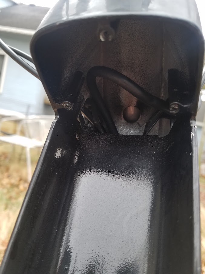

2) I have no idea why it started working again. We had a cold snap for a week, so today was the first day I could get it out and fiddle without freezing my fingers off. I had already unplugged and re-plugged all the connectors I could get to last time, so I wasn't holding out much hope. I took the cover off the top, and it turns out that the controller isn't in there for the Evo Street, it's just wires going down. The controller is probably behind or at the bottom of the battery.
The LCD display didn't seem like it had a battery either. I took it off and put it back on just in case, then unplugged and replugged everything again.
Didn't have any dielectric grease, so I rubbed the connectors, reset the battery a couple times, stuck the battery back in, and tried it out without much hope... and it turned on! The only difference between today and the last time was that last week was extremely humid (lots of condensation on the bike), and this week wasn't. I was also in the garage last time and on grass this time, plus it took me a little bit to find the right screw head for the cover so the battery had some time to cool down to outside temps.

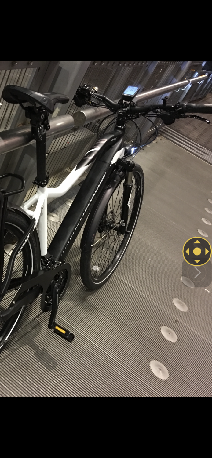

That's interesting I have the controller right there in the top hole and on the bottom i had opened the cover and actually put an AirTag in there ; so you can do that too for safety. I have 3 Airtags on her in diff. places.
That's actually a pretty brilliant idea! I might try doing that with a Tile. How long does the battery last on your Airtags? I didn't think they had a very large range either, like 100ft or something.
I'm a bit envious of your bike having a top-tube. Mine is a step-through and I've found that the weight of the motor hub on the back makes the whole bike somewhat wobbly.
