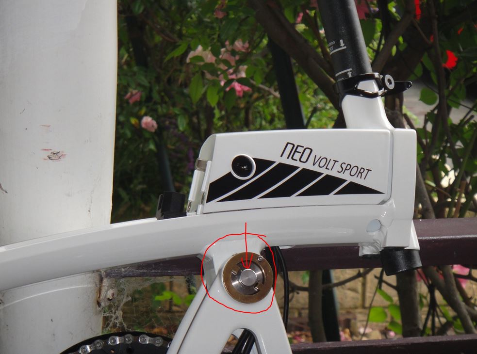

Press the button shown in this picture and try to straighten it. Might take couple of attempts but it's an easy one.

David Herbert
One good turn deserves another request, Lenny. You resolved my question about the folding button, but can you tell me how to buy and fit a twist throttle on my Neo Volt Sport? My bike has the European Pedelec system. I prefer the twist throttle because it saves your butt when you have slowed right down and forgotten to downshift on the derailleur. It makes it easier to negotiate awkward corners at slow speed. And it improves reliability. On my first e-bike, the chain came off and jammed in the cassette. I was able to continue in electric only mode and fix the problem at home. Any help would be welcome.
