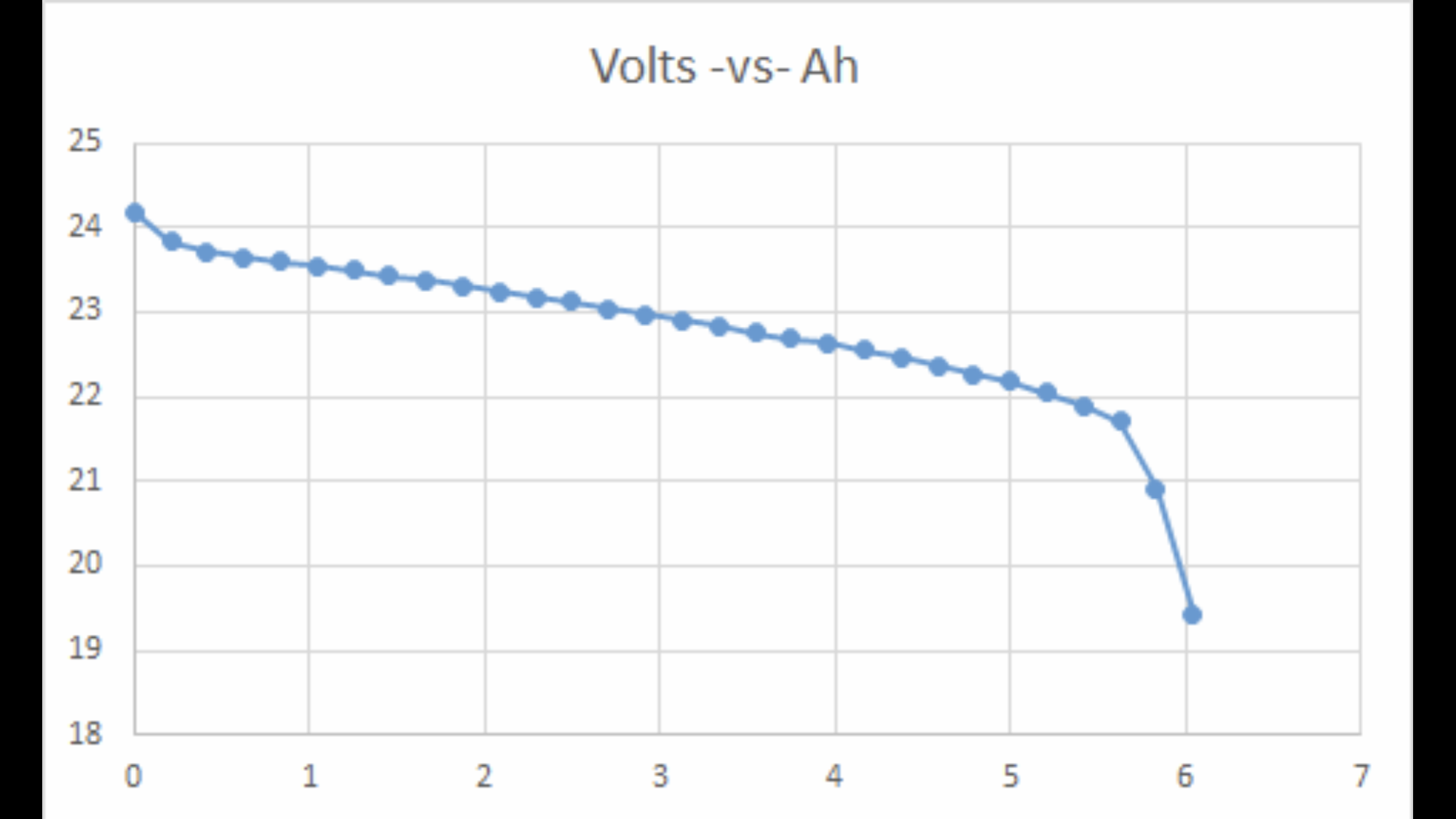

I do know the Okoman 28Ah packs will barely do 6Ah. Measurement below At least I got my money back…. (Falsely advertised)
