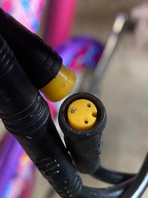

Pinout.jpg It could be something like this photo of a broken pin, if you look closely. Sorry about the spokes I did not see the photo of the new wheel at that point.

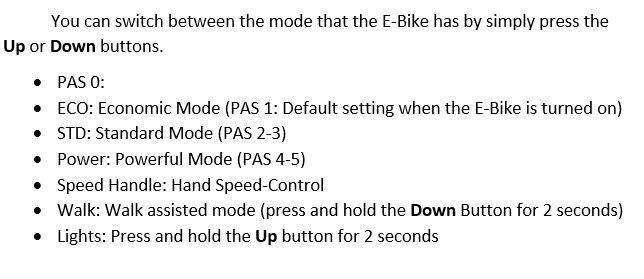

Guys!!! I Got it working!!!! For some reason it doesn't run when the display setting is set on Zero but the other numbers are working and the throttle is working and is giving it power now. So I think its a display setting error I'm going to look over the manual for the SW900 and see what I get. I'll keep you guys posted
JES2020
Okay , great...but that is what I was trying to tell you . You can't have the display PAS set to 0, it turns off the throttle as well as the pedal assist. It's not a display error, but it has trapped many a user.
An engineering mistake, as far as I'm concerned, since you can turn the throttle off by turning off the display, or the battery, do we really need a third, "disguised" way to turn it off???

LCridel
Ahh I finally see what you mean, I'm sorry I misunderstood!! But yes you were right! Thank you so much!
So, like I said before I had it on Zero and that is where it wasn't working. Once I changed the modes it worked perfectly fine. Once again thank you and sorry for the misunderstanding!
