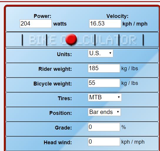

I'll give you a little math. If you fill in this calculator, it will tell you that using 200 watts with an ebike configuration will get you at a speed of 16 mph.
http://bikecalculator.com/how.html
If you bought something like a Prodeco X3 with a 16 AH and 36 volt battery, that is about 500 watt hours (amps X volts). OK, so 500 total watt hours in the battery divided by 200 watt hours, gets you at 16 mph for 2.5 hours. This may seem confusing, but you can work it out.
OK, so if you go 2.5 hours at 16 mph, that is 40 miles. This is a stock bike with a stock motor. These are real figures. I own an X3 and it will go way over 40 miles IF I go 16 mph or so.

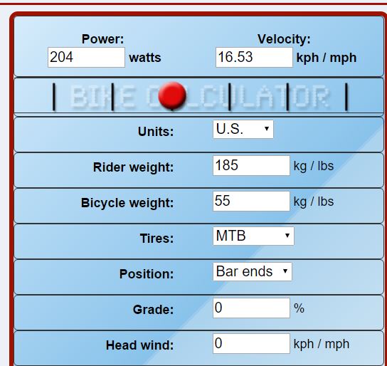

Sorry, I have to call you out for giving completely false figures. Especially since you are giving this advice to someone who has a disability and can't afford to run out of power 10 or 20 miles from home.
500 watt hours will under no circumstance get you 40 miles without pedaling on flat ground or especially under realistic conditions with variation in terrain, wind, and stopping and starting, etc. I have a 1000 watt hub motor with a 48 volt 18 amp hour battery(that is 864 watt hours). My maximum range on relatively flat ground with no pedaling and minimal stopping and starting and with new, fully charged batteries was 18 miles, that's about 50 watt hours per mile. My speed was about 20mph more or less. I weigh only 150 pounds. It is less than that now because batteries lose some of their capacity very quickly after their initial few cycles and continue to slowly lose capacity over time and use.
In my experience a realistic figure is about 50 watt hours per mile with realistic riding conditions keeping it under 20 mph with a healthy battery pack. This may be slightly better or worse depending on the efficiency of your drive system and other factors. You may be able to get down to 40 or less watt hours per mile if you take steps like decreasing your wind resistance by riding slowly or hunkering down, making sure tires are well inflated, accelerating slowly, etc.

I've logged 200 rides with a watt hour meter and on my two efficient bikes I average 14 wh per mile. Average speed around 15 mph.
