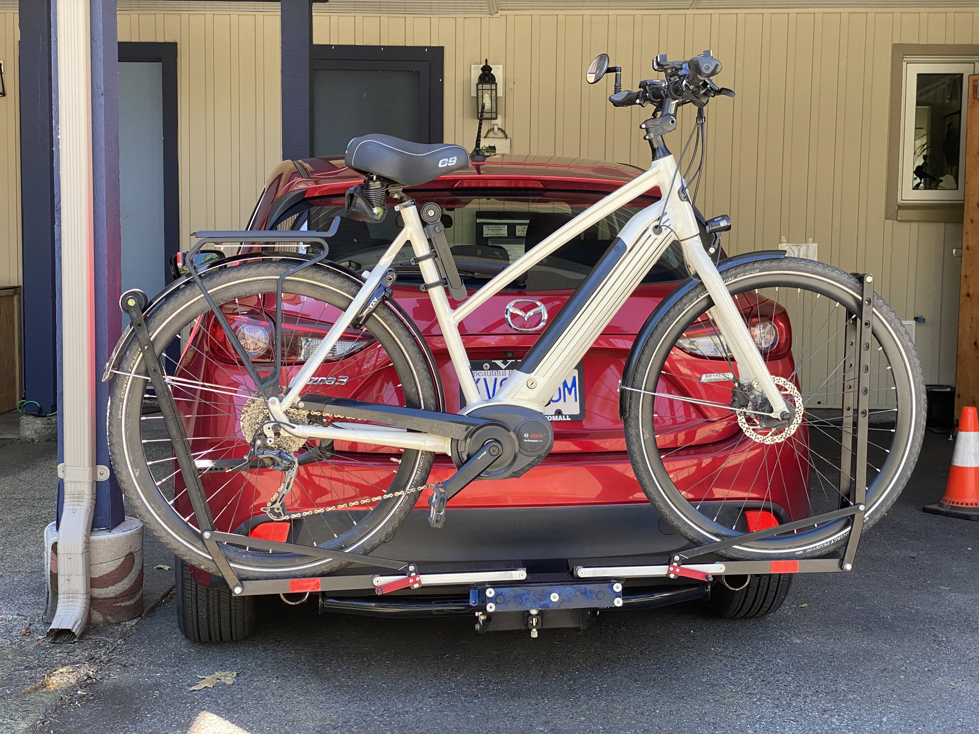

Like you I was totally concerned about whether the 1Up would cause fender damage and found it difficult to get any info on that subject. All I can say is that in my case it's a non-issue and the ease of use sealed the deal for me. I also liked the fact that it's modular so if your only hauling one bike it's not as obtrusive to just leave it on the car. Easy to add a second platform if required. I personally find a lot of bike racks look like laundry hangers stuck on the back when empty........

Hi Surrey Pete,
Thank you so very much for your great info and fantastic car picture! That 1UP looks great on your Mazda 3. BTW, I notice 2 exhaust pipes…a special edition Mazda 3?
I was at a local bike shop this afternoon and one of the employees had a Thule T2 Pro XTR on his Jetta. Like you said, I was not impressed with how huge and bulky it looked (empty, no bikes on it). Actually covered the license plate too, so just a matter of time before the RCMP pull him over!
Mainly, way too bulky…like ‘laundry hangers’ lol. Weight is about 60 pounds too. One of the bike mechanics also said the attachment wheel bracket must be positioned as high as possible on the front tire (just a strap on the rear tire) to avoid a road bump from causing that bracket/arm piece from falling down. So, the bike fender would likely be under that bracket part. That mechanic thought the fender would just pop back into shape once that bracket was released. I would think that would depend on the fender material, aluminum or plastic.
Bottom line, your picture sealed the deal for me. I will be ordering from 1UP and I just hope my Sumas border crossings go without any glitches. I have had my vacs, booster (though not happy about that) due to my serious respiratory issues. I believe it is just the PST and HST taxes that are charged at the border. Unless I can convince a good buddy who regularly stays over for 48 plus hours to bring that across for me. Then, no taxes I believe.

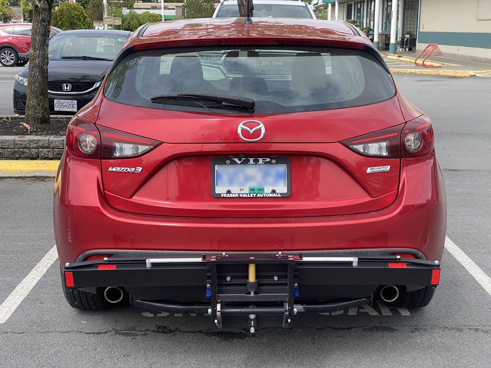

Pete, is you Mazda's hitch class 1 or 2?
I have a Forester with a class 1 hitch and 2 Gazelles with Fenders and trying to decide which rack is best for us. Thank You

The Mazda 3 will only take the 1.25 inch class1 hitch. My Gazelle is just under 50 lbs with the battery removed and I only carry one bike. 1up's site states that each bike ( up to 3 ) can be up to 50 lbs so you would be ok with your hitch.
Not entirely true - we used this one on my wife's Mazda3.

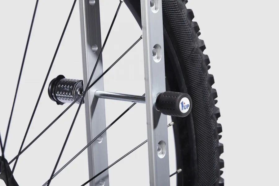

I have a gazelle also. How wide is the distance between the bars that keep the tire retainers in place in the 1up?
Do the rack side connectors on the gazelle get on the way?
How about the stand? Is on in the way ?
I would appreciate if you had pictures of your gazelle on the 1 up rack. Thank You.

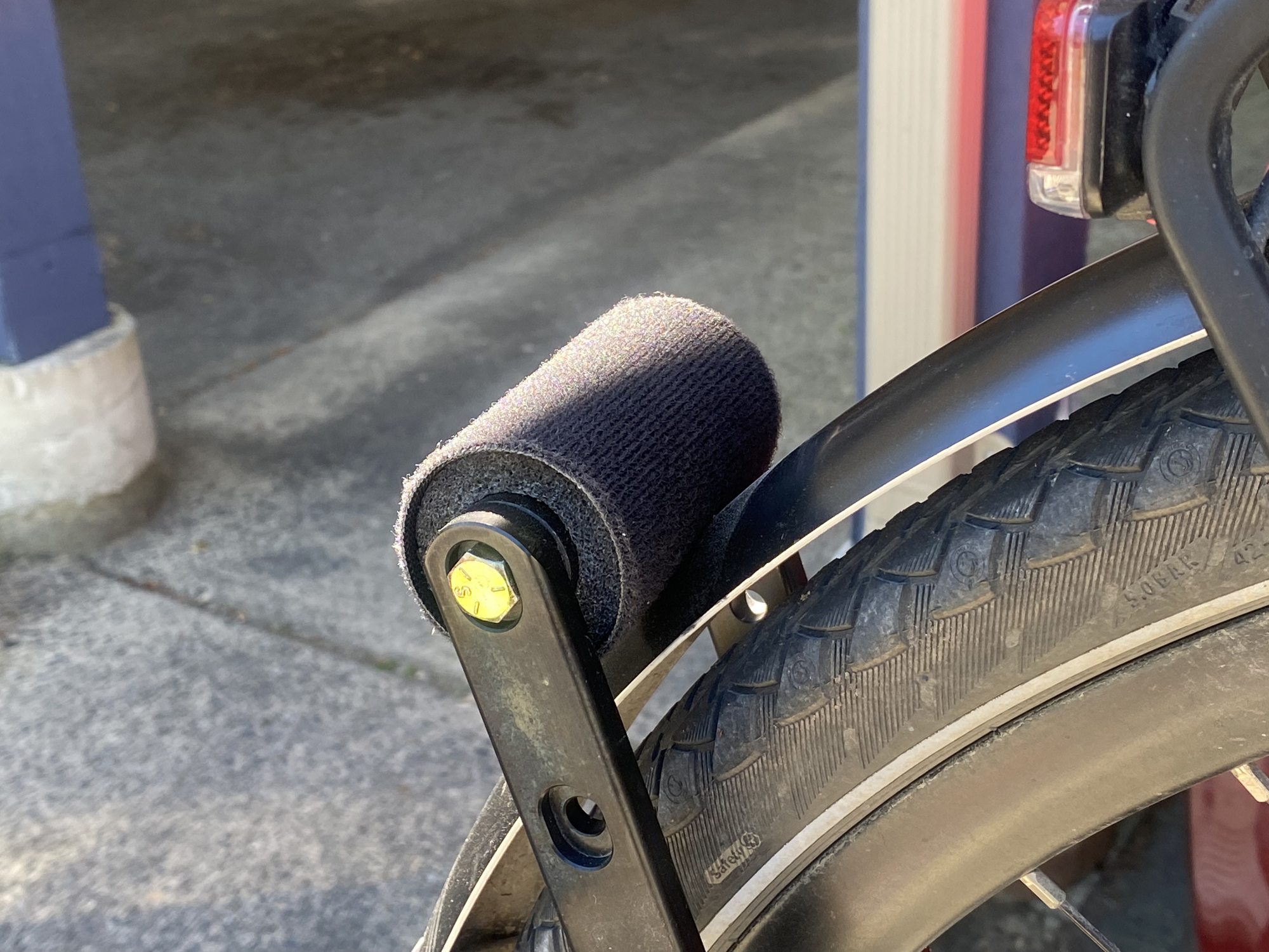

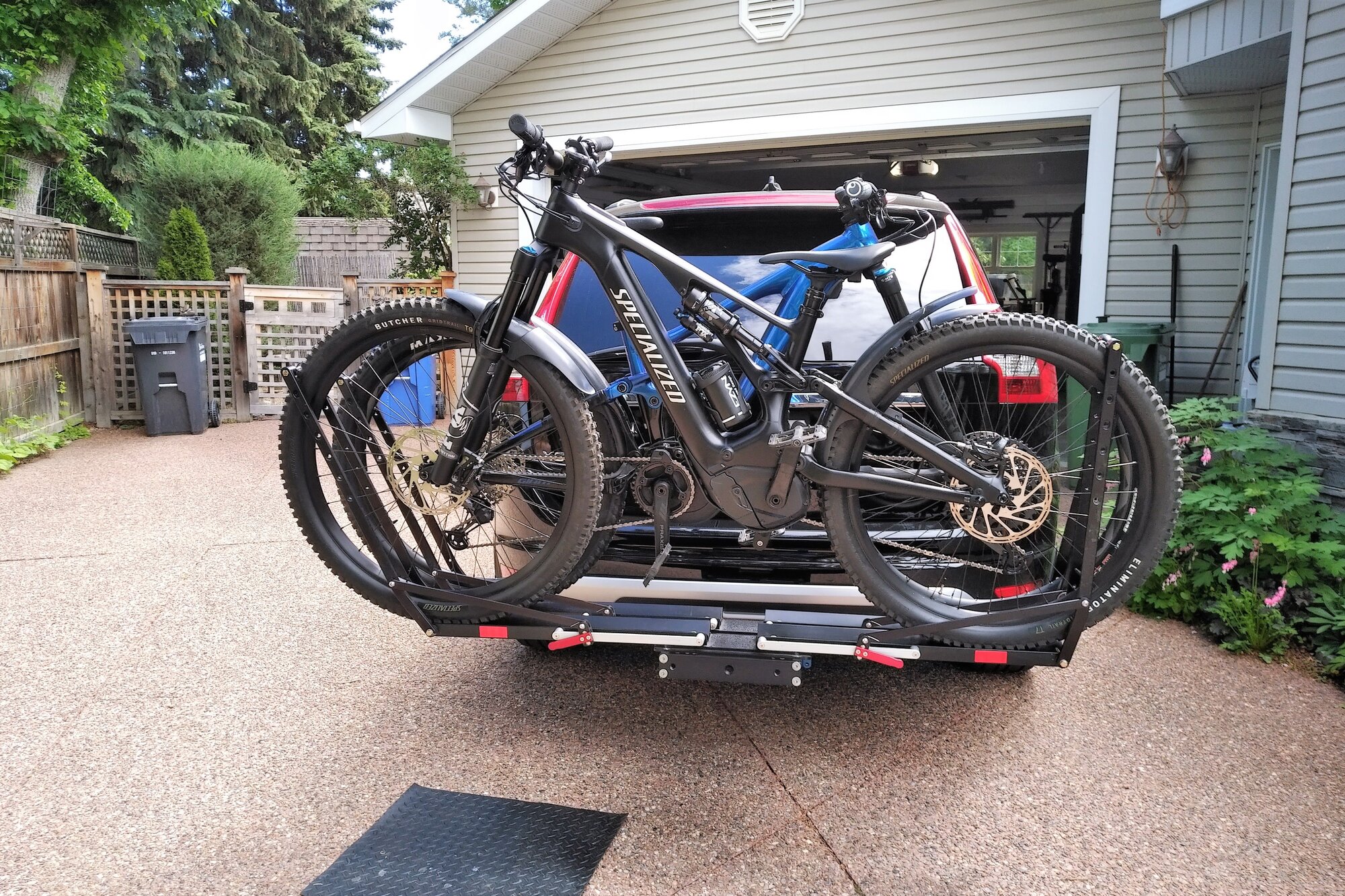

1Up should do a better job on explaining usage with fenders. There seems to be a lot of fender anxiety out there. All I can say is I've used this rack for 18 months with no issues whatsoever. Here are the requested photos. The second one shows the contact with the fender. All the measurements can be found on the site. And yes, you could use a pool noodle.........
Silvercat
Thanks…most appreciated!! Great looking bike btw. Looks like you have a nice handle set up!
I notice the bar on the fender in your second picture. No issues after 18 months says it all, fantastic!
Did your fender dent at all? And did you put light pressure on that fender? Since the front tire is firmly secured, perhaps less pressure is needed on the back tire fender.
