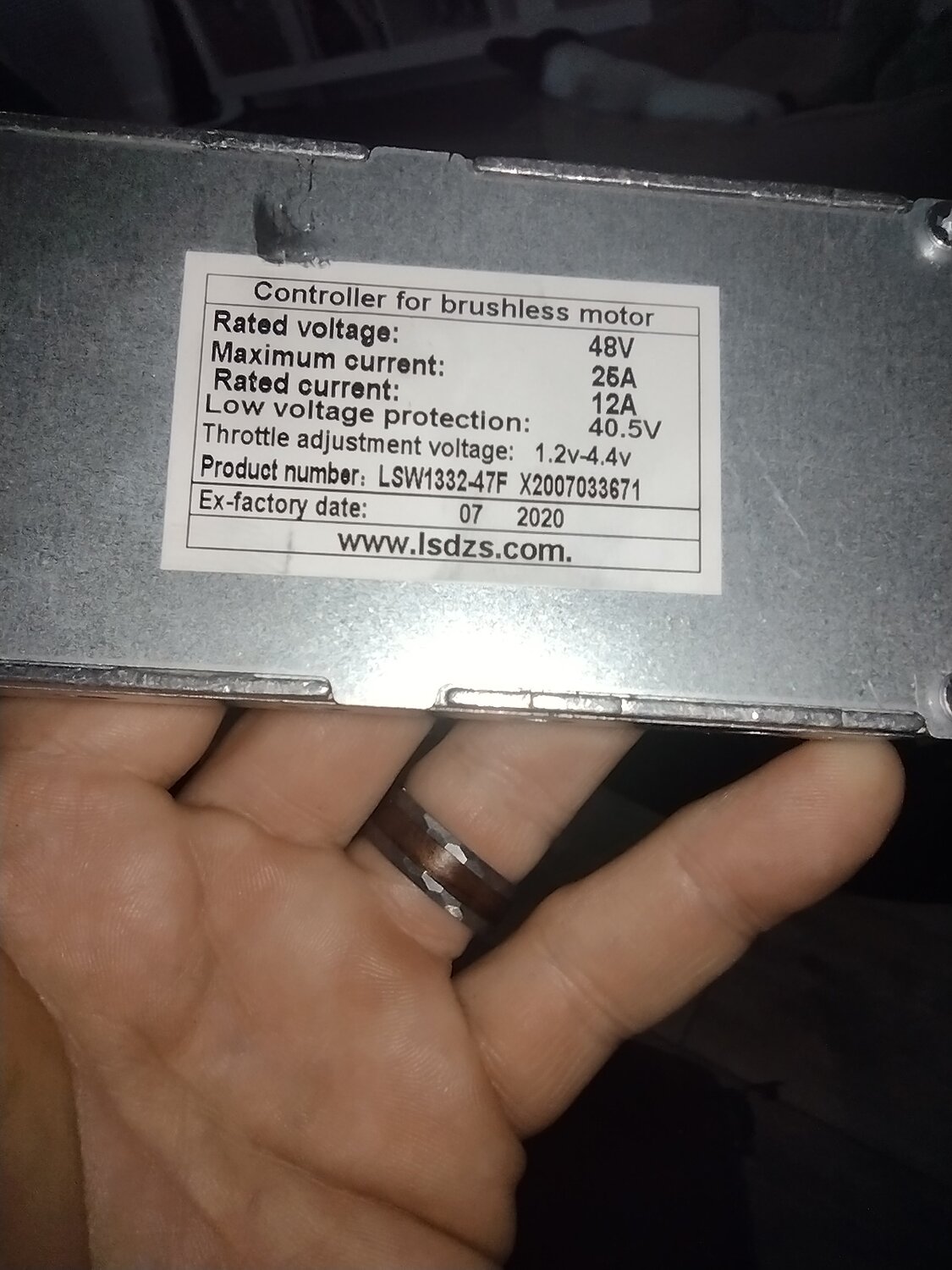

Hi, having a real issue with my revi cheetah. The throttle when engaged withe on it, just makes the bike chatter and pulse a bit. Battery is full charge. I rode it the other day and it was fine, now it's just not. I've tried to trouble shoot everything. I purchased a new throttle and plugged it it but didn't work either. If I pick the bike up by the seat and twist the throttle all I can get is 9 mph or so on the rear wheel. But if I sit on it, it won't move. Brakes are good ECT. Is it the controller? I'm super confused. If it is, where do I get a replacement. Thanks everyone

You no doubt have a phase failure, either in the motor or the controller (or connection between the two). I presume you've checked the connections to the controller and the motor?

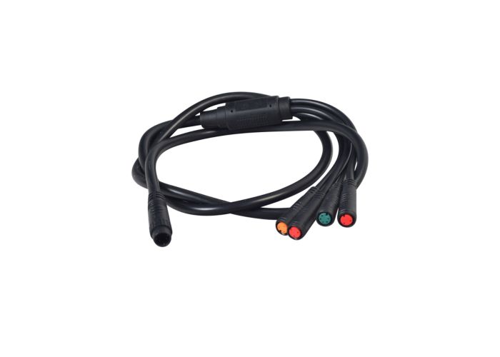

Yes, all connections have been unplugged and checked. These bikes are all new to me. I was putting higher handlebars on it because I'm tall and before I did that I wanted to check the connections to see what I should order for extension. Of course I haven't done that work yet with the handlebars. I just pull all the connections looked and put them back together so I had a better understanding. This is what I get for fooling with it LOL. I'm pretty savvy on things I just don't know what this one's all about. I tried to send a video of me holding the magnet and the axle while my wife hit the throttle to show it just stutters. How is a phase failure fixed?

Those connector pins are small and easily bent or broken. Might want to pull them and check they are not damaged and slotted correctly together.
Bobdudeman
Will do, ty. Especially on the throttle I'm sure. I also bought a new throttle so it must be the pins that the throttle goes into? Not quite sure
