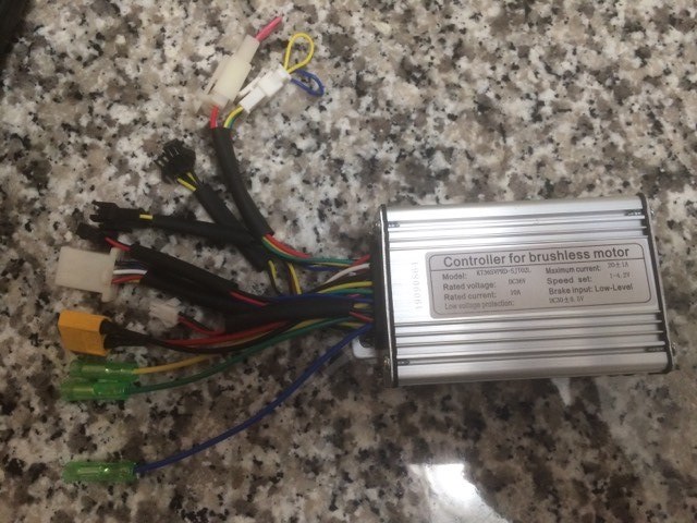

Next, here's a KT controller, very similar to the 20A sinewave controller I used. You would buy it with a compatible LCD display. While it has the same connector functions, most of them will use a different plug and the wire order and wire colors might change. WHile you can use any KT controller, you might want one that fits in the original compartment on the 20" fat tire folding ebike, That would be the smaller 17A and 20A KT controllers.
45436
To keep the bike connectors untouched, the connectors on the KT controller are changed. I would recommend buying the next set of connectors. This would be
-one 6 pin JST connector (female),
-two 2 pin JST (male) connectors,
-optionally two 3 pin JST connector (male/female.)
These are usually sold with both male/female pairs, with leads attached and in bundles of 5 or more. You can actually re-use the 3 pin connectors from the KT controller. Described below.
The project involves cutting off connectors from the KT controller, and splicing in different ones. It involves electrical skills like soldering and insulating wires. It requires electrical knowledge, as there is high power DC voltages in your ebike. Remove the battery before you do anything.

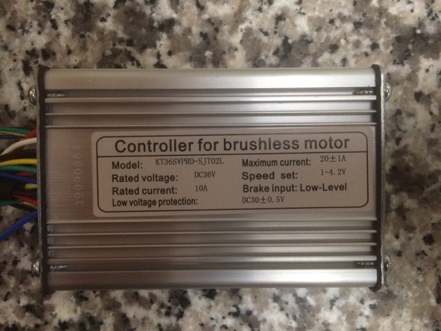

Just finished my 810LED upgrade. I used a KT36SVPRD-SJT02L controller with the KT LCD3 display.
I tried to order from PSWPower, but their checkout wasn't working for U.S. shipping. So I ordered from Amazon.
The PSWPower site is currently working again by the way.
I only had a couple minor problems during the conversion. First the JST connectors that were ordered from china had not arrived, so I swapped the motor connector from the old controller. The problem was that there wasn't a pin for the white 'speed sensor' wire, so I soldered in a tap to the bike side wire and connected it to the KT wire with a pair of spade terminals. I can fix it when the new connectors arrive. Other than that, I swapped the PAS and Throttle connectors on the KT controller and changed the battery connections to spade terminals. The brake connections matched up perfectly
The biggest problem was getting Pedal Assist to work. Long story short, I had to set C1 to 00.
Apparently my bike has a 5 magnet PAS sensor; none of the other settings woulds work.

Rynerr here are the links to the KT36SVPRD-SJT02L controller with the KT LCD3 display that I bought:
This controller is 36v only, the one HarryS used is the KT36/48SVPR-20A and is for 36 or 48v and is at this link:
They both are the same size wired exactly the same, so if you ever want to switch to 48v I would suggest the pswpower one. Also, HarryS has posted and replied to a couple other posts about this same mod:
