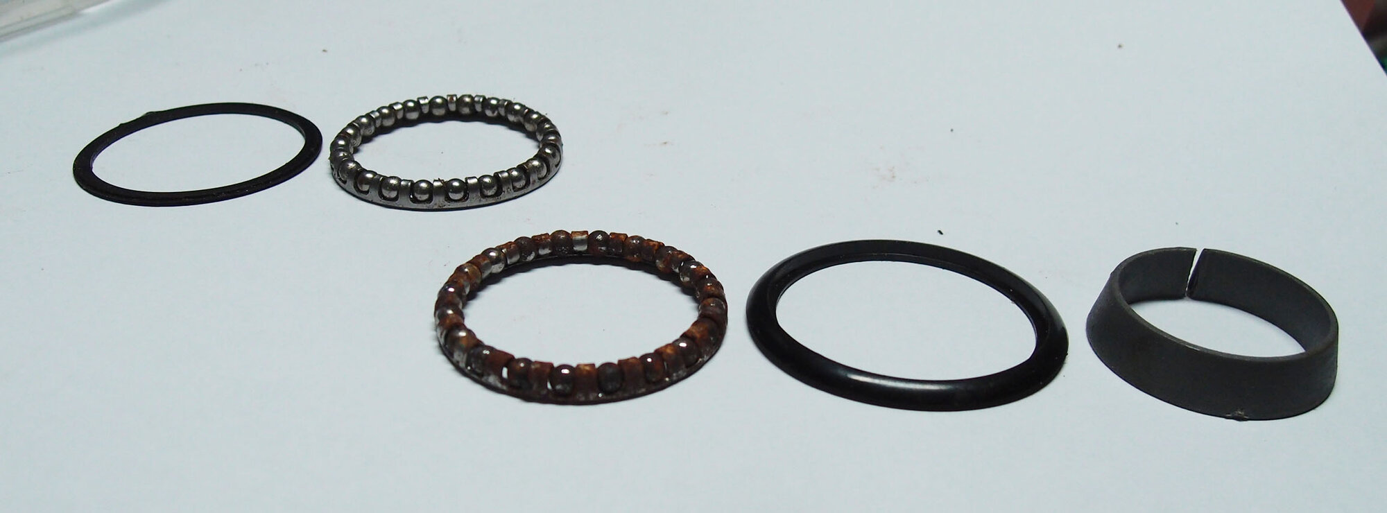

Some loose parts I had laying around. Top two are bearings and plastic seal from the bottom.
Lower three are the bearings, a plastic seal and a cone from the top. These are under the steerer collar that is held with two side blts plus the cap with the center allen bolt. Hard to lose, unless they were never there, because as far as I remember, the steerer comes installed on the 20" folder.
Also hard for a bike shop to miss, if they really saw it.

Can I buy those bearings from you ?
Hey, they're rusted.
You can buy a headset for under $20. 1 1/8" threadless to get bearings.
But you should look to see if anything is missing first. A bike shop will sell you what you need.
