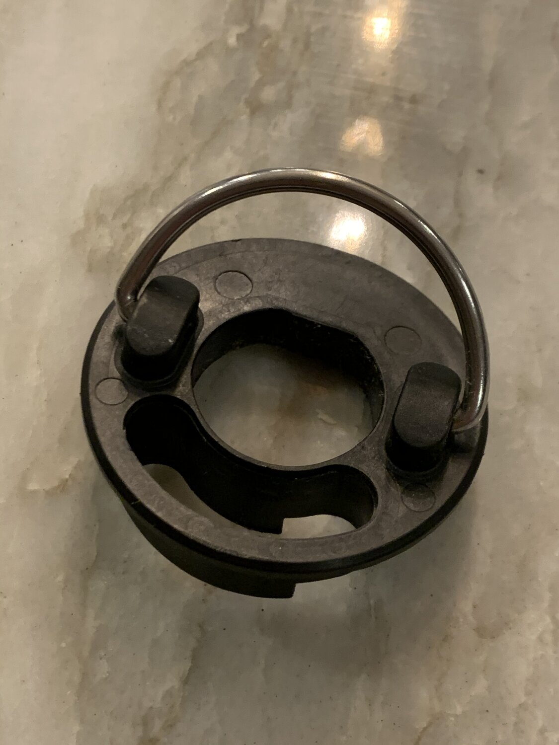

This thing appears to belong not the rear hub. Should it be in place when installing the rear wheel or what? What’s its purpose?
See first attached photo.
Okay - I realized what I was supposed to have done with this thing! Apparently, it goes on the wheel prior to plugging in the battery / control cable. Presumably, this is to help remove that connection. Here’s hoping I can still get it off!!

THAT FIRST PIC IS A VERY IMPORTANT PIECE! It is the mechanical quick disconnect that basically connects wiring into rear hub motor.
I thought wires were affixed to that piece and as you removed rear wheel, that piece along with wires stay with bike, and wheel comes off.
‘then, when wheel goes back on, axle goes through that piece, and that wire handle kinda cam locks it in and holds wires where they need to be.
without that. Wire connections would/might not stay in place. That connection must be sorta loosely made now. But sounds like youre riding the bike now.
I would say get that figured out ASAP.

@fxr3 yeah, I did a sub 60s spin around icy, salty roads at 10p last night. After reading some more of the manual last night, I realized my mistake regarding that rear hub piece. I’m curious if the function of that piece is to securely hold the wires onto the hub or make it easier to remove them!?!
In any case, the shop I bought from includes up to $100 for assembly / tune-up. I’m going to take them up on that at my local Stromer dealer to install the Omni-C upgrade, adjust the brakes and look things over.
