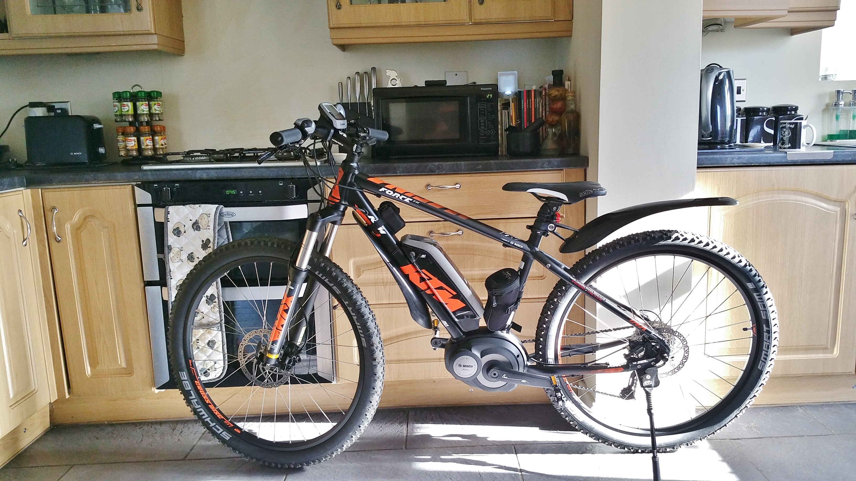

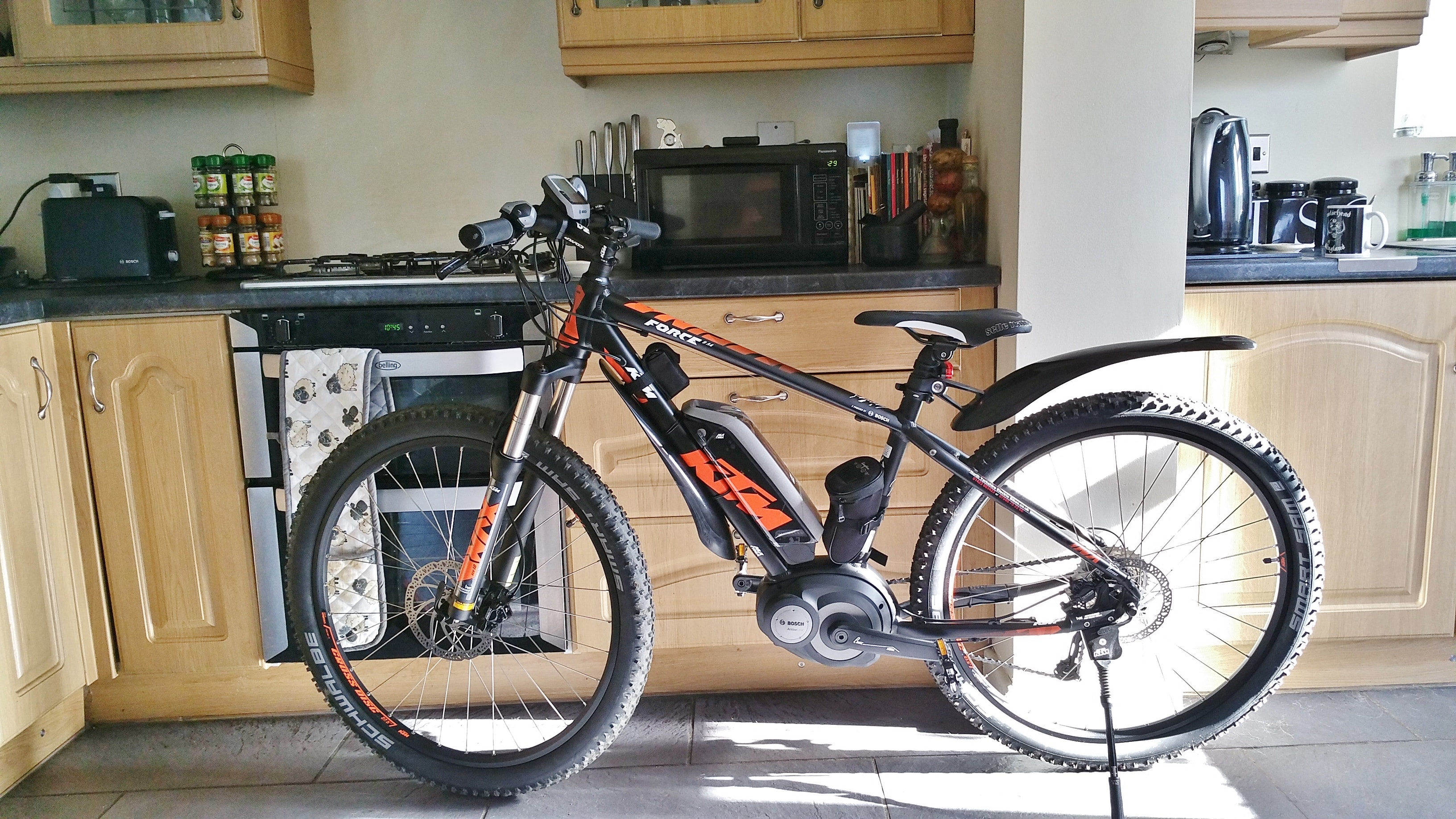

Eddy Rush
Hello chaps!
Just a quick update to this thread to let you know that the bike arrived this week and I couldn't be happier with it :)
Thanks to everyone that left advice and comments - it really helped me to make a more informed decision.
The bike is a KTM Macina Force A4. It only has the entry level Bosch Mid-drive Active line system fitted but it's more than adequate for my needs and really does make a difference on those steep inclines.
I feel like a little kid on his first bike again.
Eddy Rush
Congratulations! Be interested to read your impressions of the bike climbing hills.
It's better than I expected, really impressed with it.
Sport mode was more than enough to help get me up my local hills but with Turbo mode it was like going along a flat road. I switched assist off mid-way up and really noticed the difference.
