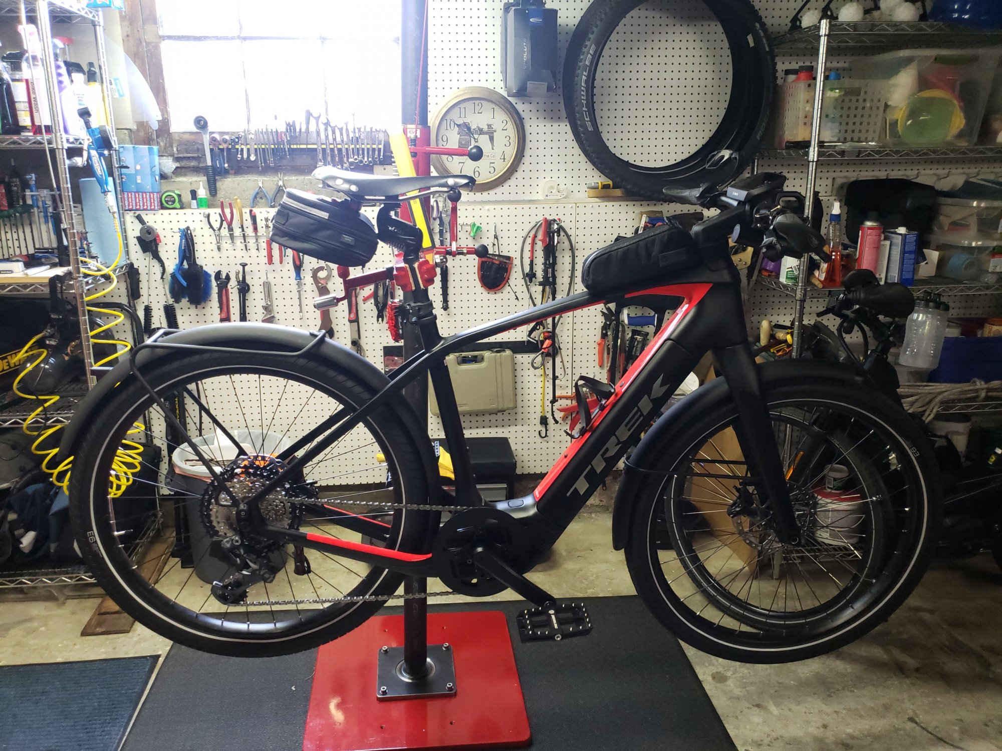

This is some different kind of bike. I am accustomed to riding Riese & Muller full suspension bikes with heavy frames, cushy suspensions, solid performers but 70-80 lbs. all geared up.
This carbon fiber frame rigid fork, hardtail weighs about 20 lbs. less than my other bikes. It is way easier to manhandle up the stairs from the basement. The Allant is more nimble than the R&Ms both because of its weight but also due to its different geometry. It steers quick and agile, easy to ride hands free, with great balance. It came with the Shimano 10-51 Tooth 12 Speed Cassette (which was superior to factory spec, 10-45) The 625wh battery is a bit a beast, quite heavy really. I am curious to see what kind of range it will deliver.
My modifications to the bike are as follows:
  • Sram AXS X01 Wireless Electronic Shifter and Derailleur
  • Baramind City Shock Absorbing Handlebar
  • Kinekt Body Float Seat Post
  • SMP Avant MTB Leather Saddle
  • Catalyst Flat Pedals
  • Abus Bordo Alarm Lock
  • SQ Lab 702 Grips
  • Selle Itallia Rear View Mirror
  • Knog OI Bell
  • Quad Lok Phone Holder
  • Tannus Armour with Tubolito inner tubes.
  • And of course a Bosch Nyon Display (it came with the Smart Phone Hub which I had replaced with the Intuvia mount to accommodate the Nyon)
The bike looks fast just sitting there with its matt black, brooding presence. The glossy signal red accents really add a great deal to the dramatic and speedy overall look. The solid alloy fenders ad some weight but are so much more substantial and well fitted than the SKS plastic ones so much in vogue these days. All stays are solid rod with one screw hole, no adjustments, just a perfect fit. The stock lighting is surprisingly good, so much so that I am not thinking of swapping for the Supernova. There is a bright low beam with a very sharp, horizontal cut off on top and a plentifully bright high beam with orange side lights on the front and a compact but quite bright pulsing red light aft with red side lighting in the stern.
It is quick off the line with the new Gen 4 High Speed motor giving nearly as much off the line performance as a gen 2 CX. Where it really shines though is at speed. The added torque seems to make its presence known about 22 mph making it easier to sustain 24-27 mph on flat ground in sport mode than it is in turbo on my Homage Rohloff with the Bosch HS (28 mph) motor. If I shut down assistance at 27 mph, speed starts coming off the bike but I can still keep it going on my own at around 18-20 mph with reasonable effort so the motor disengagement when not in use is a real plus. This bike can cruise, smoothly and with grace. It begs to be ridden.
The motor is makes quite a bit more noise than my Gen 2s, especially at the higher assist levels, sport and turbo. It is my understanding that the nylon gears used in the earlier generation motors have been replaced with metal gears. I have heard that they do quiet down over time and use. Let's hope so. While the bike looks quite stealthy and is probably one of the better integrated, less ebikey (is that even a word?) looking Flat handlebar bikes available, its sound track is a dead giveaway right now.
Coming off of two full suspension bikes to one without even a front fork was not a problem. With the Body Float seat post, Baramind handlebars, 2.4" tires with Tannus Armour with 24 psi front & 28 psi rear and Carbon Fiber frame the bike is amazingly compliant, quiet and is as sweet a ride in all but the bigger, deeper road flaws. It does require posting up over the big stuff, more so than the full Fox suspension on the other bikes.
I bought this bike to fill a niche for more localized, less touring, more sporty rides, rides with my roady buds, running light errands and vehicle replacement. My Delight Mountain is going to lose its fenders and get it knobby tires back and spend more of its time off pavement. The Homage will be the touring machine, with its dual batteries, great carrying capacity. It will be the overnighter. I won't be doing any N+1 for a while...and maybe even a minus one sometime soon?
I hope the weather allows me to ride the Allant regularly and get more familiar with this fantastic ebike.
The only photos of it that I have so far are on the car rack picking it up from the Trek Shop and sitting on the stand being worked on in the basement. I'll try to get a few out on the road over the coming days.
