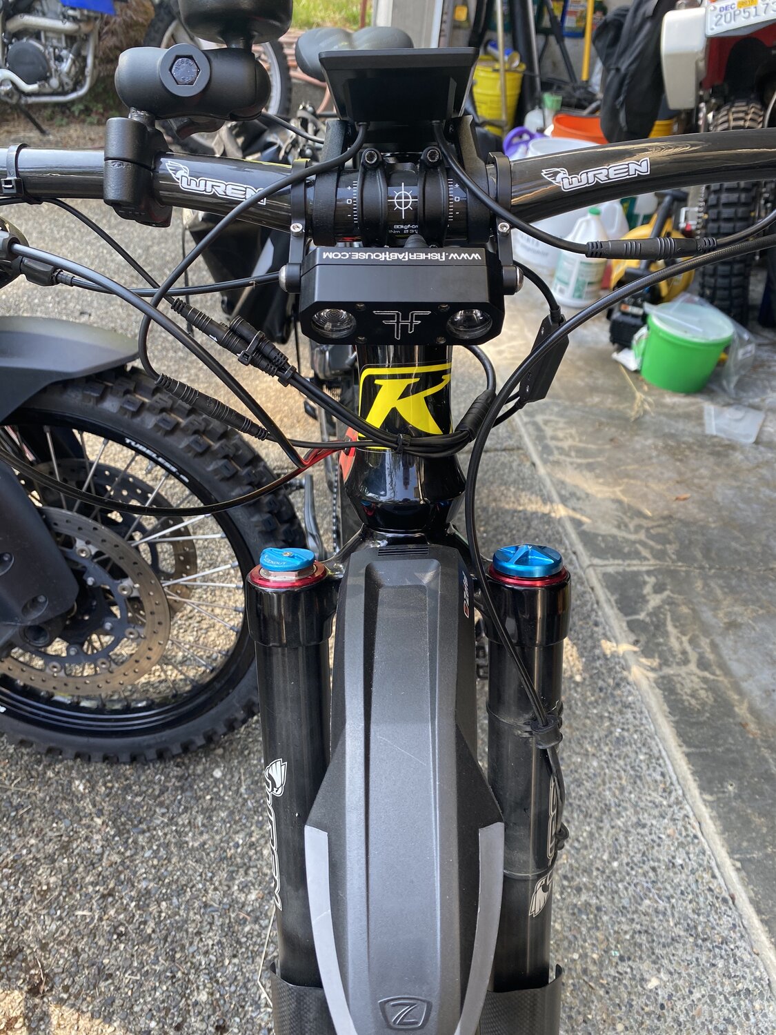

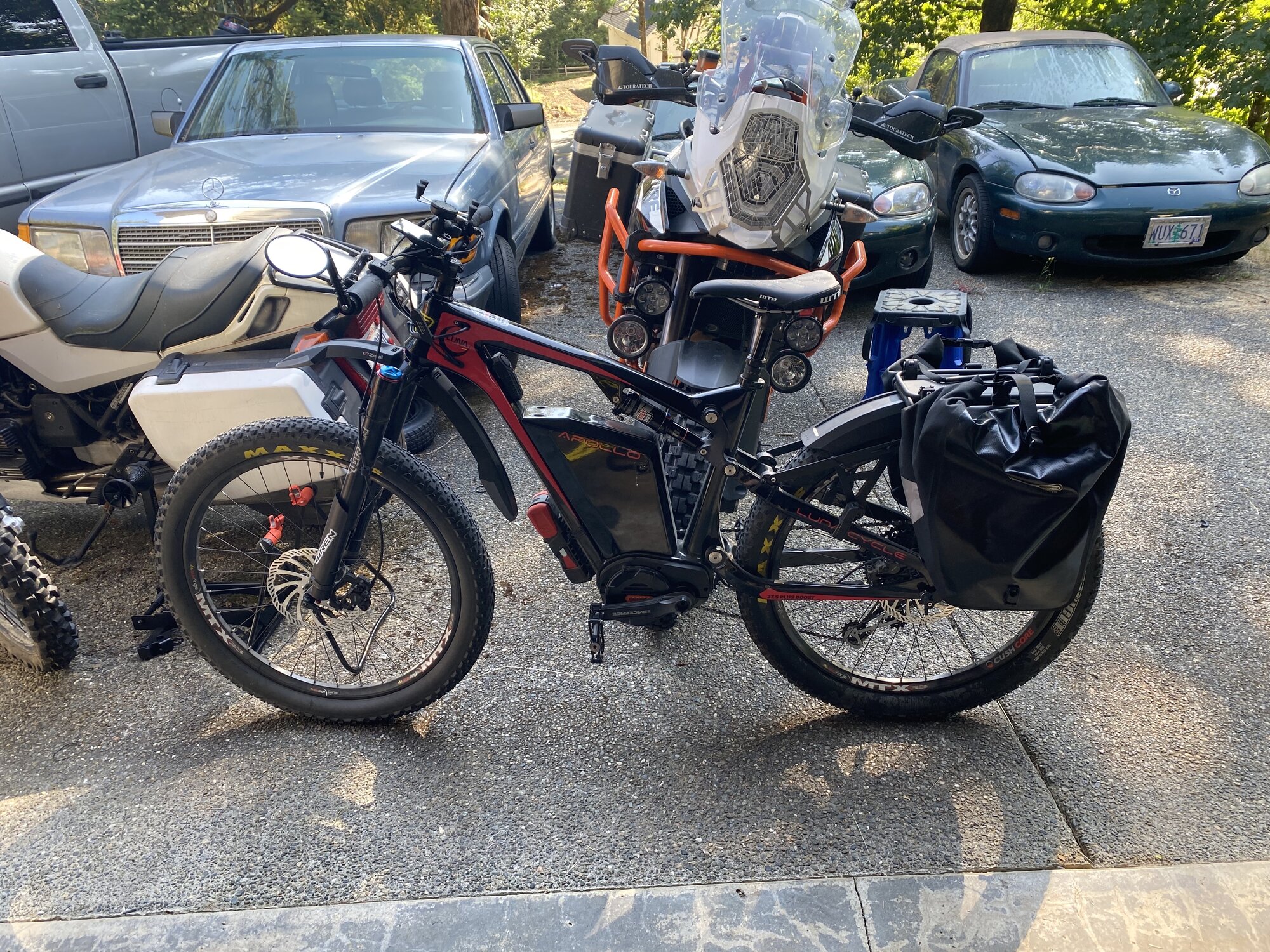

I went straight to the battery with my headlight. Here an ugly picture with the state of my build. I updated to the Archon 1 this weekend. Looks like the source of the light is updating his website but it is Fisher Fab House for about 3500 lumens with one beam and one flood. I will do a night shot if anyone is interested.
If you can see my KTM acting as a kickstand, I am a big believer in seeing and being seen. The adv moto has 65000 lumens :)
If you can see my KTM acting as a kickstand, I am a big believer in seeing and being seen. The adv moto has 65000 lumens :)View attachment 61292View attachment 61293
Wait a freeking minute! I owned and rode a big KTM for a couple years around '08 and '09. Rode with a lot of guys who rode KTMs. What the bloody heck is that thing behind your Apollo? I dearly want to know and I really really need to see more pictures.
