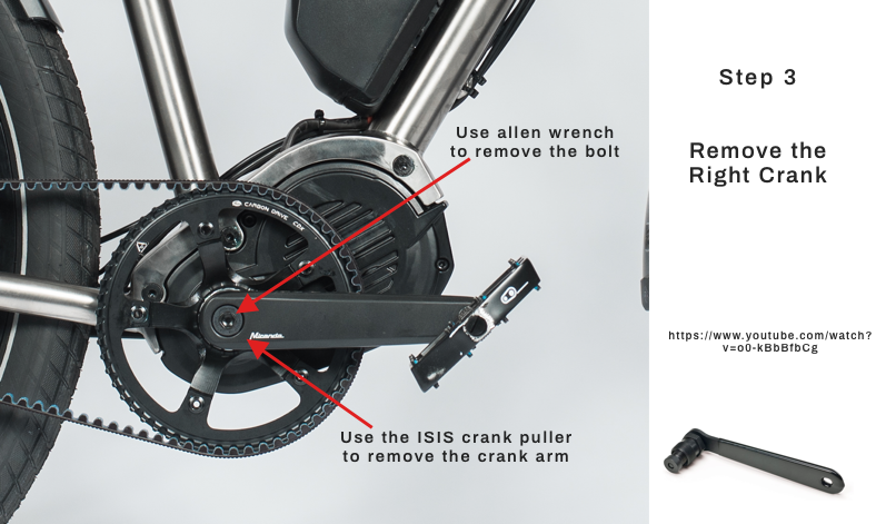

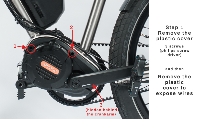

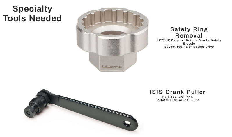

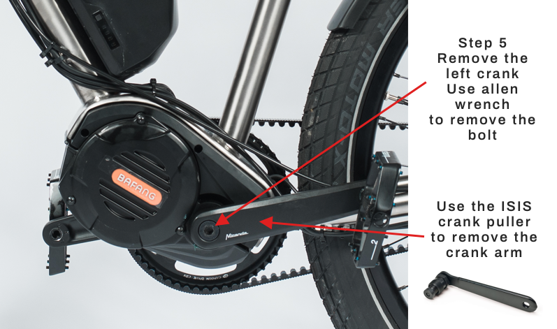

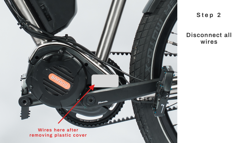

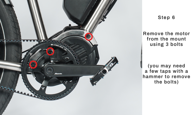

I am about to put up a landing page but here is the process
Tools -
1. Safety Ring Removal tool (updated with link from tom). Here is the Lezyne tool link
2. Park Tools ISIS Crank Puller
3. Youtube video link
I got most of this from the Brittish guy who posted his motor removal that certain WW enthusiasts must have missed before they pulled their motor. 😁 I have two questions:
1. What I have questions about is the wiring. Lots of plugs to deal with and this is what 'worries' me. Can their be a wiring tutorial or explanation?
2. Also I am unclear on this 'cable' subject. Guess this is only needed for cutting back a 2300 watt configuration to 1000 watt and for future upgrades. Does this process involve a windows computer? I'm a Mac person and have never used a windows machine. Could someone clear this up for me?

1. Wiring is actually easier than the motor removal. I’ll add a picture but there is only one way the cables will go. Each male / female set is unique so there’s only one way the wires will go. 😀
2. I have a Mac too and you can use windows in virtual box and it should work as long as you give usb port access to the virtual machine.
