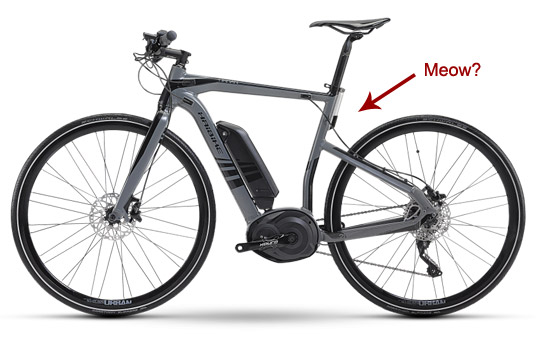

They're all pretty nice... Interesting frame design they chose however, is it meant to be iconic or artistic? Instead of meeting the top tube with the seat stays they put them lower down to create that distinct angle (which seems like it would be weaker).
This design also makes it harder to stand over the bike if you have short legs... and subsequently rack yourself :) It does have a distinctly masculine, male sort of look to it. Any thoughts on why the frames are made like this Chris (or anyone here with bike structure knowledge)?

I would totally love a discussion about frames and design. Thanks court.

I'm pretty sure this design is mostly for looks. It does give a pretty nice area for the placement for the taillight. I haven't gotten any official word from anyone at Haibike, but based on my understanding of frame design and metallurgy I have a theory that this design could add to the comfort of the frame without loosing performance. It seems by placing the seat stays (the top part of the rear triangle) lower it will enable it to take advantage of the flex of the seat tube, offering a balance of performance and comfort. The flex is most likely minuscule, but it would help smooth out the road. This is one the same reasons why road bikes have really thin seat stays. This is just a theory, but it seems to make sense in my mind.
Regarding the stand over height issue, Haibike seems to have solved that by offering up to 5 different frame sizes, I'm hoping other ebike brands start following suit. I imagine they will as the market grows more over here.
Regardless of anything, I think it looks really cool :)
Indeed... Expert comment there Chris and I appreciate how you called out the wide range of sizes they offer. Feels like the next step in ebikes for sure. Anyway, your comment made me think of the Specialized Roubaix which has those Zertz in the seat stays (and very thin tubing surrounding them) to provide exactly the kind of flex you're talking about.
