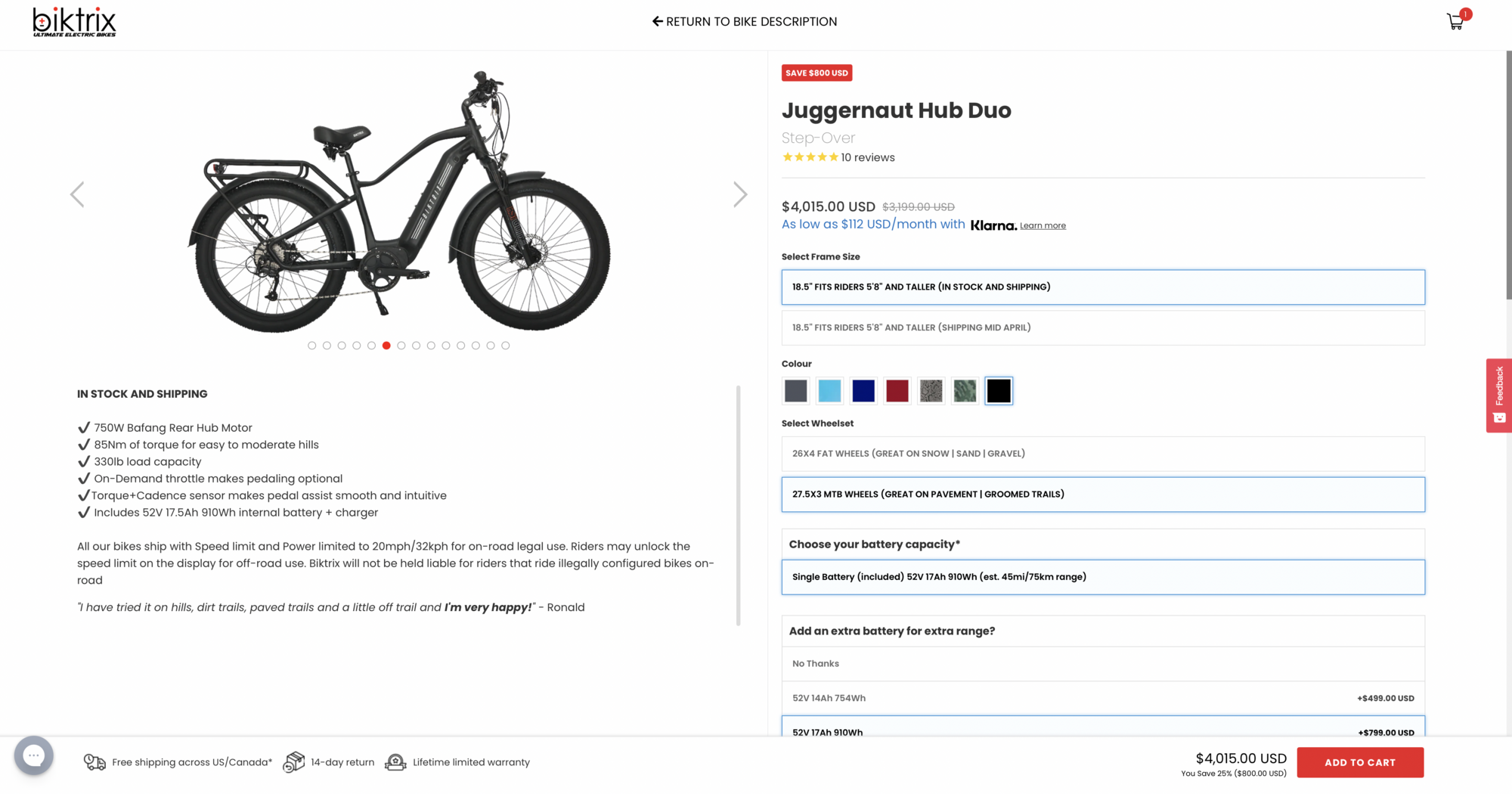

Hello,
I am a first time (to be) consumer of ebikes. I am searching for an ebike that I can use in place of my car in a city setting with moderate hills, but also venture on decently long countryside rides and easy trails. The daily commute will be on all pavement, but they are Pennsylvania roads, so there are a lot of bumps and potholes. This is a semi hilly area, so I will need some power helping me. I am in my mid 20s and in good shape, so I can do not need to solely rely on the throttle for hills by any means.
My ebike search has been looking like this:
NEED
  • Street & trail legal (<750w motor)
  • On Demand Throttle
  • at least 60-65nm torque
  • Removable battery
  • 750w motor
WOULD LIKE
  • 1+ suspension points
  • Semi-integrated battery
  • at least 80nm torque
  • integrated head/tail lights
  • it to not be obvious its an ebike (have massive battery packs on it). This is to lower possible theft, and to lower overall curiosity from police and other people trying to disturb a guy on his bike.
Range isn't really going to be an issue unless it is really, really poor. I plan on purchasing a second battery regardless.
With all of this being said, its clear I won't find this bike cheap. My idea limit is ~$6,000.... but I have put serious thought into the Jeep Quietkat bike at around $7,500.
My current frontrunner is the Juggernaut Hub Duo (attached picture) with all of the upgraded/added features. I'm also a fan of their customer service so far. I also the Sondors LX and Sondors Rockstar on my radar, but neither of them have the range of capabilities that the Juggernaut has in my opinion.
I was considering mid-drive bikes until someone made the point of if your chain snaps on a mid drive, you're out of luck, whereas if the chain snaps on your rear hub drive bike, you still have the electric direct motor, and vice versa.
If anyone has any insight that might be of any help, or wants to be my first ebike friend, let me know :^)

Juggernaught looks good with torque sensing and 17.5 ah battery. 52 v is a bit extreme. Most west coast vendors won't sell a hub motor with more than 36 v due to the possibility of burning up on a rise >1000'. No 1000' rises in Pennsylvania, but I'm riding a 48 v geared hub drive in hilly S. Indiana. Juggernaught doesn't show dimensions to see if it fits you. I'm a prime example of one size does not fit all - especially not me.
Other torque sensing hub drives are Smartmotion (reviews are 2016, may be dead) and possibly xtreme catalina (although that may have been only on the 2019 model).

GhettoWedo74
Hello,
NEED
  • Removable battery
  • 750w motor
WOULD LIKE
Look at a Fiido T1, & see if that suits your needs, it checks of the list most of the requirements your looking for.
I had mine for Uber a month & got over 1k miles already. Mind you, I was pretty much bedridden & gave up on life from fighting off Covid twice & almost dying, & being diagnosed with Long Term Covid as well, I was forced to stop working, & so this sent me into a terrible depression, UNTIL I got my e-Bike, I've been out riding everyday 30-60 miles(average range 45-75 miles on full charge) I've lost 22lbs, am walking way further now, because my lungs are getting stronger, as well is THE BEST "pill" to fight depression, well at least in my situation, can't believe getting an e-Bike would literally change a 47 yo mans life!👍
Fiido aftercare is top notch, which most e-Bike companies lack, once they get your money, it's near, if not impossible to get a message back to solve your issues.
I paid $1,579.00 out the door with no taxes added, with a code I found online, you can use code: GhettoWedo74 to save $20, plus pay no sales tax in the US, & I'm pretty sure the UK, if you pay with Paypal you'll save $50, but not sure if they stack, can't hurt to ask.
