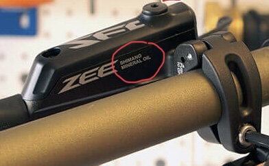

What about the brake oil? is there and specific type i should use?
Most hydraulic bicycle brakes use mineral oil. The brake reservoirs located on the handlebar usually specify what fluid should be used.
KidSess
i dind't see any specific brand of mineral oil. All i saw it was Tektro on the name of the brakes.

Thanks man, you gave me so much information that it took me a while to get things covered with the time. i do have to get a C9 seat as they say they are really comfortable and my commute is sometimes rough.
