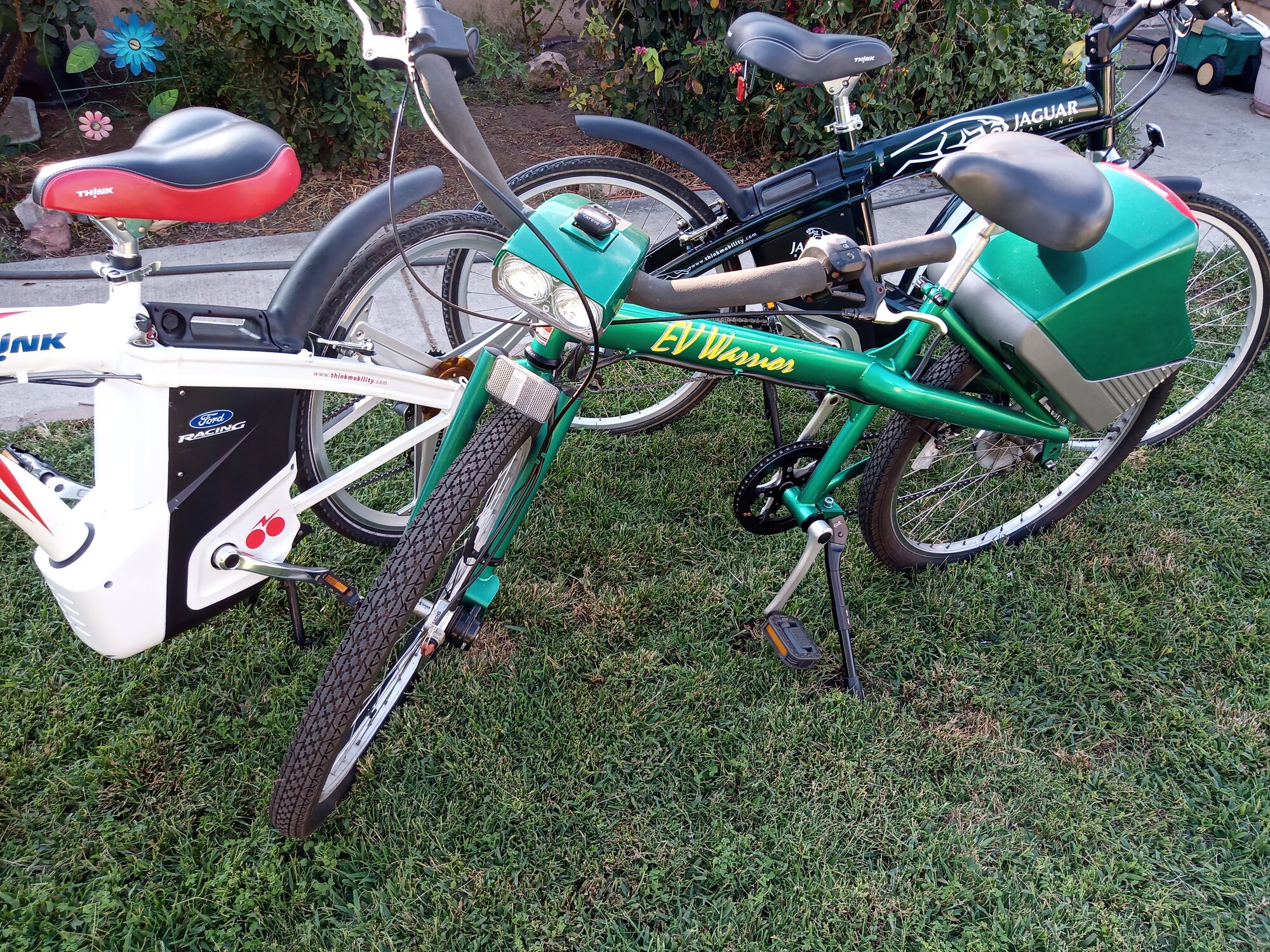

I just acquired two Think bikes - one Ford Motorsport edition and one Jaguar Racing edition.....anybody have some background info on these? The internet is not containing much info about these bikes in general, and nothing I could find in relation to these two special editions.....

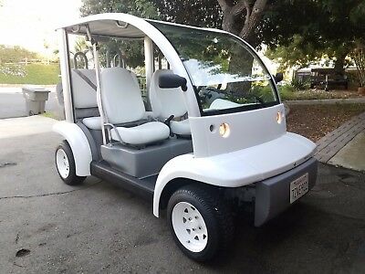

The Ford Th!nk programs 1991-2011, were sadly too early to be commercially viable. The Th!nk bikes were maybe circa 2000. The Th!nk NEV, I believe 2002-2007. Very minimalist and future-forward aesthetic with some front end water-proofing issues. They are somewhat collector in the NEV sector where they are now considered "antiques".

Had one at our business for years. Very nice little EV with crash safety features and street legal to 35mph. Still very popular with enthusiasts, some are even offering 'hot rodding' services (no real rods involved of course)!

I worked on a couple of the Ford Think ebikes maybe 7 years ago when I was volunteering at the local Bicycle Kitchen. A Ford exec had recently retired to our area and donated them. Apparently they were developed for the Asian market but the price point (>$1,000 some years ago) didn't match the market so it failed as a commercial product.
These 2 ebikes had stamped steel frames for high volume production, throttle controlled hub motor and SLA batteries wired in series to get 24V. The batteries were internal to the frame. As I recall the controller was integrated into the motor. The batteries were dead but after a general tune up, new brake pads and replacement lithium batteries they were ready to go. The batteries were from Ping Battery. At the time they said they were providing a number of lithium packs for the Think ebikes. They even offered an 'off menu' 24V pack mechanically configured to fit in the Think's battery compartment.
Apparently the controller partially relied on the higher internal resistance of the SLA batteries to help limit motor current. The very low internal resistance of the new lithium batteries made these bikes go like bats out of you know where. I put an inline watt meter on one of them. The motor would pull 900W in a 24V system, almost 38A! I was initially concerned about overheating, but it never happened. These little bikes were built like tanks, more or less...🤣

My think bikes are a bit different than the on you had. Mine are mid-drive with throttle and (somewhat) pedal assist. On both bikes the pedal assist is somewhat hit or miss, at least compared to my modern ebikes. They provide assist, but only for a few seconds, then they stop assisting, If I had one that did that I would say it is broken, but both do the identical thing so I'm guessing they were designed that way? Any guidance would be helpful.

Sorry, not familiar with that version of the THINK ebikes.

Very streamlined design... also love the Jaguar EBike paint in proper BRG! ;)
