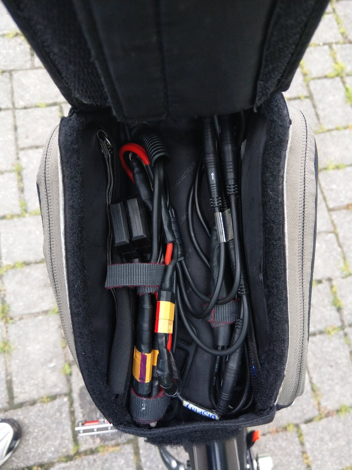

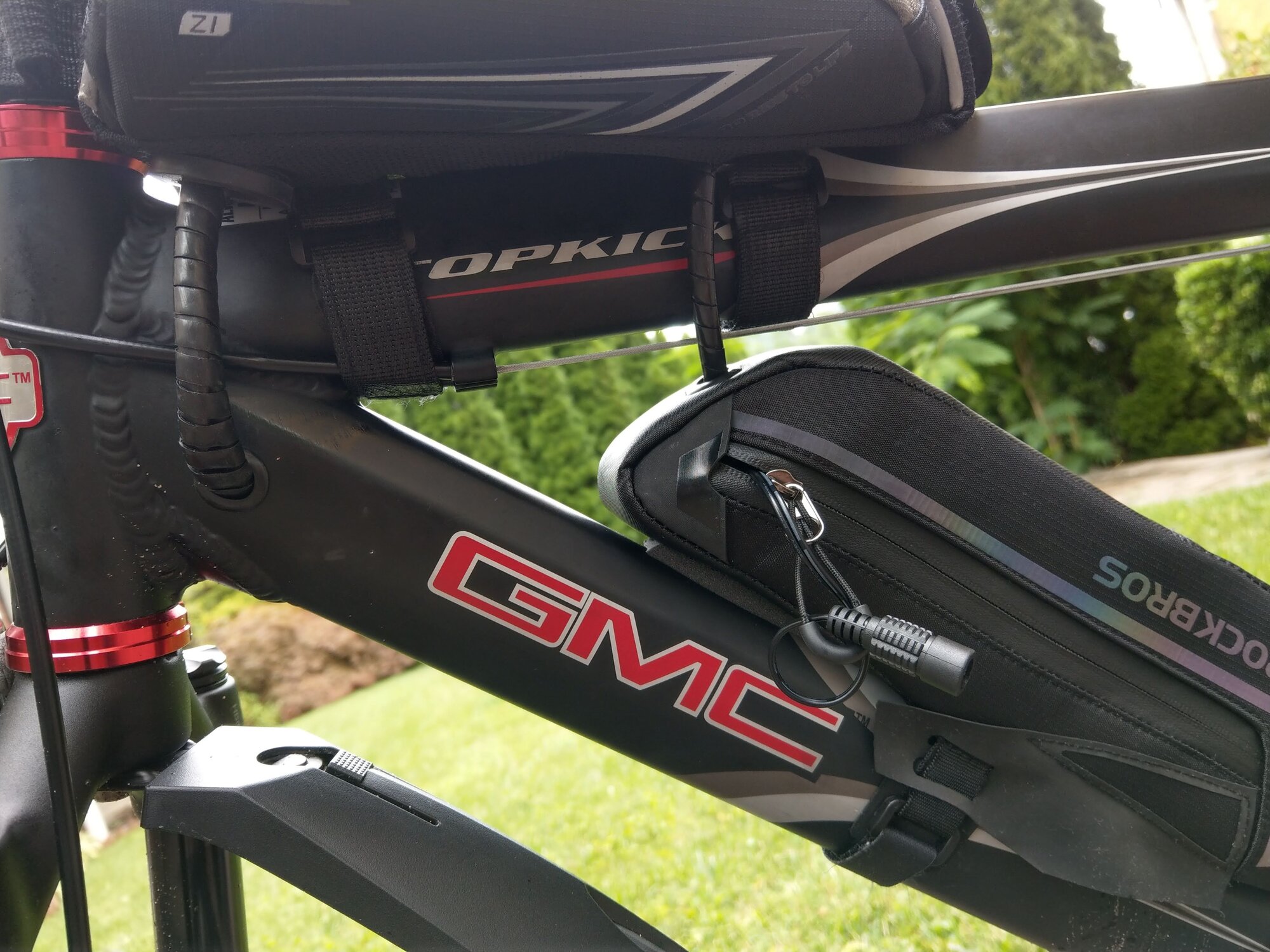

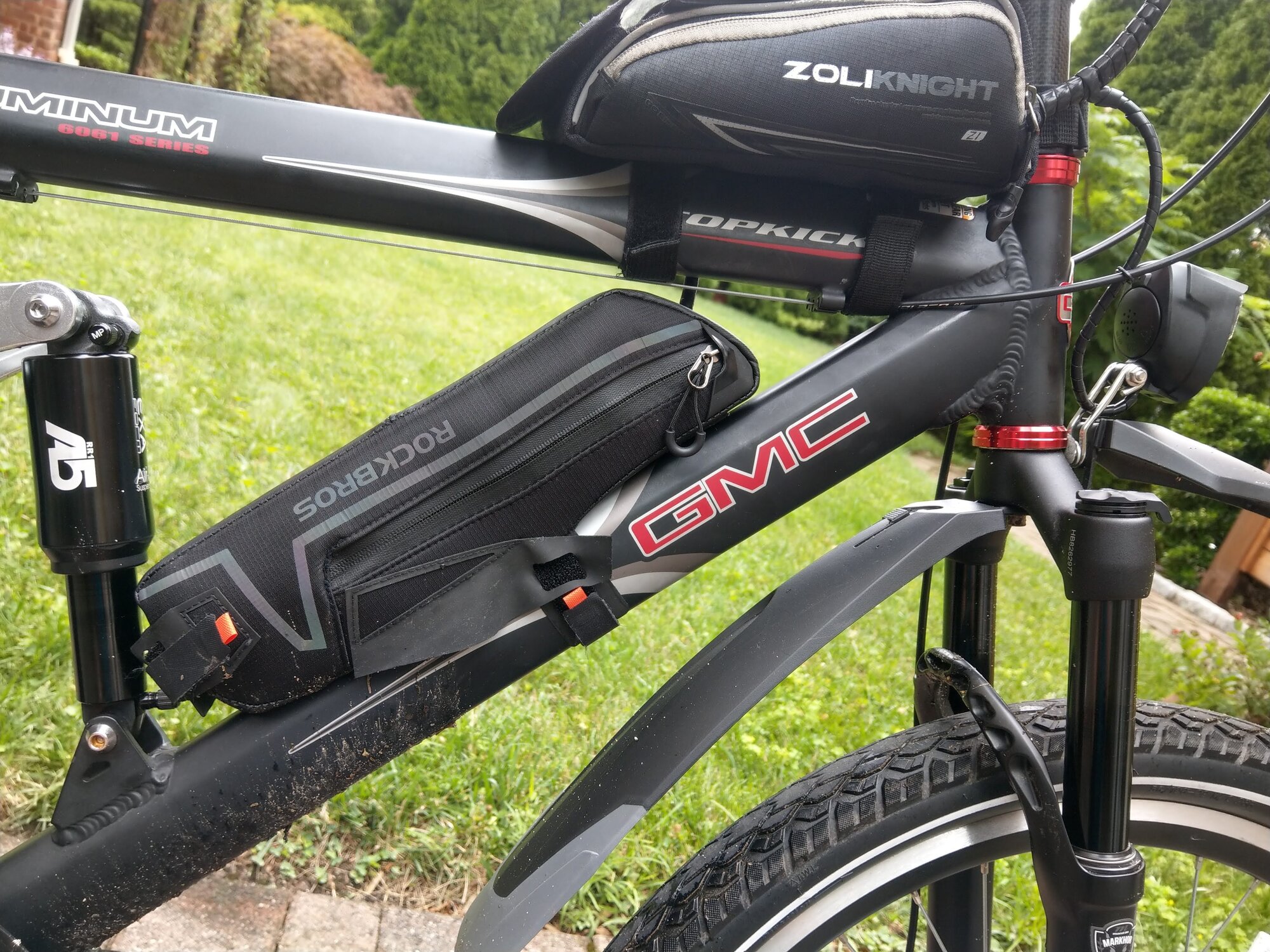

I don't think I've stumbled on anything novel here.... but I haven't seen anything posted taking this approach.
Recently I purchased a smaller battery that would fit in my very tight triangle and I needed a way to secure it and make it somewhat presentable. That along with following some of @PedalUma's very clean builds I was inspired... or should I say embarrassed into cleaning things up a bit.
So I purchased a frame bag slightly larger than the new 48v/10ah battery and installed it on the bottle mounts by fabricating a 2" W x 11"L x1/8" T piece of aluminum flat bar which attached with 2 fluted 5mm flat head screws that were countersunk to be flush with the top of the bar. The bar was wrapped in padding, slid it in the bag and bolted down. I put some additional padding over the screw heads, at the bottom of the bag and under the bag between it and the frame for good measure. I had cut grommets into the bag by heating up a gasket cutter die and letting it melt though so I'd have a means to pass wires. I did the same to my existing top frame bag that generally held my phone, wallet and keys and used it now to also hold 2 fuse holders, a diode and switch splice for my horn and light and all the bikes connectors.. throttle, brake and display. This still leaving plenty of room for my usual.
I like that the battery bag has a shallow compartment on the left side which I can tuck the charge connector in and that I can easily access my display connector for programming. I now even have a place to store or connect the programming cable for use with the new app and OTG dongle.
Not state of the art by any means.... but I like it 🙃

Nice build! Looks "professional" enough to me.
I may do something similar to house my power tool backup battery.
Thanks.
Not some of my best work... But as I get older and as my eyesight fails, things don't need to be as pretty 🙃
Probably should have gone for a new top rail bag for this project as my existing one is a few years old and pretty tattered. The cheap battery Rockbros bags is built rather well and is water resistant so it should provide enough protection for the battery.
That's right... I remember your tool battery posts... How'd it work out?

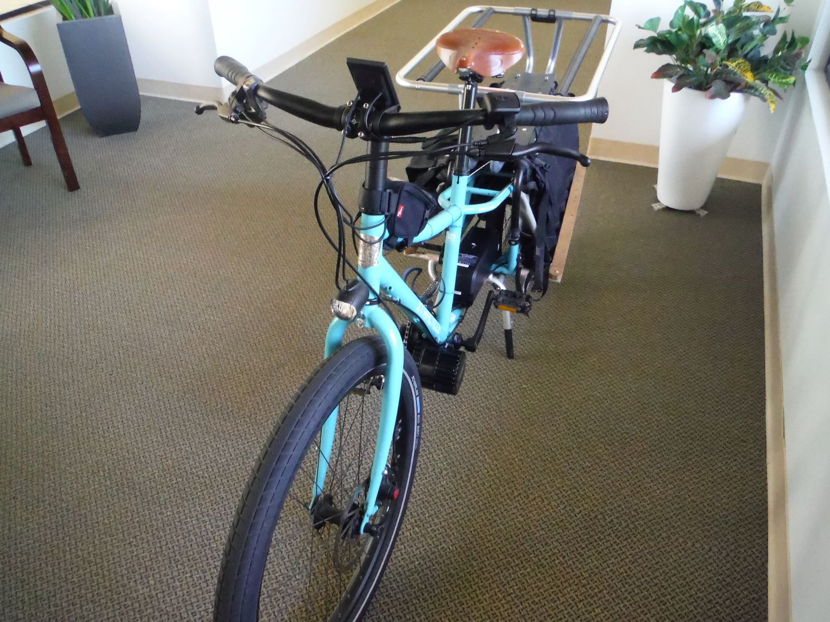

Here is that HD cargo build where I tucked the connectors into a phone sack.
Zoom to see the painted zip ties and the HD motor.

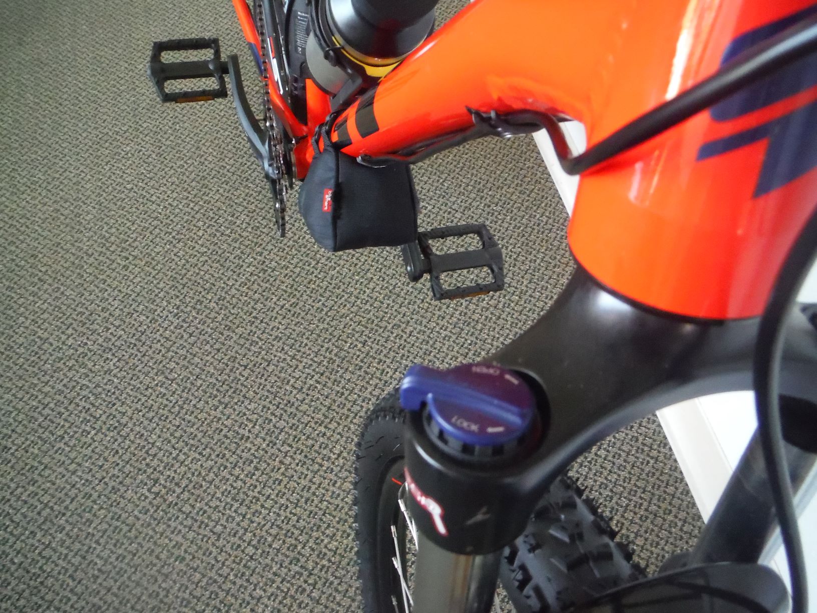

The guy with the red GT said he wanted a rear hub so I did it. I put the controller and the extra wires and connectors into one of those phone sacks. He can wash it after his chamois 🤣 because it is right where muck would fly from the front wheel.
He took it to Tahoe and had me make it into a mid-drive the next week.

Nice job! What battery did you get?
Thanks.
I've only had the battery for about 2 weeks so I wouldn't recommend it just yet as it is very low cost and by an off brand. But at this price point I figured it was at least good for test to see if the weight and center of gravity change is worth spending on a custom build with better known cells. My old battery was a 17.5ah on my rear rack with Samsung cells.
That said so far its been a win-win with the change in the bikes balance being appreciated and the battery power output has been more than adequate. It's only 3p compared to 5p so there is a bit more voltage sag under load, but not enough to affect performance for the way I ride.
For comparison under 8a load my old battery would drop 1v -1.5v and this one drops 1.5v - 2v. On a typical 18.5 mi ride I'd use about 2.5v on my old battery and this one drops 4v. In all its not doing bad at all and on par for its size.
If you Google the manufacturer or check their main page on Ali... They seem to be established in China.
But again, it's only 2 weeks old and could crap out at any moment 🤣 ... But if I get the summer out of it I'd be content.

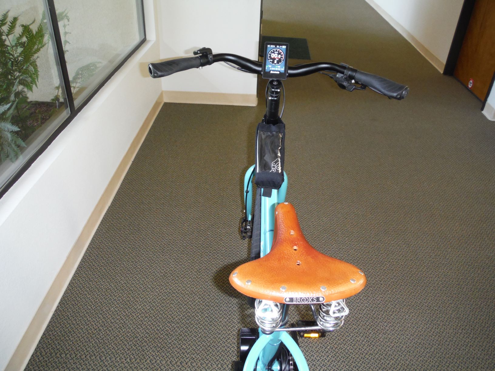

The through frame wiring is sweet! Zoom photo #4 in the opening of this thread.
When I have tried to just push it the wiring jams.
Did you pull it? I have used an old shifter cable to do this with heat shrink tube to temporarily join at the connector and nob on the end of the cable. The cable feeds in nicely. Then just pull it along. Far better than a jam.
Gionnirocket
Y. O.
I used an electrician fish tape to get from hole to hole and pulled some nylon twine through, then used the twine to pull the wires.
To get the grommets and wire to play nice and sit where I wanted, I coax'd them with a little silicone lubricant.
