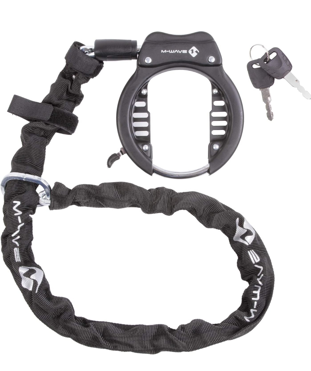

and would like to install a frame lock (café style) something like the lock in the picture below.
Any suggestions of a model frame lock that will fit in this bike?
Thanks!

I thought I read somewhere the 5750L NR which was 78mm opening would also work? I've got one on order and will attempt to follow up when it does arrive. I tried to order the model that Guru posted, but I couldn't find it easily....I was too lazy to email abus however.
gpburdell
Any preference for one model of lock over another? (If so why?)
I can see there is a hole for a chain to be added. Do you know if any ABUS chain work? Or do I have to order a specific one?
Thanks!
I chose the 5755L because it is smaller than the 4750X - see the technical drawings on the Abus website(s) - and that the 5755L uses the higher tier Xplus cylinder / key while I believe the 4750X is just the Plus cylinder.
AFAIK the chains are cross compatible.
Tintin
Super! Those were the thoughts I had when looking at the photos and the specs of the locks.
Thanks so much!

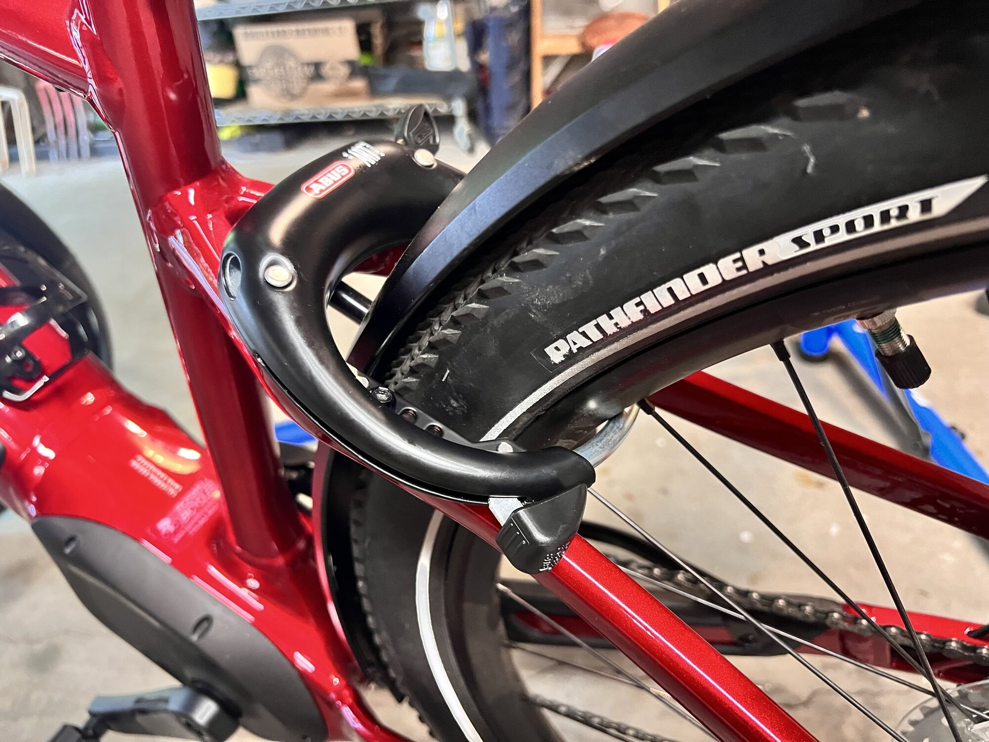

I got the Abus 5750 - Large.
It fits and works well on my 2022 Turbo Vado 4.0
I chose it as, based on reviews at the time, it's was the one that I was most confident would fit/work
