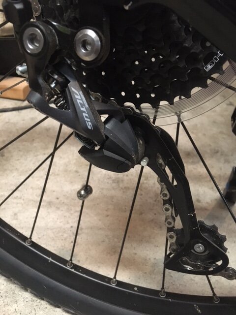

I own Roam E+, some points I agree but disappointingly my bike came with a number of flaws which I think are assembly issues (not sure if these are factory assembled or dealer) which potentially caused all my other headaches (5 flats in 1 and half month of ownership).
If I had to do it again, I might be forced to find another brand simply because the Giant dealer service has been very disappointing, well below my expectation. There are only two Giant dealers in my area and I was told both are owned by the same owner. That said, Giant Canada's response to request is simply *talk to your dealer* so they are not very helpful either.
In short, my Roam E+ is in a relatively decent shape now after 2 months but with scars all over the bike. I do enjoy the e-bike part of it very much though, and just like others RideControl One hasn't been an issue for me. My phone app provides additional details if I want, and recently got Garmin Edge 530 which compliments this bike very well. Fingers crossed the bike runs with no more issues at least until the warranty period runs out since the last thing I want to do is to look for Giant service for help.

By the way, one inaccuracy in the original post - Deore drivetrain. Roam E+ comes with Alivio, one level down from Deore, so is the Explore E+ 2021. If you want Deore, you need to move up to Explore E+ pro. I believe the Deore comes with clutch, and I think all their 1x setup should come with Deore. The clutch derailluer should minimize chance of the chain drops.
My 2021 Roam e+ is 1x9 and came with a Shimano Altus rear derailer. Anyone know if the Deore rear deraileur is a straight swap out using existing rear cassette and shifters? Or will it only work as a matched system? (Based on these reviews/questions on Amazon it looks like it is doable just fine, btw. Anyone have any experience to the contrary, or on this particular bike, that says otherwise?? ).
Is there any good reason to upgrade this to a 9 speed Deore? I have the 2019 Explore 3+, and it came with the 9 spd Deore
Deore I believe has clutch mechanism which maintains tension better which should help with those situations where I saw chain drops on my Roam e+. I ended up installing chain guard to fix the chain drop issue which was happening almost everyday.
I initially had this problem as welL on my Explore, but then it seems to fix the problem after I play around the the B-Screw, and also I believed I removed an extra link when I replaced my chain.
this is the bike i have https://www.giant-bicycles.com/ca/explore-eplus-3-gts-2019, not sure if it comes with the clutch tbh.
hmm.. looks like it does not, and still suffers from the same issue. I was tempted to remove a link from the chain but the service advisor was against it. Anyway, this was quite unexpected and really bothersome issue to have.
Ya, i recalled the chain would fall off the crank, so i had to carry a couple plastic gloves with me at all time. I also went through 2 chains in less than 3 yrs (around 3.5k km, i m on my 3rd chain now)
so far the fall off issue seem to have been resolved, knock on wood. Let see what happens when my riding season starts
I was doing the same, but frequent occurrences really started to get annoying. Honestly, this is not acceptable for a bike at this price range. I've never had this issue on other bikes I owned but this was the first bike with 1x9 drivetrain - meaning no derailleurs on the front.
I do see that their newer bikes have front chain guide, possibly due to this issue.
