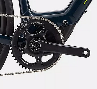

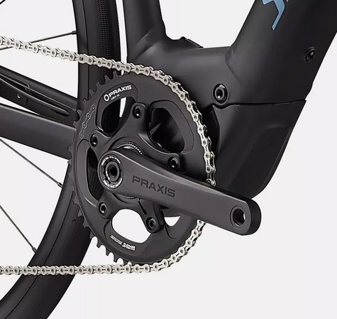

Crank/Chainring on my Aluminum Creo, although my Chainring does not have a visible icon showing chain alignment vis a vis chainring teeth!
